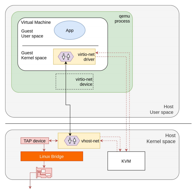

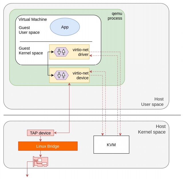

And it's absolutelly logic that this causes a bad performance for the "virtio-net" setting as QEMU then creates an additional "virtio-net device":
https://www.usenix.org/sites/default/files/conference/protected-files/srecon20americas_slides_krosnov.pdf
Instead of sharing the memory with the host:
A good write-up can be found here:
https://insujang.github.io/2021-03-15/virtio-and-vhost-architecture-part-2/

And it's absolutelly logic that this causes a bad performance as QEMU then creates an internal "virtio-net device":
