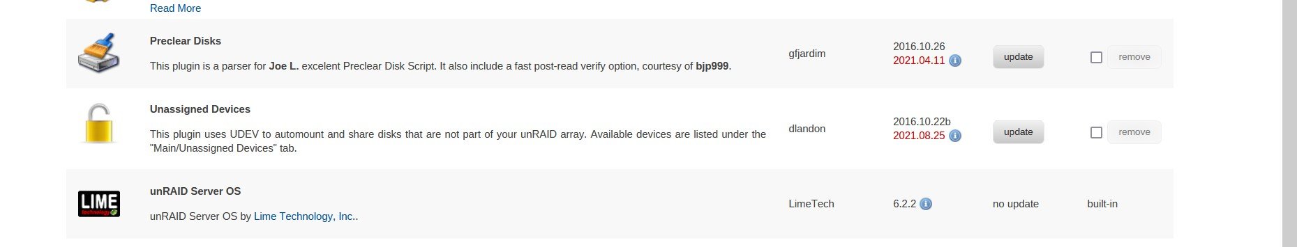

I'm on 6.2.2, when I 'check for updates' on the plugins page no update is available for unRaid OS, what am I doing wrong?(besides not updating earlier🤔)
Ok, once I read the first post properly(its like a test really isn't it....read the friggin question!), anyway, it's installed and seems to be running fine, only it hasn't asked me to set a root password and all my shares are exported, yet according to the bottom paragraph from the first post, thats not what should happen.

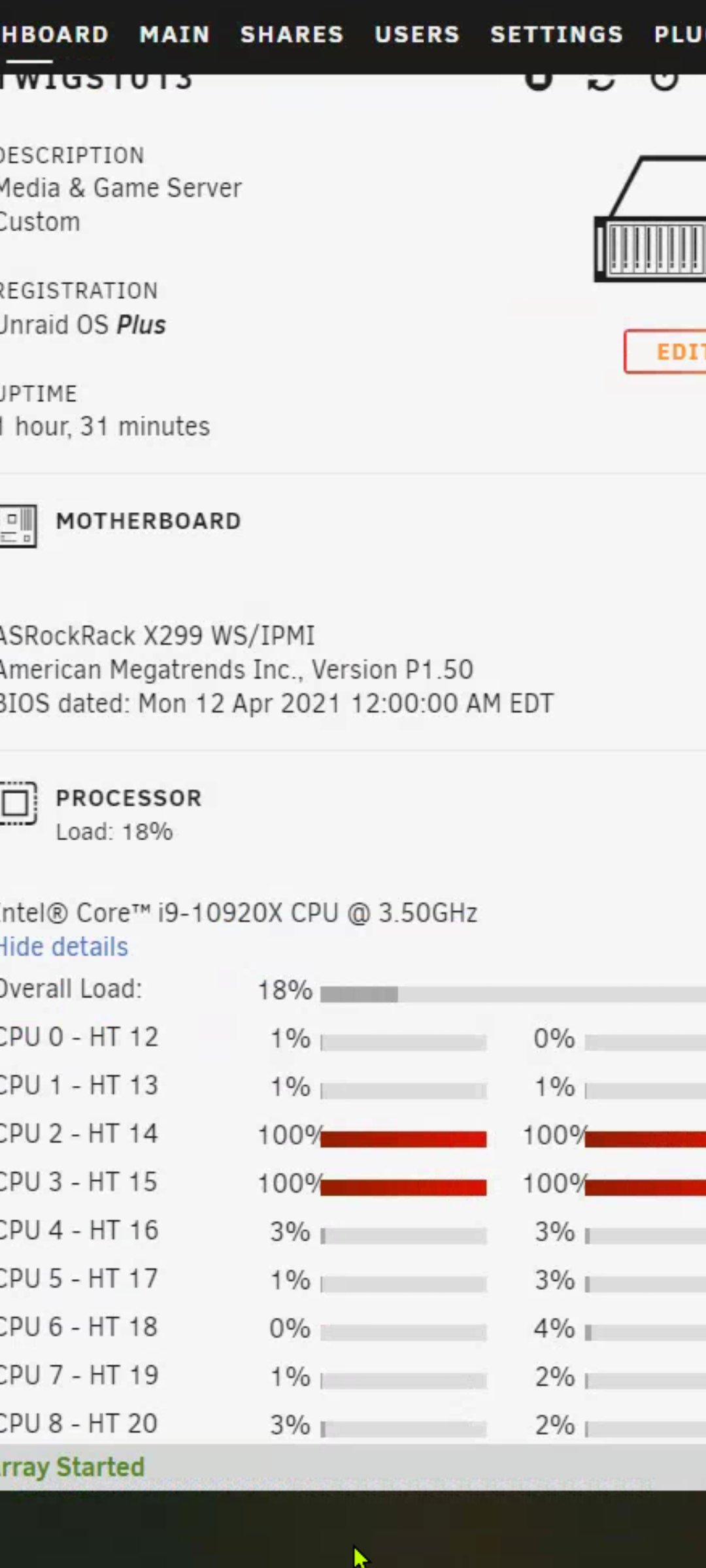

Upgraded to 6.9.2 and noticed my Windows VMs, Linux is fine, despite gpu pass through, operate very sluggishly.
The CPUs pinned also run at high cores. They are fine at idle.
I'm not sure what could be causing it.
I also created a new VM with no luck.Swapped hardware and experience the same issue.
Anyone else experience this?
Since this is a Release Announcement thread, you mightl have a better chance of getting help if you raise a new thread in either the General Issues or KVM forums.

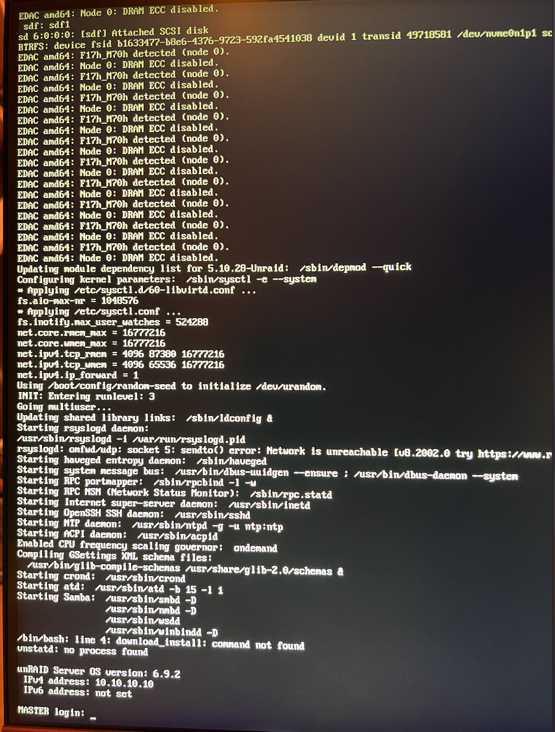

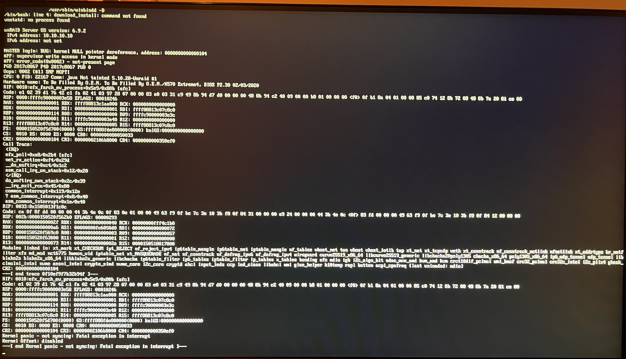

So - finally I have some pictures of what's going on during boot.
One picture is immediately after booting with 6.9.2.
No GUI . .
Next picture is 5 seconds later.
root@MASTER:~# docker network ls
NETWORK ID          NAME                DRIVER              SCOPE
16dae0b9cb06        br0                 macvlan             local
3865e5074cdb        bridge              bridge              local
b4a5e3d425e4        host                host                local
e78cd5f82a47        none                null                local
b8031a6cf9ca        proxynet            bridge              local
