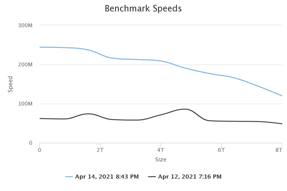

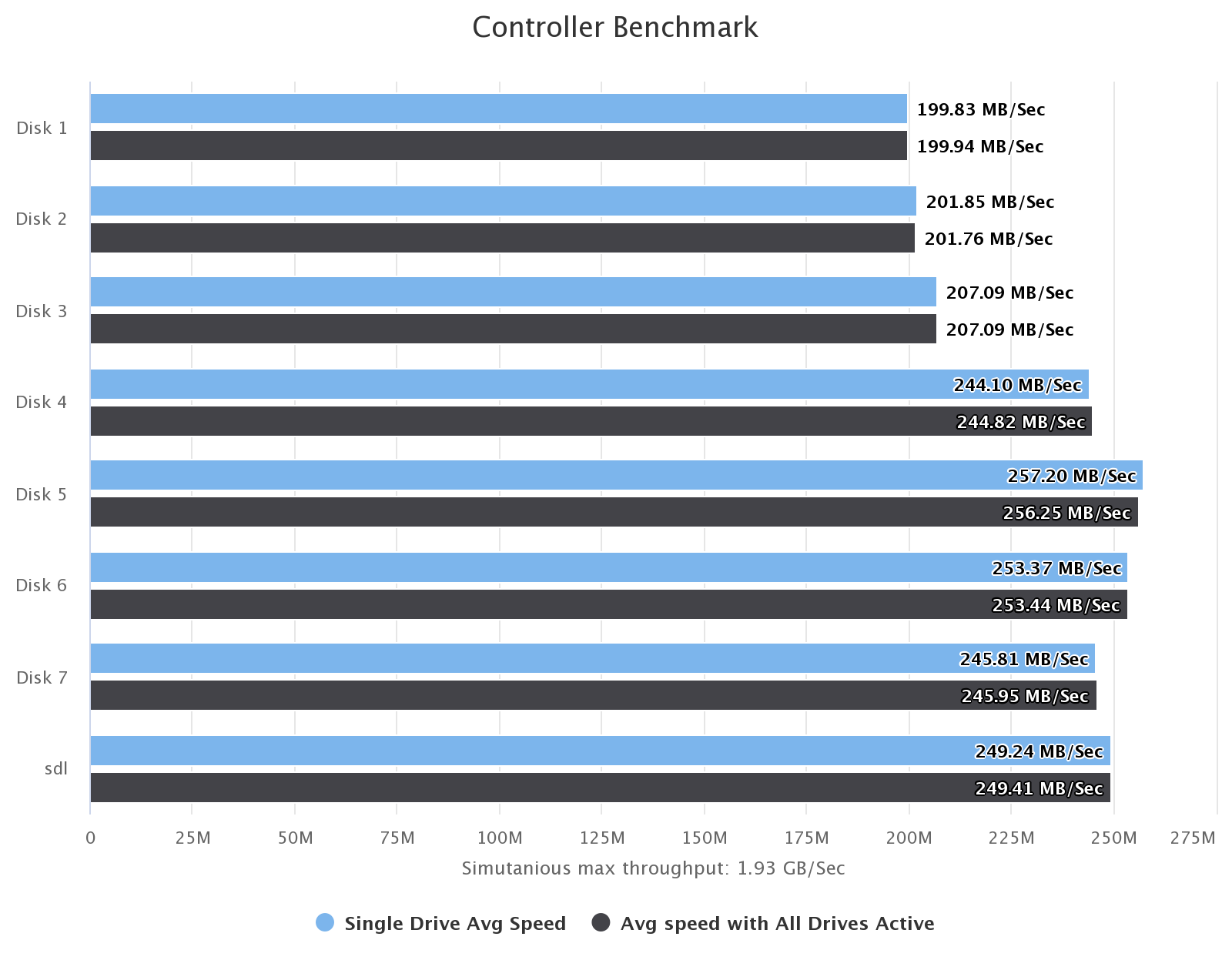

On 4/15/2021 at 3:56 PM, ken-ji said:
Well I had a parity check run then and the speeds got capped to the slow 60MBs so its not the DiskSpeed-Docker's fault I think.
My DiskSpeed app uses the dd utility to read the drive for 15 seconds for each drive on the controller in succession, then the same command against each drive all at once. To get slower speeds during single-drive reads vs multiple drive concurrent reads is weird. I'd have to say that it's not my app but my app is showing the issue at hand.

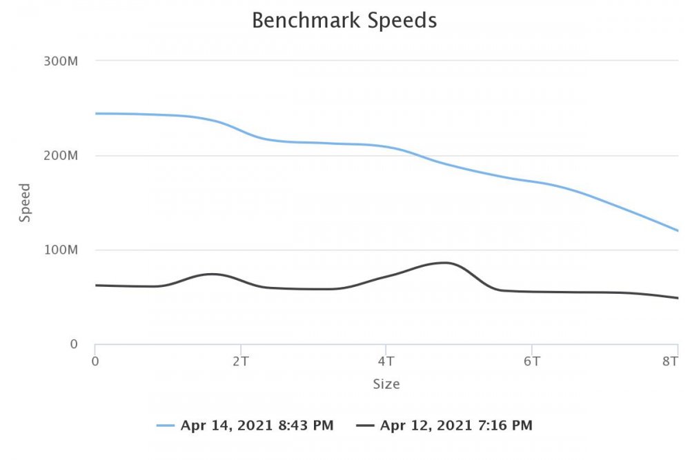

On 4/15/2021 at 8:46 PM, ken-ji said:
I'm wondering if anybody with an LSI card using the mpt3sas driver has noticed any speed issues?
I'm using a LSI SAS9206-16E HBA and its dual linked to an expander / enclosure - ARC-4036
I've had this setup for a long while now and I've always gotten the maximum speed out of all my HDDs from it.
But when I upgraded to 6.9.2 this weekend, half of my drives on the HBA started running at 60MBs only compared to the usual ~200MBs
When I reverted back to 6.9.1 the drives all ran at their max speed
When I have time, I'll try to upgrade again and see if the problem occurs again
I don't have the all drives benchmark in 6.9.2 which gives really weird results.
^ This is Disk 5 (black is 6.9.2)
Ok. now that I have time to try upgrading again. I did and the problem has gone away.
The one thing I did though beforehand was to finally flash my controller to P40 so maybe that was it.
