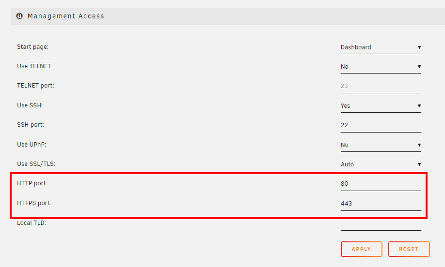

25 minutes ago, ikiwi said:
Nginx did not start after update. SSH is available, all dockers seems to be up and available, but no web interface.
nginx: [emerg] invalid port in "*:98080" of the "listen" directive in /etc/nginx/conf.d/emhttp-servers.conf:37
Make sure you have valid ports configured.
See also /config/ident.cfg on your flash device
PORT="80"
PORTSSL="443"
Edited by bonienl

They were configured properly on 6.9.1 :)
But now i can't check it anyway as webgui is not available
PORT="80"
PORTSSL="443"
/boot/config/ident.cfg                                                                                                     664/664               100%
NAME="unraid"
timeZone="Europe/Moscow"
COMMENT="Media server"
SECURITY="user"
WORKGROUP="WORKGROUP"
DOMAIN=""
DOMAIN_SHORT=""
hideDotFiles="no"
localMaster="yes"
enableFruit="no"
USE_NETBIOS="yes"
USE_WSD="yes"
WSD_OPT=""
USE_NTP="yes"
NTP_SERVER1="time1.google.com"
NTP_SERVER2="time2.google.com"
NTP_SERVER3="time3.google.com"
NTP_SERVER4="time4.google.com"
DOMAIN_LOGIN="Administrator"
DOMAIN_PASSWD=""
SYS_MODEL="Custom"
SYS_ARRAY_SLOTS="24"
USE_SSL="auto"
PORT="80"
PORTSSL="443"
LOCAL_TLD="local"
BIND_MGT="no"
USE_TELNET="no"
PORTTELNET="23"
USE_SSH="yes"
PORTSSH="22"
USE_UPNP="no"
START_PAGE="Main"
Ok, second reboot and /etc/rc.d/rc.nginx restart did the trick, now everything seems to be ok except unplanned parity check
