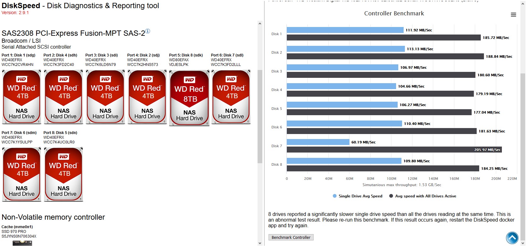

I'm wondering if anybody with an LSI card using the mpt3sas driver has noticed any speed issues?
I'm using a LSI SAS9206-16E HBA and its dual linked to an expander / enclosure - ARC-4036
I've had this setup for a long while now and I've always gotten the maximum speed out of all my HDDs from it.
But when I upgraded to 6.9.2 this weekend, half of my drives on the HBA started running at 60MBs only compared to the usual ~200MBs
When I reverted back to 6.9.1 the drives all ran at their max speed
When I have time, I'll try to upgrade again and see if the problem occurs again
I don't have the all drives benchmark in 6.9.2 which gives really weird results.
^ This is Disk 5 (black is 6.9.2)
Yep - there is something wrong... or the DiskSpeed-Docker needs an upgrade...
Edited by Zonediver
Well I had a parity check run then and the speeds got capped to the slow 60MBs so its not the DiskSpeed-Docker's fault I think.
