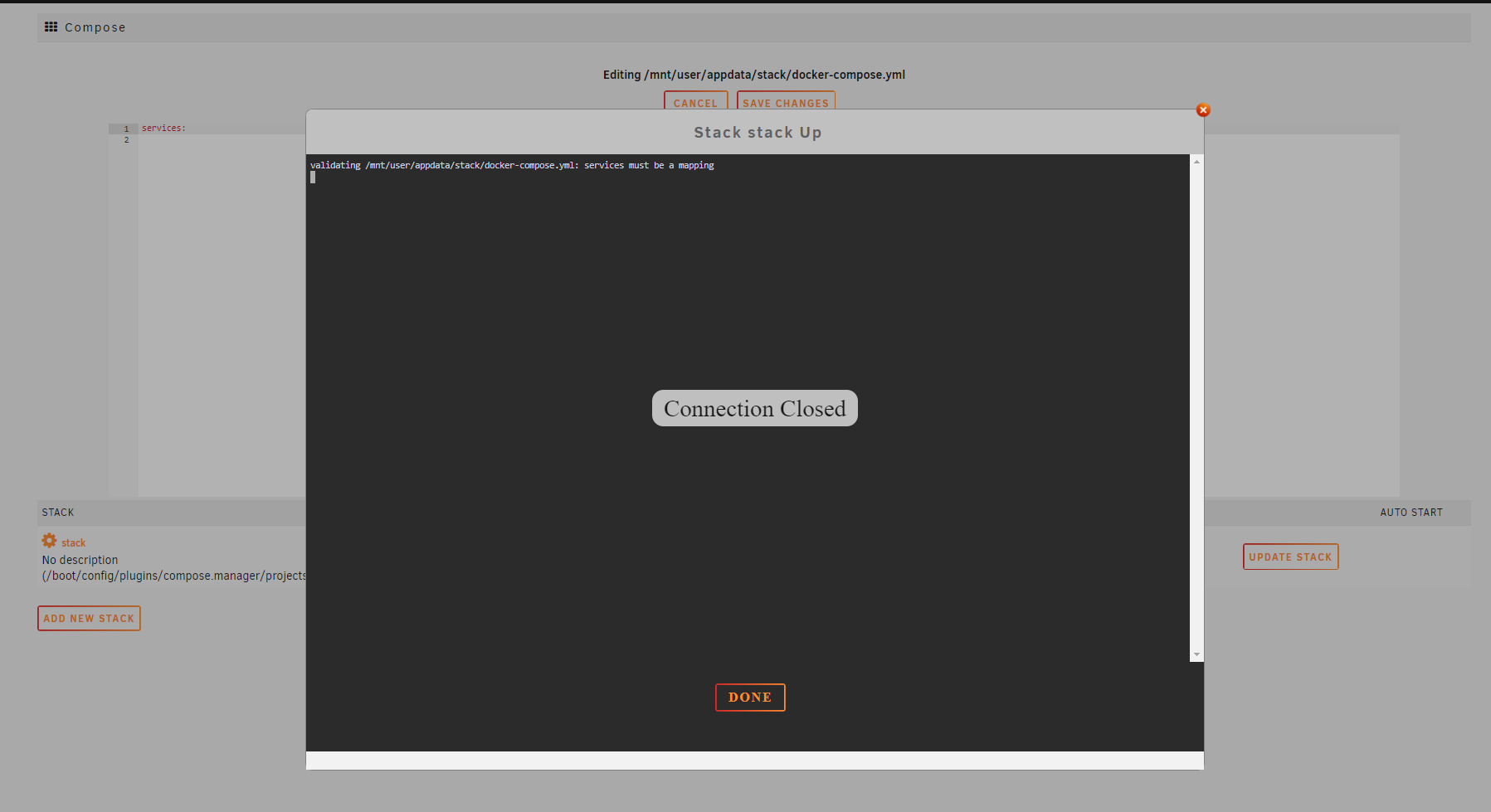

sunwind Posted October 18, 2023 Share Posted October 18, 2023 do I need to edit the yml file or something? so confused on how this works. Quote Link to comment
primeval_god Posted October 18, 2023 Author Share Posted October 18, 2023 12 hours ago, sunwind said: do I need to edit the yml file or something? so confused on how this works. It looks like you have a stack with an empty yml file. You would need to add something to it if you expect it to do anything. Quote Link to comment

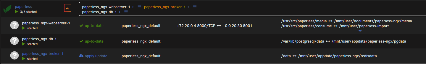

JudMeherg Posted October 24, 2023 Share Posted October 24, 2023 14 hours ago, Kilrah said: The containers created by compose will be on the Docker page, see what it's called and use that name. Thank you for the reply! I had tried your suggestion, maybe I should have added more information. Here are the results of docker compose ls root@Tower:~# docker compose ls NAME STATUS CONFIG FILES immich running(8) /boot/config/plugins/compose.manager/projects/immich/docker-compose.yml,/boot/config/plugins/compose.manager/projects/immich/docker-compose.override.yml paperless_ngx running(3) /boot/config/plugins/compose.manager/projects/paperless-ngx/docker-compose.yml,/boot/config/plugins/compose.manager/projects/paperless-ngx/docker-compose.override.yml This is a screenshot of the stack folder: And here are a few more ways I have tried to run the command: root@Tower:~# docker compose -f '/boot/config/plugins/compose.manager/projects/paperless-ngx/docker-compose.yml' exec -T paperless_ngx-webserver-1 document_exporter /mnt/user/backup/paperless-ng service "paperless_ngx-webserver-1" is not running root@Tower:~# docker compose -f '/boot/config/plugins/compose.manager/projects/paperless-ngx/docker-compose.yml' exec -T webserver-1 document_expo rter /mnt/user/backup/paperless-ng service "webserver-1" is not running root@Tower:~# docker compose exec -T paperless_ngx-webserver-1 document_exporter /mnt/user/backup/paperless-ng no configuration file provided: not found Here is my compose file: Spoiler # docker-compose file for running paperless from the Docker Hub. # This file contains everything paperless needs to run. # Paperless supports amd64, arm and arm64 hardware. # # All compose files of paperless configure paperless in the following way: # # - Paperless is (re)started on system boot, if it was running before shutdown. # - Docker volumes for storing data are managed by Docker. # - Folders for importing and exporting files are created in the same directory # as this file and mounted to the correct folders inside the container. # - Paperless listens on port 8000. # # In addition to that, this docker-compose file adds the following optional # configurations: # # - Instead of SQLite (default), PostgreSQL is used as the database server. # # To install and update paperless with this file, do the following: # # - Copy this file as 'docker-compose.yml' and the files 'docker-compose.env' # and '.env' into a folder. # - Run 'docker-compose pull'. # - Run 'docker-compose run --rm webserver createsuperuser' to create a user. # - Run 'docker-compose up -d'. # # For more extensive installation and update instructions, refer to the # documentation. version: "3.4" services: broker: image: docker.io/library/redis:7 restart: unless-stopped volumes: - /mnt/user/appdata/paperless-ngx/redisdata:/data db: image: docker.io/library/postgres:13 restart: unless-stopped volumes: - /mnt/user/appdata/paperless-ngx/pgdata:/var/lib/postgresql/data environment: POSTGRES_DB: paperless POSTGRES_USER: paperless POSTGRES_PASSWORD: paperless webserver: image: ghcr.io/paperless-ngx/paperless-ngx:latest restart: unless-stopped depends_on: - db - broker ports: - 8001:8000 healthcheck: test: ["CMD", "curl", "-fs", "-S", "--max-time", "2", "http://localhost:8000"] interval: 30s timeout: 10s retries: 5 volumes: - /mnt/user/appdata/paperless-ngx/data:/usr/src/paperless/data - /mnt/user/documents/paperless-ngx/media:/usr/src/paperless/media - /mnt/user/documents/paperless-ngx/export:/usr/src/paperless/export - /mnt/user/paperless-import:/usr/src/paperless/consume environment: PAPERLESS_REDIS: redis://broker:6379 PAPERLESS_DBHOST: db # The UID and GID of the user used to run paperless in the container. Set this # to your UID and GID on the host so that you have write access to the # consumption directory. USERMAP_UID: 1000 USERMAP_GID: 100 volumes: data: media: pgdata: redisdata: I am still not sure what I am missing. Quote Link to comment
Jarik Posted October 24, 2023 Share Posted October 24, 2023 (edited) 6 hours ago, JudMeherg said: I am still not sure what I am missing. If you use docker compose to call your containers than you should use service's names instead of container's names from the docker-compose.yml file. In your case: docker compose -f '/boot/config/plugins/compose.manager/projects/paperless-ngx/docker-compose.yml' exec -T webserver document_exporter /mnt/user/backup/paperless-ng or simple use docker directly with the name of your container: docker exec -it paperless_ngx-webserver-1 document_exporter /mnt/user/backup/paperless-ng Edited October 24, 2023 by Jarik 1 Quote Link to comment
Kilrah Posted October 24, 2023 Share Posted October 24, 2023 (edited) Also since that command is executed in the container then the path to backup needs to be a container path. /mnt/user/backup/paperless-ng doesn't exist in the container, you'd need to add a mapping from that to whatever folder in the webserver container, then reference the container folder in the command. Or use one of the existing locations, seems in your old setup that's what the "export" one was used for. Edited October 24, 2023 by Kilrah 1 Quote Link to comment
JudMeherg Posted October 24, 2023 Share Posted October 24, 2023 16 hours ago, Jarik said: docker exec -it paperless_ngx-webserver-1 document_exporter /mnt/user/backup/paperless-ng For some reason "docker exec -it paperless_ngx-webserver-1 document_exporter ../export". I guess the -i flag made all the difference. 13 hours ago, Kilrah said: Also since that command is executed in the container then the path to backup needs to be a container path. /mnt/user/backup/paperless-ng doesn't exist in the container, you'd need to add a mapping from that to whatever folder in the webserver container, then reference the container folder in the command. Or use one of the existing locations, seems in your old setup that's what the "export" one was used for. Thank you for pointing this point! You are right it should point to the export folder mounted inside the container. Quote Link to comment

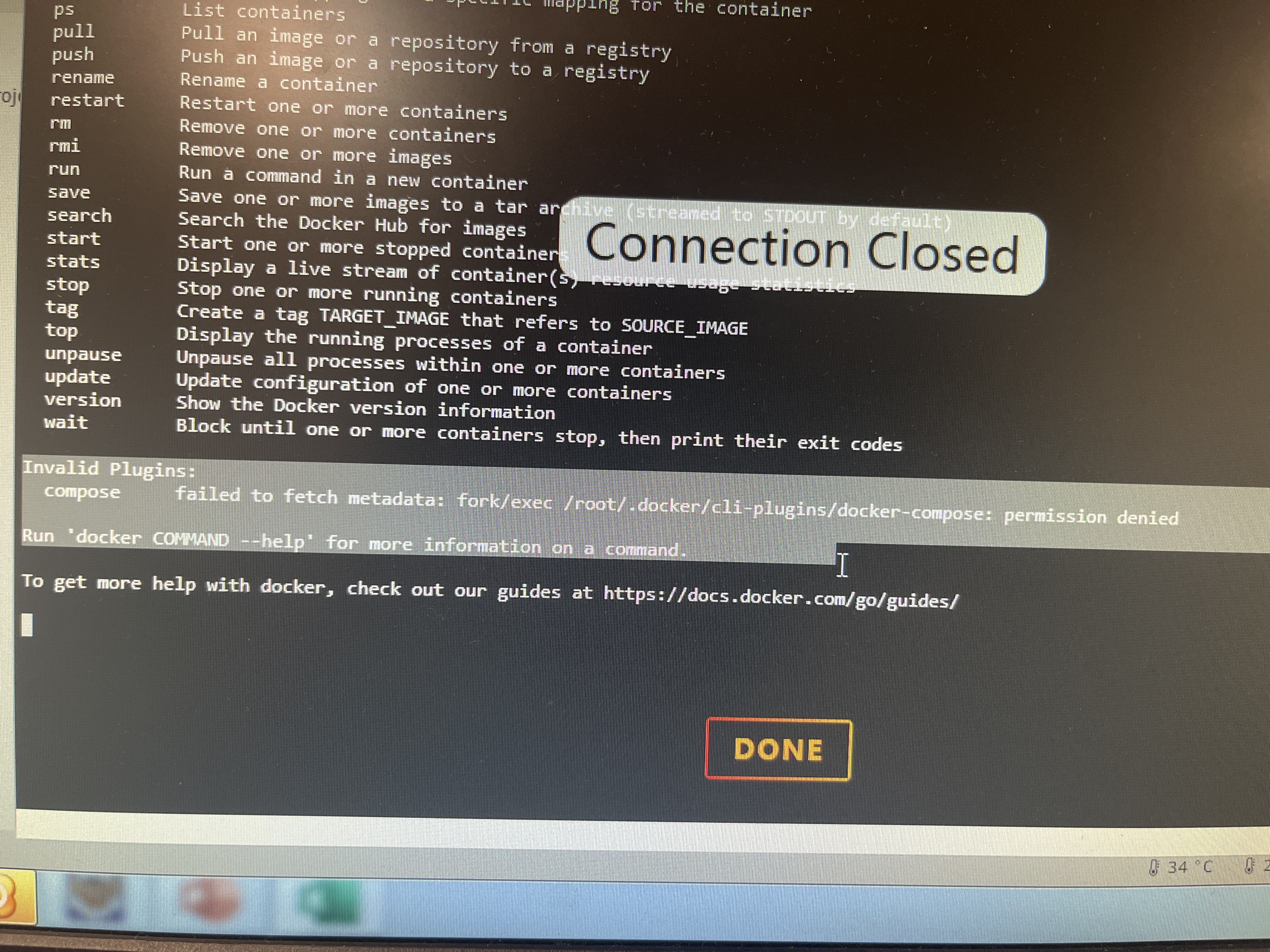

Droppisalt Posted November 4, 2023 Share Posted November 4, 2023 (edited) Trying to "compose up" my docker-compose.yml and getting this error: unknown shorthand flag: 'f' in -f EDIT: also getting this error. Not sure what's up with my permissions: Invalid Plugins: compose failed to fetch metadata: fork/exec /root/.docker/cli-plugins/docker-compose: permission denied Any clue on what is going on? Edited November 4, 2023 by Droppisalt Quote Link to comment

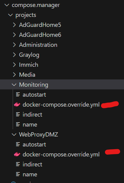

L0rdRaiden Posted December 4, 2023 Share Posted December 4, 2023 (edited) @primeval_god If I add my the "compose manager" labels to my docker compose file, should I delete the docker-compose.override.yml? is there a way to override this file and use exclusively whatever I set in the compose label? I see in some cases inconsistencies where the content of this file does not match the labels defined for it in docker compose. I am using labels like this lables: - "com.centurylinklabs.watchtower.enable=true" - "net.unraid.docker.managed=composeman" - "net.unraid.docker.shell=sh" - "net.unraid.docker.icon=https://raw.githubusercontent.com/ibracorp/unraid-templates/master/icons/traefik.png" - "net.unraid.docker.webui=https://traefik.dsaasddsa.com.es/dashboard/#/" Edited December 4, 2023 by L0rdRaiden Quote Link to comment
