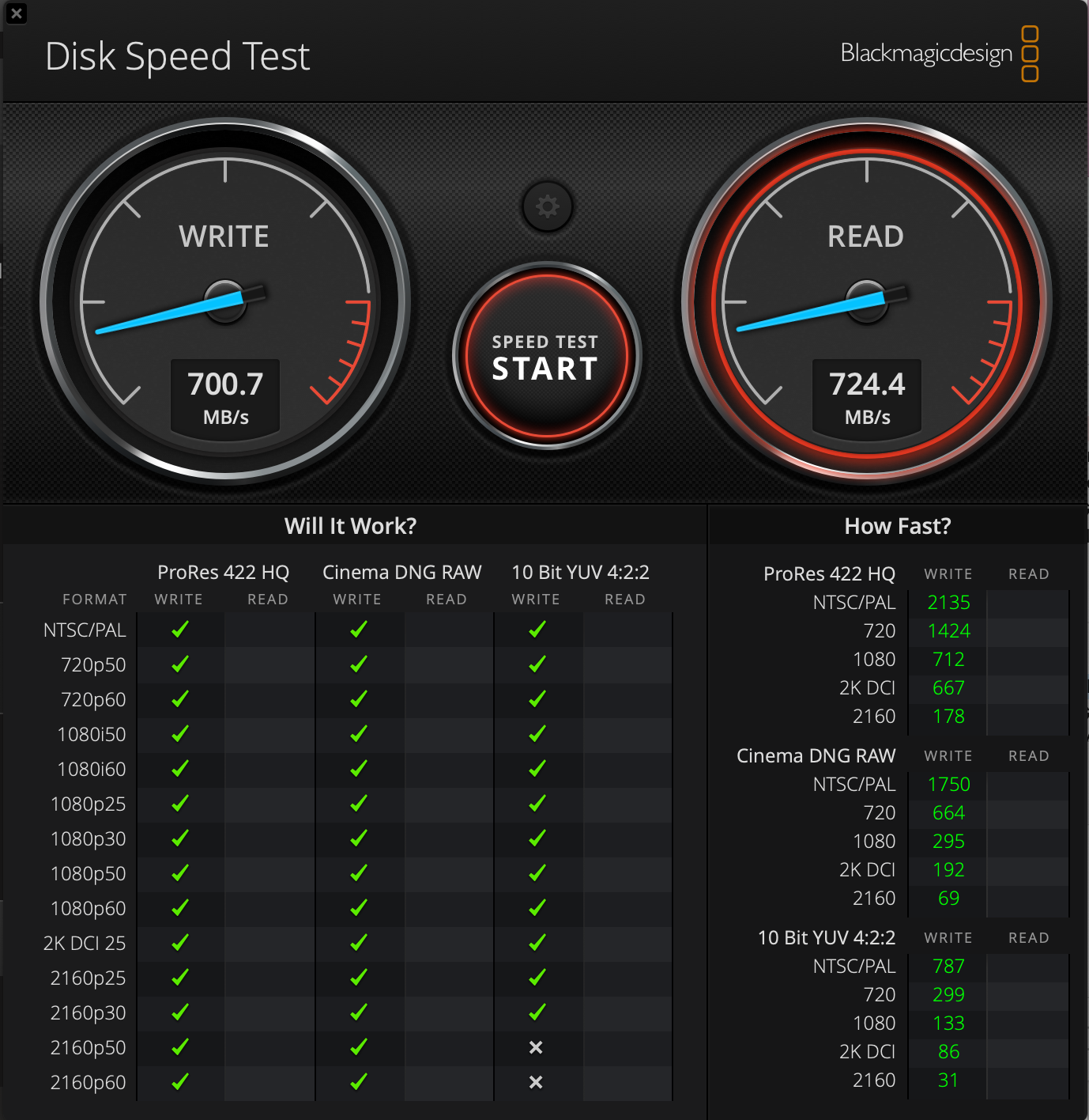

May 12, 20224 yr 17 hours ago, Audio01 said: I need a definitive answer, does this product (Unraid) is really compatible with macOS or should I look somewhere else? M1 MacBook Pro > OWC Thunderbolt Pro Doc > 10gbe ethernet cable > mikrotik 4 port 10gbe switch > direct attach copper cable > mellanox connectx-2 card > hp ml30 gen9 unraid server. file copy from the server, off a cache pool of 6 data ssd's in raid10, writing is about 100MB/s slower. Reading from my spinning array gets me about 170MB/s give or take using exos drives. Writing is a little slower. So, it works for me and my Mac. YMMV depending on server/client hardware specifics and tuning.
