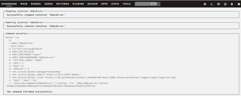

To get the docker run, I changed UID to 1 from 2. Just changed it back.
No fundamental reason why it wouldn't work off of that docker run command issued.  Run the New Permissions from Tools against the share and see if anything changes
If it doesn't then instead of mapping /mnt to /mnt change it to map instead /movies to /mnt/user/unraid/bluray/ and rebuild the library looking for files in /movies
Mapping /mnt to /mnt has never been particularly recommended (although its a convenient shortcut) as it is a security risk as now emby has complete read/write access to not only your media, but also any banking info on your server, the "special" pictures you keep etc etc

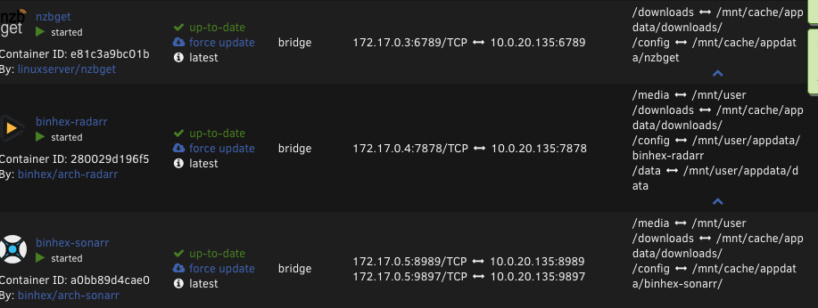

I am running to a similar issue, only with Radarr. It recently happened after 6.11.5 update
I notice if I ssh into the docker, create the folder and change the permission to 777. I get the import to run correctly.
tower-diagnostics-20221201-0655.zip

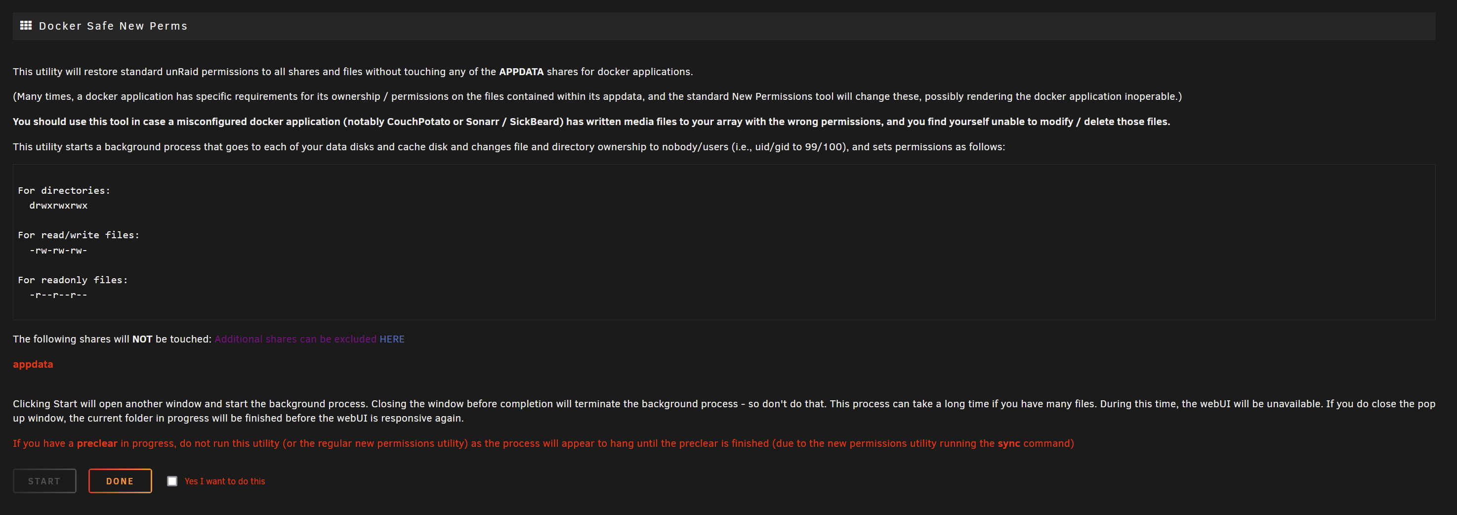

Probably Tools --> Docker Safe New Perms
That's part of the Plugin Fix Common Problems I think.
If you don't have it, you can use the built-in Tools / New Permissions.
In that case, you should not select you appdata share as it will screw up the applications permissions.
I used the built in Tools / New Permissions, selecting ALL shares
That can cause problems as it would include the appdata share and many dropper containers have their own specific requirements around permissions.
