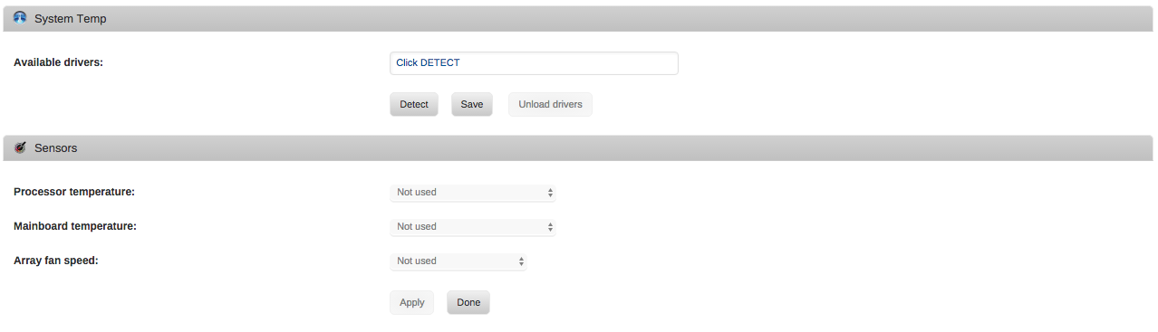

Can't seem to get this to work. In the plugin under drivers all I'm getting is the 'click detect', but it doesn't seem to do anything.
I went through the sensor-detect script in order to get sensors working, and it seems to be outputting temps correctly...
You didn't actually say what's not working.  ;)
It all looks fine, from what I can see.  What temps are you seeing on the Main page?
Ah. Right. :) Yeah, I'm not seeing any temps on the main page. Or the dashboard. They're supposed to show up towards the bottom, if I'm not mistaken?
The sensor command is working fine, but I can't seem to get the temps to pass through to the gui through the plugin.

    Did you assign the sensors?   Normally CPU and motherboard temperature are shown in the footer at the bottom right.
This may not be the reason for your case - On my system, there's a delay in the temp display that seems proportionate, or at least related, to the Display Setting Page update frequency.  If you have it set to Real-time, the temps appear almost immediately.  If set to Regular, they typically appear on the next 10 second cycle.  If set to Slow, it takes much longer.  And if set to Disabled, they may never show up, or it will be a long time.  I don't know the reason for this.
Hmm. No dice. I'm set at real time updates.
All the sensor fields are grayed out in the plugin...Is this expected?
I'll have to leave it to someone else.
By the way, you did install Perl first from the NerdPack?  Click the Help button.  Oops, just discovered that the Help doesn't mention Perl, not sure why.  Perhaps it installs it in the background?  You probably need bonienl's help.
Yep. I installed perl. Didn't use nerdpack though. Just downloaded it and installed using the installer described in the wiki. That & the detection script seemed to work just fine..

Maybe drastic measure (though it isn't that bad) - uninstall the plugin, this will remove both the package and settings, and re-install it by copy & paste this URL to the install box:
https://raw.github.com/bergware/dynamix/master/unRAIDv6/dynamix.system.temp.plg
You'll need to do detect again (make sure perl package is installed) and reassign CPU and MB sensors.
So, I figured it out. I was following the instructions on the wiki religiously, so I put sensors.conf in /boot/config/plugins/dynamix/
After no dice trying a bunch of things, I took an educated guess or two. Seems, at least for my box, it wouldn't work until I put it in /boot/config/plugins/dynamix.system.temp/
Did I miss the docs on that? I admit I didn't read this entire thread. Or should the wiki be updated?
Thanks bonenl and RobJ for the help.
To be frank, I haven't read the wiki, so I headed over to "lime-technology.com/wiki/index.php/Setting_up_CPU_and_board_temperature_sensing".
The steps in the wiki after based on an older version. Nowadays the installation is more simplified. A short overview
Step 1 - preparation
Install the perl package, this is required to run the script "sensors-detect" in the background.
Step 2 - detection
Press the detect button to search and automatically fill in the required drivers or alternatively - if you know the name of the driver(s) - fill them in manually.
Step 3 - saving and activation
Press the save button to save and activate (load) the driver(s). This will create the fille /config/plugins/dynamix.system.temp/drivers.conf on your flash device.
Step 4 - sensor assignment and display
Use the dropdown menus under sensors to assign the appropriate sensor for CPU and motherboard readings. You may need to consult the user guide of your motherboard to find out which sensor needs to be selected here. Once a sensor selection is done, the corresponding item will be displayed in the footer at the right of the screen. Press apply to confirm your selection. This will create the fille /config/plugins/dynamix.system.temp/sensors.conf on your flash device.
Done
Note: to unassign or remove a sensor just unselect it from the dropdown menu. This will also allow to make new assignment (for example when the wrong sensor was chosen).
Last but not least: see also the online help of system temp!

Worked Beautifully . Thanks for the summary and help.
