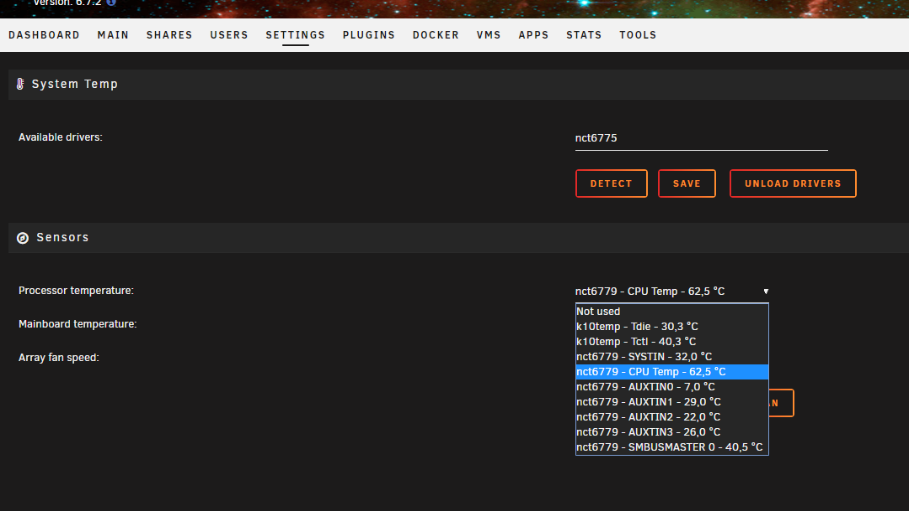

@bonienl any way to have the Nuvoton NCT6797D present on a lot of X570 motherboards of Ryzen 3000-series ? Detect doesn’t detect it, but the driver exist.
Ok, I downloaded the latest lm-sensors from GitHub and was able to use the most recent « sensors-detect ».  Here is what it found for my board (ASUS WS Pro X570-ACE).  I wonder how can i load that driver ?? :
Found `Nuvoton NCT6796D Super IO Sensors'                   Success!
    (address 0x290, driver `nct6775')

What makes you think those are negative temperatures?    Isn’t it just a case of a dash being used as a separator?

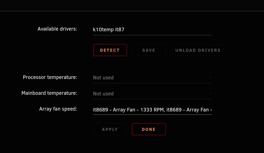

Hello, today I upgraded my MOBO to  PRIME X470-PRO. with the latest BIOS update, can't get all core temp and fans speed only CPU and MB with this driver k10temp, also Fan Auto Control didn't detect PWM fan. I added diagnostics also, I have read that there is no driver yet for IT8665E. I'd appreciate it if anyone can help. Thanks
here is the output of sensors-detect
root@Tower:~# sensors-detect --auto
# sensors-detect version 3.6.0
# Board: ASUSTeK COMPUTER INC. PRIME X470-PRO
# Kernel: 4.19.98-Unraid x86_64
# Processor: AMD Ryzen 5 1600 Six-Core Processor (23/1/1)

i have tried this as a way around modprobe it87 force_id=0x8620
root@Tower:~# modprobe it87 force_id=0x8620
modprobe: ERROR: could not insert 'it87': Device or resource busy
and the logs show
Tower kernel: it87: Found IT8620E chip at 0x290, revision 6
Tower kernel: it87: Beeping is supported
Tower kernel: ACPI Warning: SystemIO range 0x0000000000000295-0x0000000000000296 conflicts with OpRegion 0x0000000000000290-0x0000000000000299 (\AMW0.HWM) (20180810/utaddress-204)

My ASRock X570 Taichi worked fine with this app. However, when I upgraded to the ASRock X570 Creator it quit working. The x570 creator detects the k10temp nct6683 drivers (which is different from the taichi). I save and load the new detected drivers, and save again only to see "not used" in the three temp slots. Any ideas to get the creator to work with nct6683 drivers?
I had the same issues some of you guys are having that is it was working perfectly fine then I messed around with it and my drop down list became empty.
I finally got it fixed by deleting sensors.conf in /etc/sensors.d/ and then reinstalling dynamix. Then I ran into another problem where coretemp wasn't showing up in the list and I unloaded and reloaded the driver and that seem to have done the trick.
