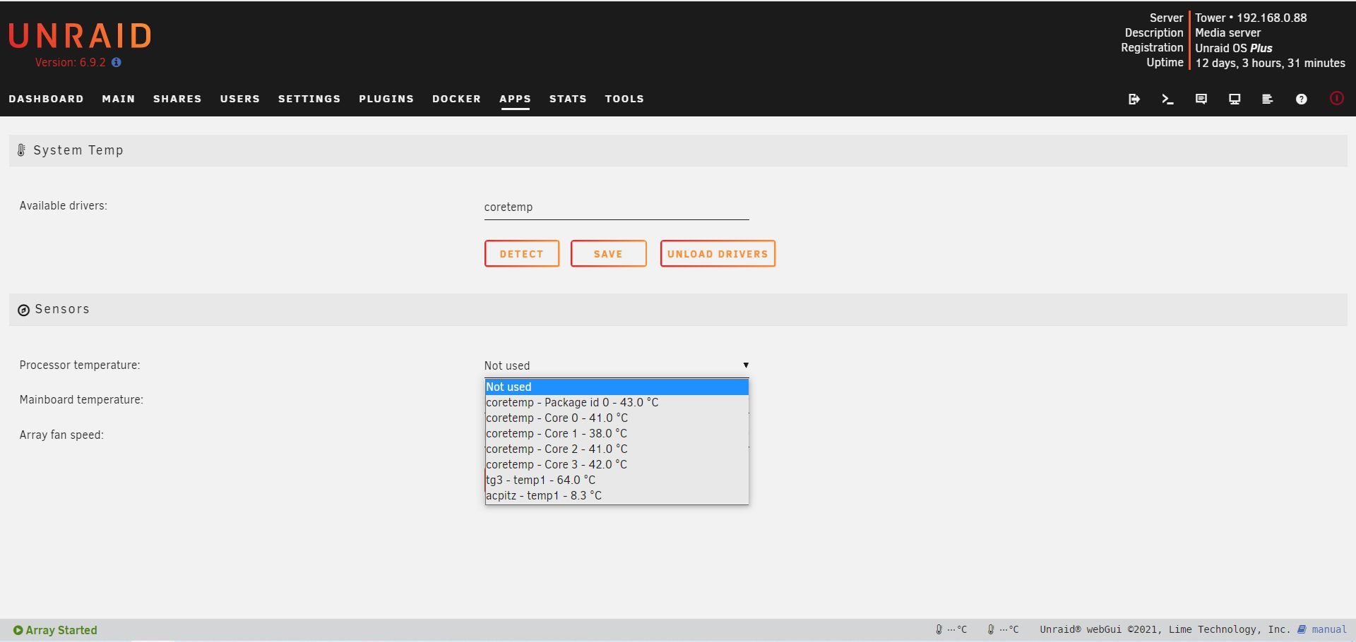

  • So need some help with sensor reading for Supermicro X9DRL-7F motherboard.  I have plugin installed.  It detects coretemp nbt7904. I Save it then load drivers.  After doing this all the dropdowns say
  • Most likely the 36C.  Unlikely its the ones that are the temp of the sun...
  • bonienl
    bonienl
    Did you assign the sensors?   Normally CPU and motherboard temperature are shown in the footer at the bottom right.
Just installed and I'm a bit confused about what to select for CPU/Motherboard as they both have the same selections to choose from.

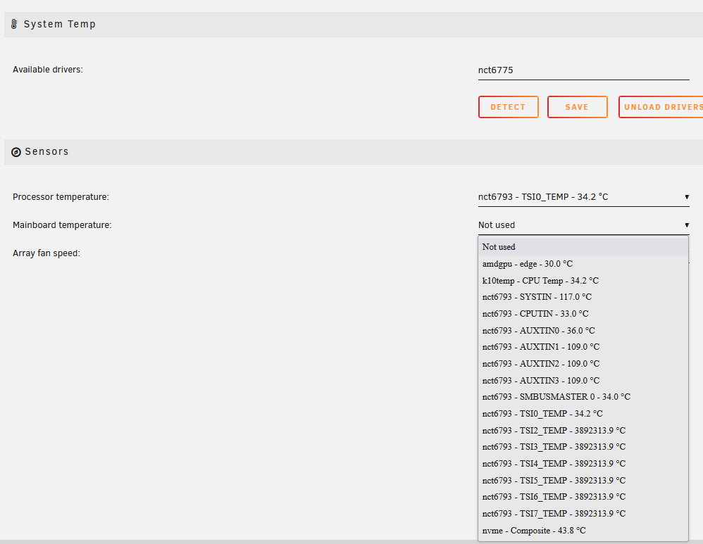

I've been using the system temperatures plugin for some time with success. Yesterday I shut down my system to install a Nvidia Quadro P400 to use for HW transcoding. Boot the device back up (did not check if the temp plugin worked at this time), install Nvidia Drivers, reboot.
Now the Nvidia drivers are working, HW transcoding is working, but the only temp sensor the plugin detects are the NVME SSD. The CPU and mobo temp sensors are "gone".
System is an AMD Ryzen 5 5600G CPU on a Asus TUF GAMING B550-PRO motherboard.
Don't know if it has anything to do with the P400 or not, but that was the only change I did from working to not-working.

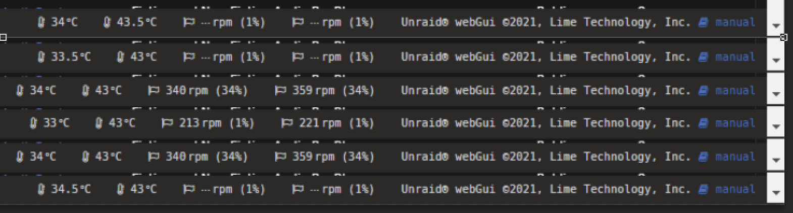

Is there any way to change the display at the bottom of the GUI to either ALWAYS diplay the decimal point or to NEVER display it? The constant shuffling of the line at the bottom back and forth is disconcerting.

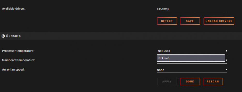

I downgraded my main Unraid server due to power consumption to a lower tdp AMD Ryzen CPU. I switched from Ryzen 9 3950X to a Ryzen Pro 5650GE and suddenly got no temp readings out of it. With the 3950X I got plenty temps including CPU, Mainboard etc.
I'm using the "Dynamix System Temperature" Plugin from CA and after the switch it only detects my two NVME drive temps.
Mainboard is a Asus Pro WS X570-ACE with BIOS Version 3904.
Any suggestions or experience what is the reason for this?

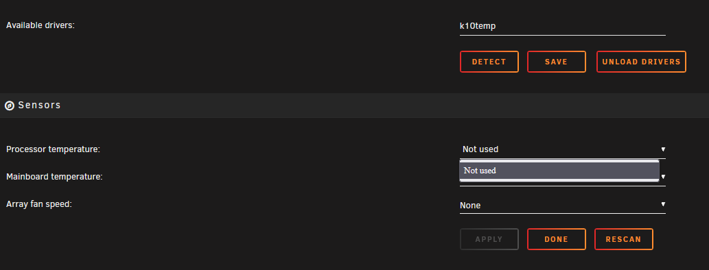

I just upgraded to a x570 and noticed no temps show up. seeing your post I assume this is a known issue?
I'm using Unraid v6.10rc4.
My hardware is an ASUS ROG STRIX X570-E  wiht X570s chipset + Ryzen 9 5950x.
First I've notice a very high power consumption (almost 100w more than my previous server while idle 😧).
About sensors, I've run the command 'sensors-detect' and have found 'jc42', 'k10temp' and 'nct6775'. Do not forget to reboot after this command. The sensors will appear automatically.
k10temp provide three diferents temperatures (Tctl, Tccd1 and Tccd2) and I think that one of them is the CPU temp.
jc42 provide multiple 'SMBus PIIX4 adapter' temperatures and I don't know wich one could be motherboard temp. Any help would be appreciated.
