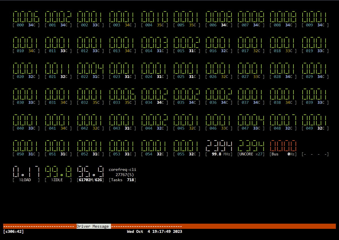

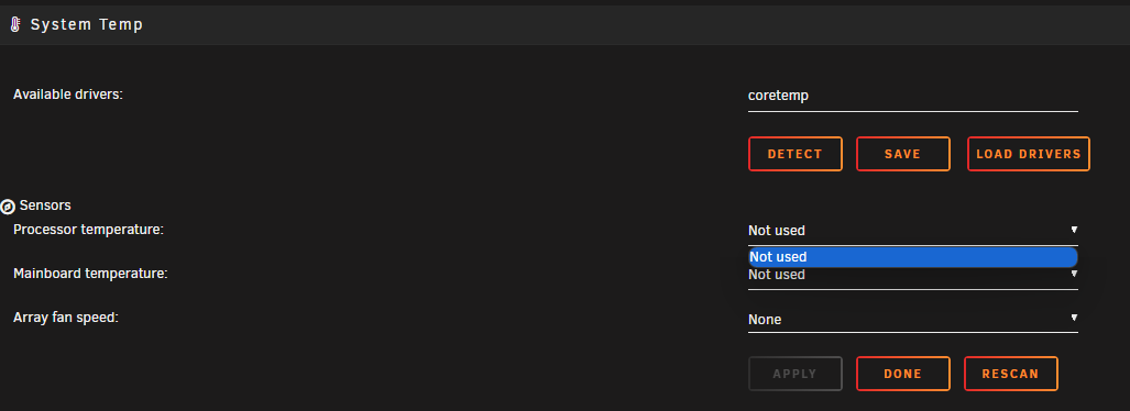

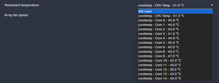

Hi, I have an HP Z840 workstation running unraid 6.12.4.   Using 2x E5-2680v4's (14c28t each).
Does the plugin support this platform?  Dashboard temps are blank and plugin settings don't show any sensors.  Detect shows coretemp as driver, but nothing under sensors.
I installed corefreq plugin and it shows the temps for all 56 cores
Edited by Cyklone

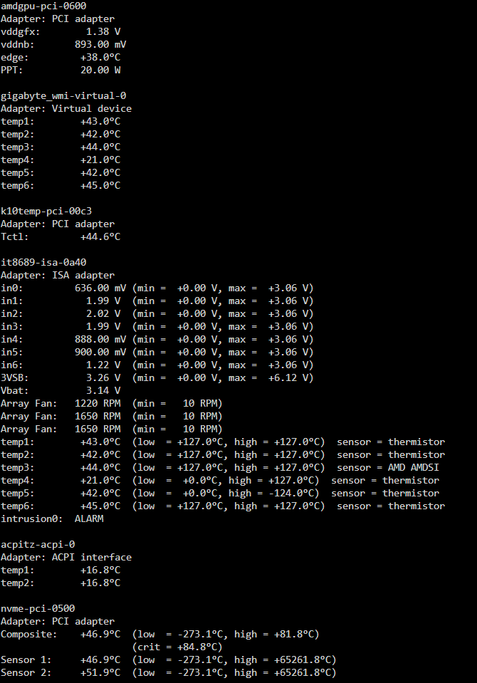

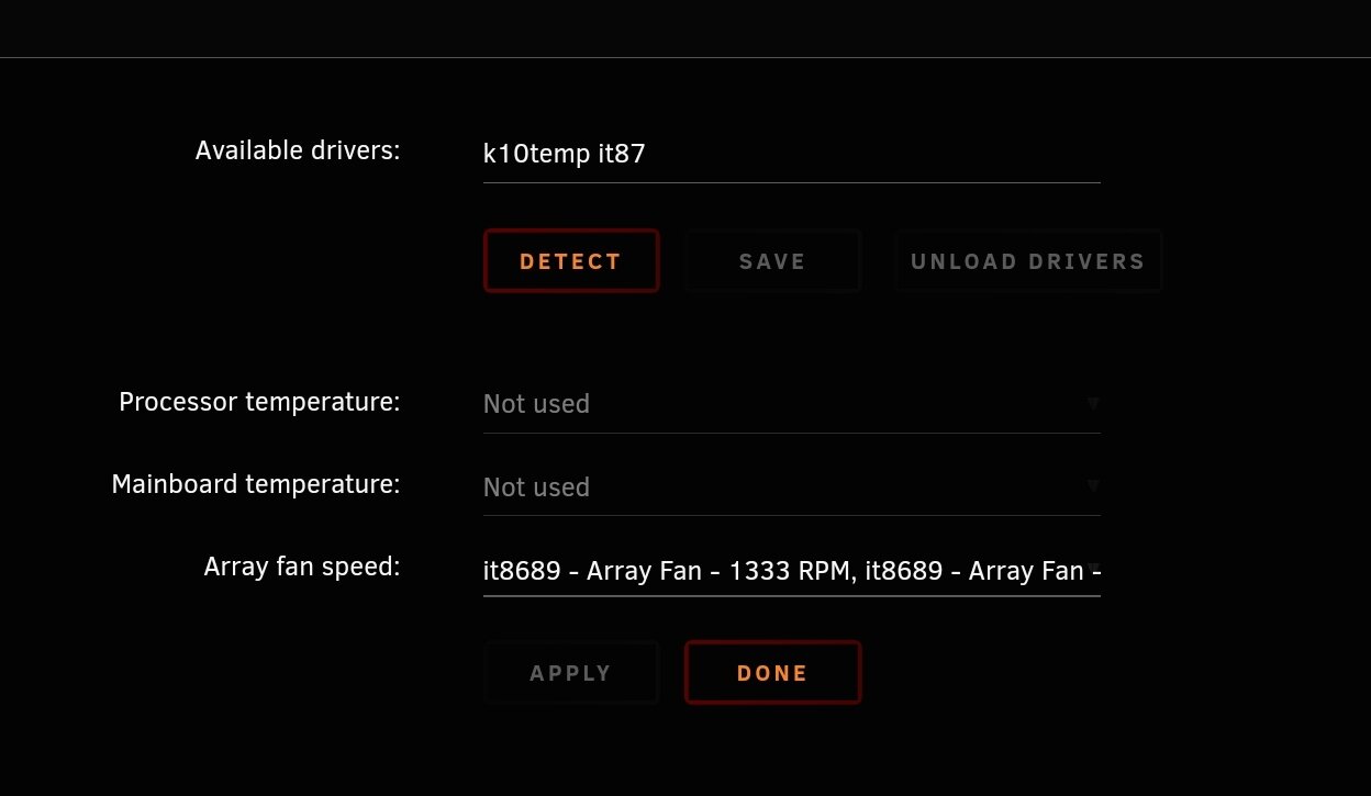

Is there any way to add the drivers this plugin needs for your motherboard? It is something a lot of people like and really want to have working but of course, we know it cant support all motherboards. Is there no way to update it yourself to add your own drivers?
Edited by NotHere

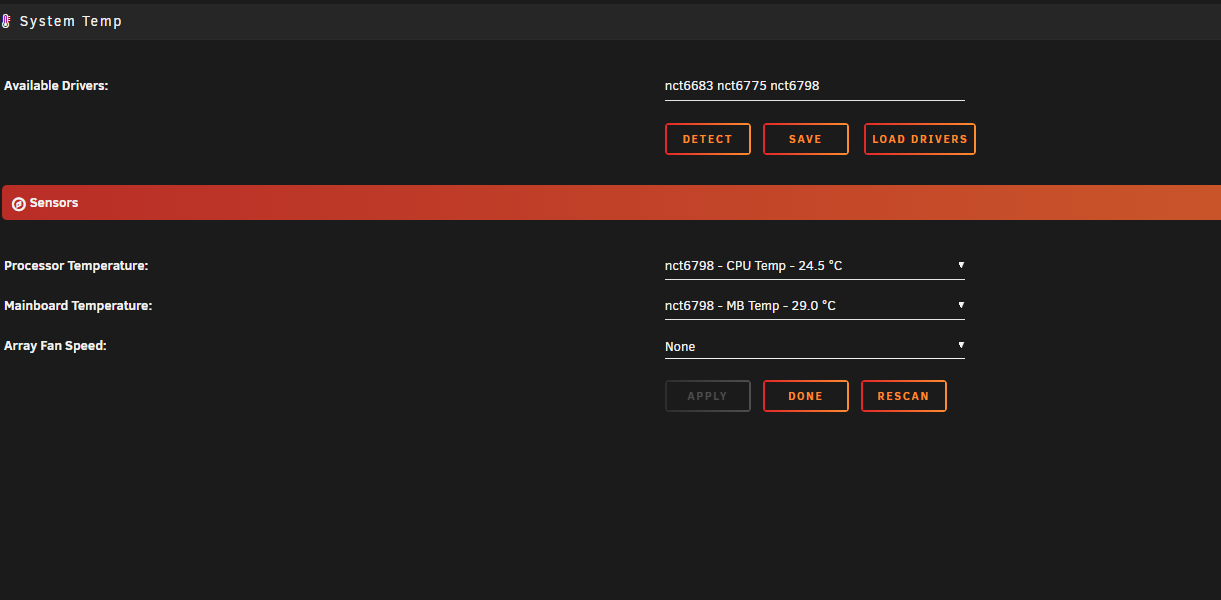

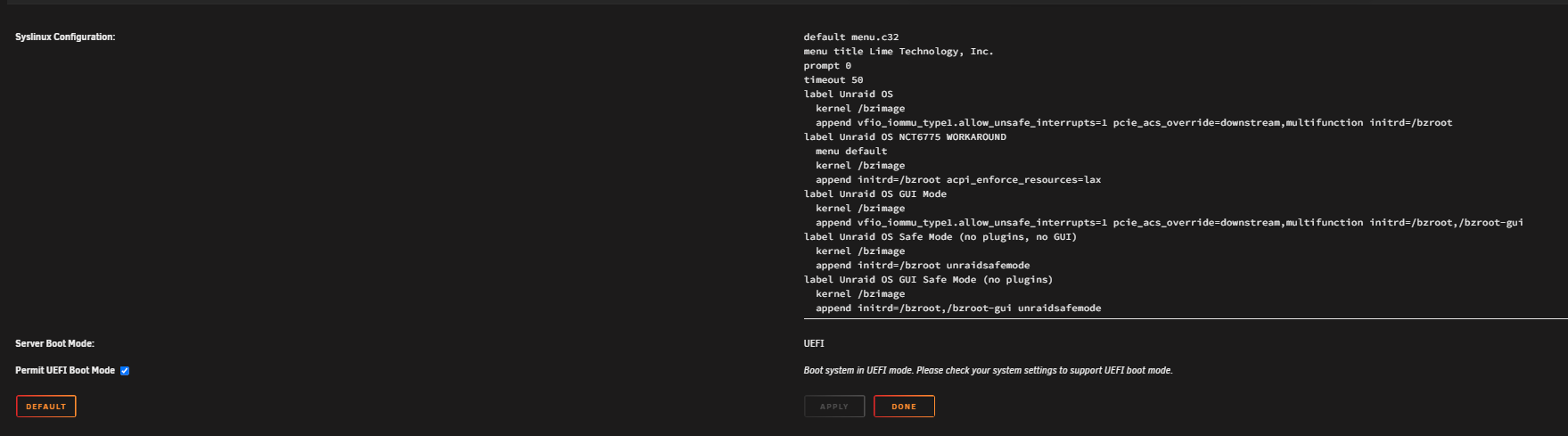

 Hello Everybody,
I´ve a little stuck with a B550 Taichi from Asrock. Maybe someone has already done it with this bord because I am stuck since i changed from a X470 to this bord. The Problem is that the Fans are not shown in the “System temp” Plugin and that is needed to add the fans to the fan control plugin. With the old bord it was working perfectly but sadly now I only can control the fans in BIOS.
What I’ve done until now.
  • reinstalled the System Temp Plugin
  • reinstall Nerd Pack
  • tipped Sensor Detect in the console and added the sensors with Mudprobe in the go file

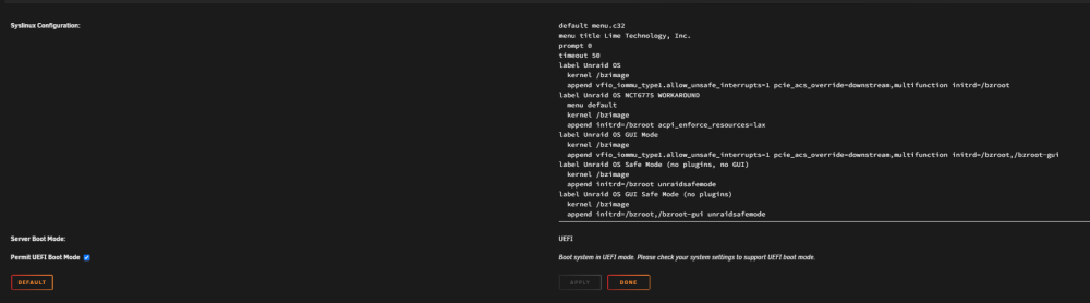

  • changed Bios fan settings to every possible setting
  • Installed the Nuvoton NCT 6687 Driver pack
  • Added "append initrd=/bzroot acpi_enforce_resources=lax" in the start sequenz of the flash drive
  • Ask in the German forum (
  • Googled a lot.
  • now asking in the system tempo forum
Would be nice if someone has some advice.
hanasselnas-diagnostics-20231102-1500.zip sensors detect.txt
Edited by Tidus1307

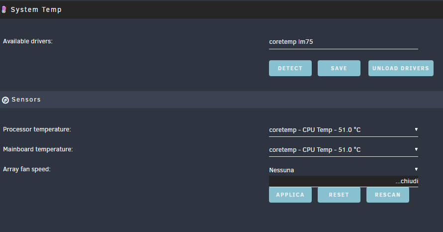

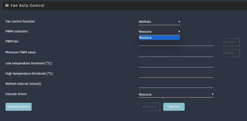

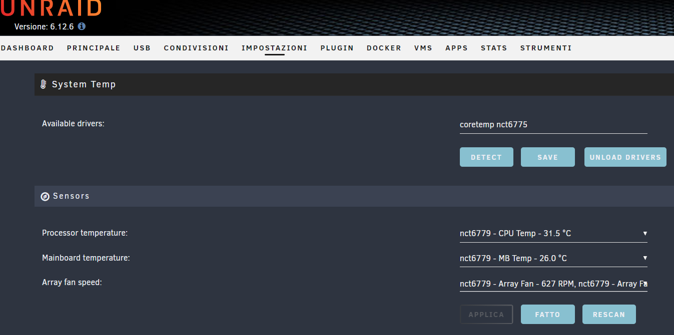

hi, starting from today i have a problem. Untill yesterday i can see mobo and cpu temp and can pwm my fan
This morning nothing is working, or better, i can see coretemp CPU TEMP, but no pwm control and mobo temp
Untill yesterday my sensor was NCT6775 today it recognize it as lm75....
(here my log  of july :
Jul 29 16:23:04 LordbyeNas autofan: autofan process ID 15733 started, To terminate it, type: autofan -q -c /sys/devices/platform/nct6775.2592/hwmon/hwmon1/pwm3 -f -q)
how can i try to solve? or where can i find any error?
thanks
thanks

i have solved with a downgrade to 6.12.5 and new update to 6.12.6
now

I've recently upgraded to a Z690 Gigabyte board and a i5-14500 but no longer getting system temps in dashboard.
image.png.84deb258d894710bec0b9beafdd90369.pngimage.png.e5f35fc8985696b65a115a3757a9cabe.png
Clicking detect in the system temp settings shows coretemp but no sensors.
Any advice?

Hey Guys,
Anybody needs a last advice befor i kick this out 🤣
I've been using a B560-I Gaming Motherboard since 2 or more years.
Together with a I3-10100 CPU
Temperature worked perfect for me.
The Temp Plugin worked fine.
As summer gets relly hot in Austria i need this Plugin for my own Security
I ran into problems and decided to do a complete clean Unraid.
reseted BIOS and changed all Disks and startet with the new unRAID 7.0.0. Beta. 1
Now installed the plugin again, tried to DETECT.
and it says no Drivers Detected
installed the Nuvoton NCT6687 Driver and rebooted.
Nothing worked.
Now at a reboot i saw this line:
Error: could not insert NCT6687 no such device.

Hello everyone,
I'm reaching out for some help with a problem I'm having with Dynamix System Temp. I’m not seeing the CPU and motherboard temperatures displayed.
Here are my system specs:
Motherboard (MBO): B550I AORUS PRO AX
CPU: AMD Ryzen 7 PRO 5750G
RAM: 32GB Samsung Multi-bit ECC (Unbuffered)
UNRAID Version: 7.0.0-beta.2
I’ve managed to get the fan readings working using the ITE IT87 Driver from ich777 available in the App store.
However, when I run the sensors command in the Terminal, I get the following output:
And here is what the System Temp page looks like:
Has anyone encountered this issue before or have any tips on how to fix it? I’d really appreciate any help or suggestions!
You need to specify the drivers manually in the "Available drivers" field. k10temp does the CPU and it87 does the motherboard temps.
k10temp it87
Once those are in there, be sure to click the "LOAD DRIVERS" button. You should then be able to select the processor and mainboard temps in the sensors drop-down.
DO NOT HIT "DETECT" ONCE YOU HAVE THIS WORKING. Doing that will overwrite the config and break things.
On 8/5/2024 at 8:15 AM, Lordbye said:
me too and i can't find a solution :(
Have you tried to manually specify the same drivers as were in use before? The "DETECT" button doesn't always get things right.
coretemp nct6775
k10temp it87
 Here an screenshot of my settings page:
   SmartSelect_20240810_013929_SamsungInternet.thumb.jpg.e73d9feb60ca8d7a4eac3dea6c7006a2.jpg
When i enter the "k10temp it87" into the Available drivers i can not press the Save or Load/Unload driver buttons, there are always greyed out. And when i enter the k10temp it87 and click Detect nothing happens. I tried to reinstall the plugin but there was no change in the behavior.
Edited by gega777
So, your sensors are working as they should in the terminal but the System Temp plugin is not able to read them for some reason. Seems like the Auto Fan Control plugin is working fine though since the fan speeds are showing up. At no point have I had the "detect" button not working at all so bear with me as I am learning as I go.
Running `sensors-detect` in the terminal works for you without any errors, correct? Can you confirm what version of Perl is installed? You can run `perl -v` in the terminal to get the version (I assume UnRAID 7 has it built-in, 6.12 does, but always good to confirm).
I have been poking around in the PHP files to understand how this plugin works in attempt to modify it to display more temps such as those from memory and VRM. I'm pretty new to stuff like this. I'll keep at it and see if I can figure out where things could be going wrong for you.
Edited by MrFrizzy

Hi everyone a newbie here.
I have an Asrock Z690 Extreme motherboard and 12th Gen Intel® Core™ i5-12600K
not detecting my temp.
i get available drivers as coretemp nct6775
motherboard, cpu not used  - and can not load anything.

I think it's assigning the wrong PWM percentage to fans.
(FAN1 is at 100% but it's assigning 100% to a different FAN)
Feels the mapping is detected incorrectly, is there any way I can manuimage.png.4f5a83bc51ab93adf7079ff5174a2fec.pngally correct this?
The fan on the left is at 100%, the fan on the right should be at 0%
