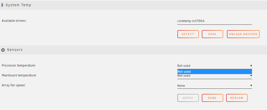

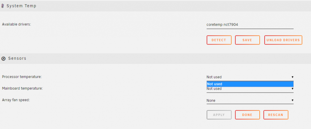

Any idea how to get System Temp to work (on Unraid 6.8.3 • Supermicro SuperServer 6027R-E1R12T (rev 03.54) • X9DRH-7TF V1.02)
The first time I installed it immediately after clicking detecting and it finding the nct7904 I had a whole bunch of sensors detecting but the second I clicked Done they all disappeared and I'm left with this:
My sensors seem to be found okay (although my fan speeds suddenly disappeared from netstat):

Now no matter what I try (reinstalling from scratch, any permutation of Detect and Load/Unload drivers), I can't get any sensors to show whatsoever. How do I get this to work on my hardware?

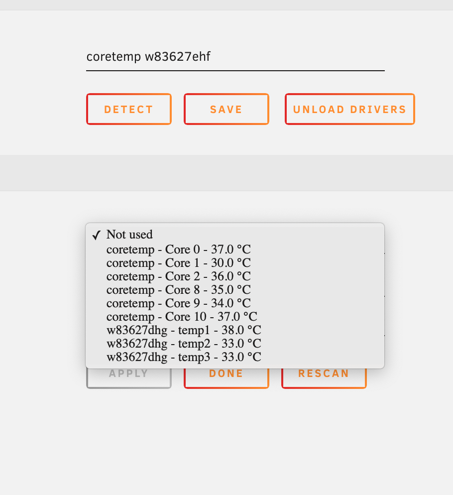

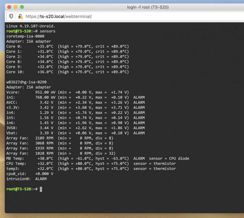

Guys, I think it's just the kernel that doesn't support the ASUS motherboards. I've got a ROG STRIX B450-I. Temperature sensors are detected by sensors-detect but nothing happens in UNRAID.

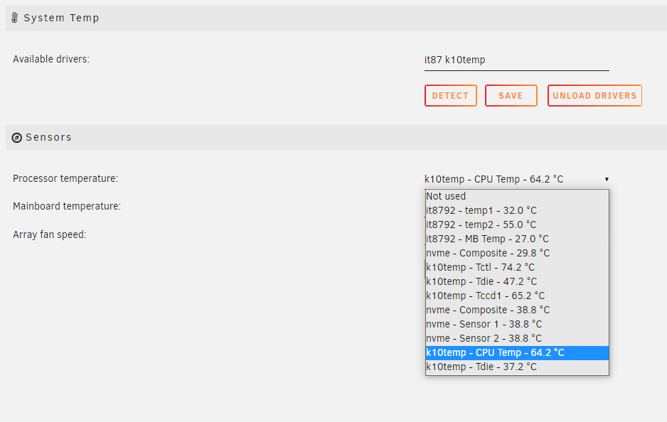

i found CPU temps:
Some south bridges, CPUs or memory controllers contain embedded sensors.
Do you want to scan for them? This is totally safe. (YES/no):
Silicon Integrated Systems SIS5595...                       No
VIA VT82C686 Integrated Sensors...                          No
VIA VT8231 Integrated Sensors...                            No
AMD K8 thermal sensors...                                   No
AMD Family 10h thermal sensors...                           No
AMD Family 11h thermal sensors...                           No
AMD Family 12h and 14h thermal sensors...                   No
AMD Family 15h thermal sensors...                           No
AMD Family 16h thermal sensors...                           No
AMD Family 17h thermal sensors...                           Success!
    (driver `k10temp')
but i'm not able to get mobo (Asus Prima a320m-a) temps:
Some Super I/O chips contain embedded sensors. We have to write to
standard I/O ports to probe them. This is usually safe.
Do you want to scan for Super I/O sensors? (YES/no):
Probing for Super-I/O at 0x2e/0x2f
Trying family `National Semiconductor/ITE'...               No
Trying family `SMSC'...                                     No
Trying family `VIA/Winbond/Nuvoton/Fintek'...               No
Trying family `ITE'...                                      Yes
Found `ITE IT8655E Super IO Sensors'                        Success!
    (address 0x290, driver `to-be-written')
Probing for Super-I/O at 0x4e/0x4f
Trying family `ITE'...                                      No
in the summary i'm told that there's no driver for Super IO Sensors:
Now follows a summary of the probes I have just done.
Just press ENTER to continue:
Driver `to-be-written':
  * ISA bus, address 0x290
    Chip `ITE IT8655E Super IO Sensors' (confidence: 9)
Driver `k10temp' (autoloaded):
  * Chip `AMD Family 17h thermal sensors' (confidence: 9)

I've just install Unraid 6.8.3 as a Trial and im looking forward to test out the Temp plugin for my Lenovo Thinkstation S20 which is using the X58 Chipset.
I found out that the temp and sensor detected aren't as i expected.
Ive notice my 6core Xeon CPU core temp are missing some of the core and the sensor capture i cant determine which is which.
Can anyone help me out on this or there another sensor driver that i could use to resolve this.
I'm very new to unRaid and no knowledge in Linux or whatever.
Basically this build is to replace my old WHS2010 which already EoLS for quite some time.
