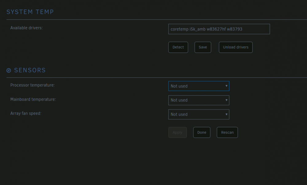

@Maor detect button just keeps writing "coretemp jc42" and shows no sencores in the dropdown menu
Changing the name to "jc42" worked for a second I could select sensors but hitting the Apply button made them all disappear again?
Same thing the first time I did a detect and then all gone?
Could be a small bug, beacuse everything was detected perfectly and then hitting Aply and it was gone

  • So need some help with sensor reading for Supermicro X9DRL-7F motherboard.  I have plugin installed.  It detects coretemp nbt7904. I Save it then load drivers.  After doing this all the dropdowns say

Also the dropdown fields are empty again?
Does it hide information somewhere? Because deleting the plugin and installing it again keeps the dropdowns empty
Only at the first install and me renaming the sensor from "coretemp jc42" to "jc42" I got the dropdown populated with all the sensors!
Haven't been able to get them back since?

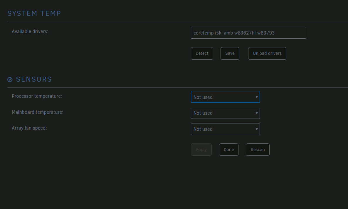

@bonienl Hi I have tried to create a small video to show you what happens.
To me it looks like the plugin is working perfectly until I press the apply button? Then everything is gone and I cant get the temp sensors back again?

On my system it works as expected and I can't reproduce the issue as shown in your video.
At the moment you press Apply, it will write the new settings to the flash device. Perhaps some corruption on your flash device?
Shutdown your system and take the USB out, let it error check on a Windows machine. See if this helps.

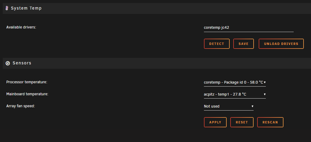

Tried manually running the sensors command and seeing what error it returns. I get the following:
Error: File /etc/sensors.d/sensors.conf, line 2: Undeclared bus id referenced
Error: File /etc/sensors.d/sensors.conf, line 4: Undeclared bus id referenced
Error: File /etc/sensors.d/sensors.conf, line 14: Undeclared bus id referenced
Error: File /etc/sensors.d/sensors.conf, line 16: Undeclared bus id referenced
sensors_init: Can't parse bus name
I removed the sensors.comf files and I can then reload the drivers and I can select the Temps I want to see, but as soon as I hit apply, The sensors drop down goes blank again & I get the same error as above if I run the command manually....
I had the same problem, ended up deleting the sensors.conf from BOTH /etc/sensors.d/ AND /boot/config/plugins/dynamix.system.temp/. Then, I uninstalled the plugin and re-installed it. That fixed it, for me at least.
I tried deleting both & reinstalling...but ended up still having the same issue

@clowrym I just tried again on the Rc4 and it works now!
