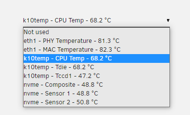

Hi, motherboard temps are not detected in Asrock X570 Creator motherboard. Thanks for you app.
Sensors:
root@Magatzem2:~# sensors
eth1-pci-2d00
Adapter: PCI adapter
PHY Temperature:  +81.3°C
MAC Temperature:  +82.4°C
k10temp-pci-00c3
Vcore:         1.55 V
Vsoc:        950.00 mV
CPU Temp:     +60.6°C
Tdie:         +60.6°C
Tccd1:        +46.8°C
Icore:         0.00 A
Isoc:          2.17 A
nvme-pci-3100
Composite:    +48.9°C  (low  = -273.1°C, high = +84.8°C)
                       (crit = +84.8°C)
Sensor 1:     +48.9°C  (low  = -273.1°C, high = +65261.8°C)
Sensor 2:     +50.9°C  (low  = -273.1°C, high = +65261.8°C)
Edited by Kanashii

there is no fix for current ver of Unraid..  there was a driver being built for the X570s and some other boards  on github.. and possibly its working in the next beta version.. but current stable version is not supported..  hopefully next stable release it be fixed

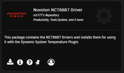

Thank you for the reply. I fixed it using one of your other solutions. The NCT6687 driver did not add any new temperatures to my list. Below is the solution that fixed my problem
