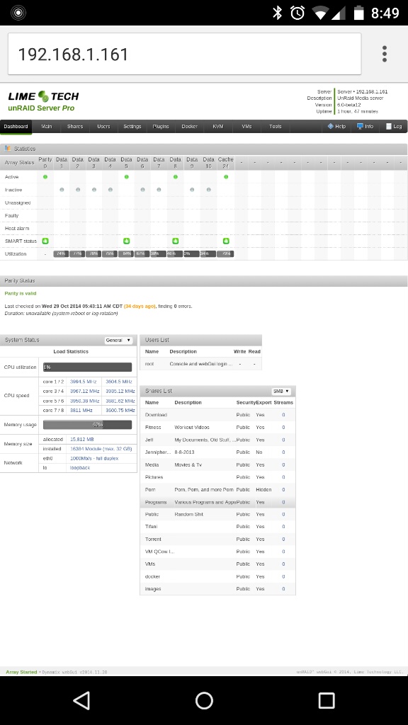

As one other individual in this thread mentioned, I also seem to be having an issue with my CPU not properly throttling and causing a high CPU clock rate.
I've been rebooted for about an hour and a half and still sitting at max CPU clock across all cores, with very little CPU activity.
Screen shot attached.
Anyone else looking at their dashboard and having this issue?
The other person was using XEN, which I am not.
Yes, four hyperthreaded cores, all running at 3.3GHz, with 1% cpu utilization.
same here
UPDATE: Umm ... errr is there any chance this has anything to do with the fact that I don't have a "cpufreq" directory in "/sys/devices/system/cpu/cpu0/cpufreq" ?? According to http://docs.slackware.com/howtos:hardware:cpu_frequency_scaling I should
Finding a solution should be easy enough then.
I look forward to Jon or Tom chiming in.

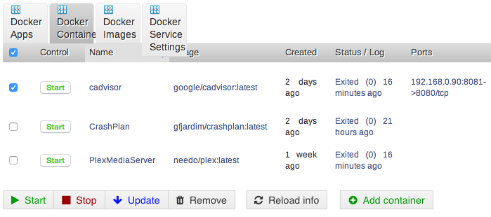

It seems that the update to the webGui has broken the docker plugin.
Unable to start any of my installed containers.
The Docker page now looks like the image.
Kevin
[Edit] All the status/log pages return blank.
Kevin
I am experiencing the same thing, autostart seems to work though....
Kevin
Please remove the DockerMan plugin under the Plugins tab.  It's no longer needed (and actually causing a conflict).
