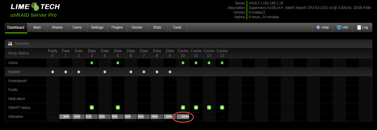

Not sure where to report this, but since Dynamix is the new WebGUI I will place it here. If I am posting it in the wrong place let me know.
On the Dashboard the Utilization percentage for the Cache drive is incorrect, this could be due to my use of a cache pool and the code is not calculating that. It shows a -293%. This was also true for the Stats page, but bonienl has already corrected that. Anyway attached is a screenshot showing the error.
Odd.  Can you click on the "Main" tab, then "Cache Devices", and then click on your first cache device.  From that page, please copy and paste what you see under "Pool info."  Thanks!
