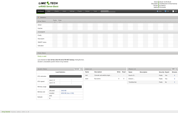

It's hard to see your screen capture with the black theme.  Can you turn it off and get a new screen capture?
here you go...

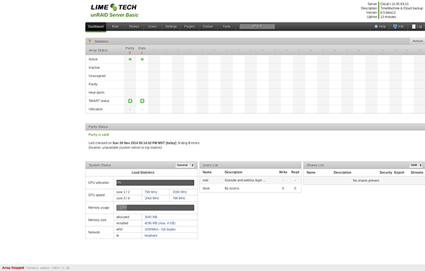

on a side note, if i stop the array, then the dashboard populates! then i start the array and the dashboard is empty.
The dashboard uses "smartctl" to do SMART info reading of each disk, this may take a while when all drives are spin up.
there is only 1 parity and 1 data disk
system status does NOT load either when the array is started

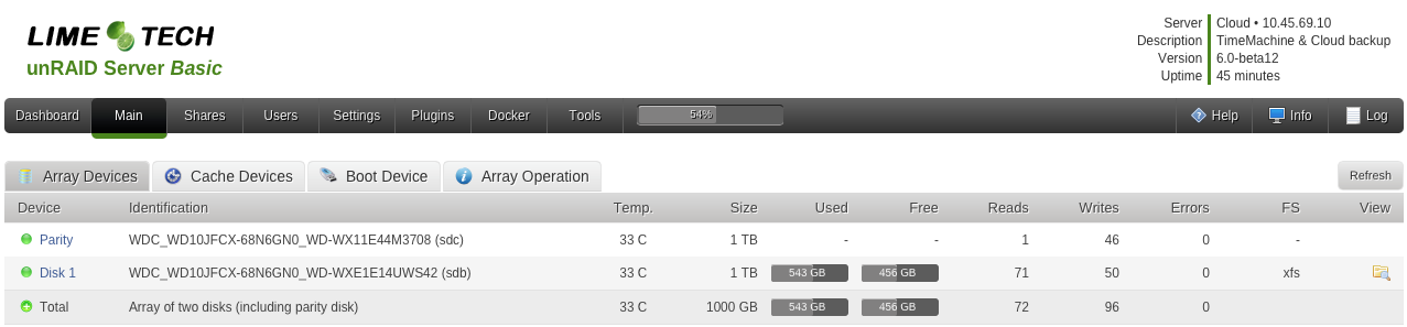

On the Main page the parity and data disk are shown as normal operating condition, after starting the array ?

And how does the "Cache Devices" look like (picture) ?
i don't have a cache drive
