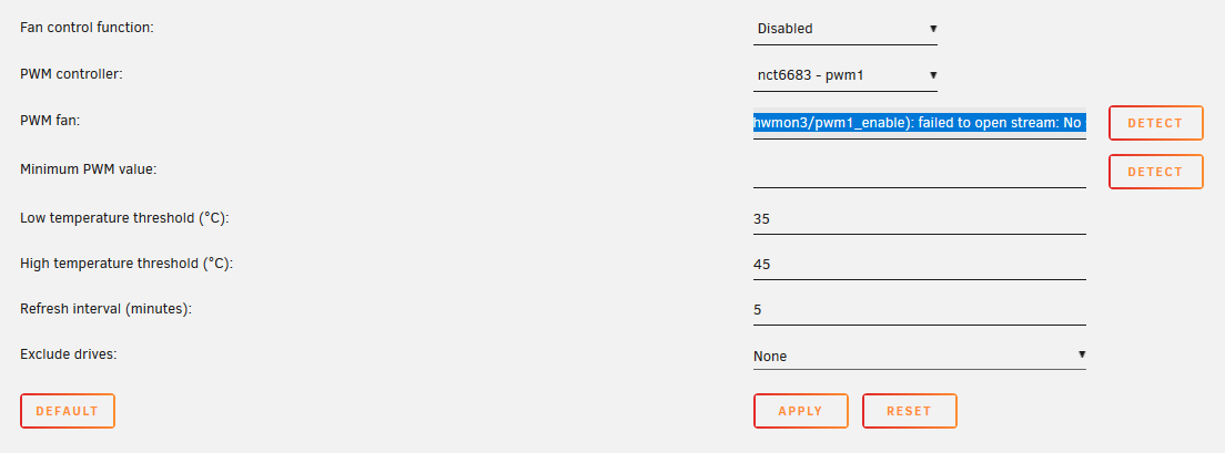

I'm getting permission denied in autofan plugin.... Any ideas why? The plugin is detecting my sensor chip nct6683 OK.
<br /><b>Warning</b>:  file_get_contents(/sys/devices/platform/nct6683.2592/hwmon/hwmon3/pwm1_enable): failed to open stream: No such file or directory in <b>/usr/local/emhttp/plugins/dynamix.system.autofan/include/SystemFan.php</b> on line <b>40</b><br /><br /><b>Warning</b>:  file_put_contents(/sys/devices/platform/nct6683.2592/hwmon/hwmon3/pwm1_enable): failed to open stream: Permission denied in <b>/usr/local/emhttp/plugins/dynamix.system.autofan/include/SystemFan.php</b> on line <b>42</b><br /><br /><b>Warning</b>:  file_put_contents(/sys/devices/platform/nct6683.2592/hwmon/hwmon3/pwm1): failed to open stream: Permission denied in <b>/usr/local/emhttp/plugins/dynamix.system.autofan/include/SystemFan.php</b> on line <b>43</b><br /><br /><b>Warning</b>:  file_put_contents(/sys/devices/platform/nct6683.2592/hwmon/hwmon3/pwm1): failed to open stream: Permission denied in <b>/usr/local/emhttp/plugins/dynamix.system.autofan/include/SystemFan.php</b> on line <b>46</b><br /><br /><b>Warning</b>:  file_put_contents(/sys/devices/platform/nct6683.2592/hwmon/hwmon3/pwm1): failed to open stream: Permission denied in <b>/usr/local/emhttp/plugins/dynamix.system.autofan/include/SystemFan.php</b> on line <b>49</b><br /><br /><b>Warning</b>:  file_put_contents(/sys/devices/platform/nct6683.2592/hwmon/hwmon3/pwm1_enable): failed to open stream: Permission denied in <b>/usr/local/emhttp/plugins/dynamix.system.autofan/include/SystemFan.php</b> on line <b>50</b><br />/sys/devices/platform/nct6683.2592/hwmon/hwmon3/fan2_input

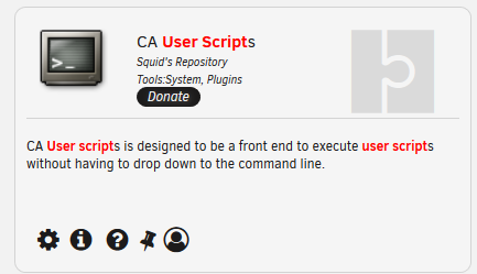

Anyone with issues loading their sensor module and/or missing sensors for their motherboard, please read....
I have a Z490 Asrock ITX/TB3 board and have been battling for months trying to get the sensors to display in systemp plugin.
I have finally found a way to do it for the NCT6683 sensor chip.
I created a user script using the excellent plugin that contains the following at array startup-
modprobe -r nct6683
modprobe nct6683 force=1
The 1st line unloads the module.
The 2nd line loads the module using the 'force' option.
Now on every reboot of UNRAID i have full sensors from both coretemp and nct6683.

I downloaded the plugin
then set up a script like this...
with the script contents
#!/bin/bash
modprobe -r nct6683

Do you want to scan for Super I/O sensors? (YES/no): y
Probing for Super-I/O at 0x2e/0x2f
Trying family `National Semiconductor/ITE'...               No
Trying family `SMSC'...                                     No
Trying family `VIA/Winbond/Nuvoton/Fintek'...               No
Trying family `ITE'...                                      No
Probing for Super-I/O at 0x4e/0x4f
Trying family `VIA/Winbond/Nuvoton/Fintek'...               Yes
Found `Nuvoton NCT6797D Super IO Sensors'                   Success!
    (address 0xa20, driver `nct6775')
Some systems (mainly servers) implement IPMI, a set of common interfaces
through which system health data may be retrieved, amongst other things.
We first try to get the information from SMBIOS. If we don't find it
there, we have to read from arbitrary I/O ports to probe for such
interfaces. This is normally safe. Do you want to scan for IPMI
interfaces? (YES/no): y
Probing for `IPMI BMC KCS' at 0xca0...                      No
Probing for `IPMI BMC SMIC' at 0xca8...                     No
Some hardware monitoring chips are accessible through the ISA I/O ports.
We have to write to arbitrary I/O ports to probe them. This is usually
safe though. Yes, you do have ISA I/O ports even if you do not have any
ISA slots! Do you want to scan the ISA I/O ports? (yes/NO): y
Probing for `National Semiconductor LM78' at 0x290...       No
Probing for `National Semiconductor LM79' at 0x290...       No
Probing for `Winbond W83781D' at 0x290...                   No
Probing for `Winbond W83782D' at 0x290...                   No
Lastly, we can probe the I2C/SMBus adapters for connected hardware
monitoring devices. This is the most risky part, and while it works
reasonably well on most systems, it has been reported to cause trouble
on some systems.
Do you want to probe the I2C/SMBus adapters now? (YES/no): y
Using driver `i2c-piix4' for device 0000:00:14.0: AMD KERNCZ SMBus
Module i2c-dev loaded successfully.
Next adapter: SMBus PIIX4 adapter port 0 at 0b00 (i2c-0)
Do you want to scan it? (yes/NO/selectively): y
Client found at address 0x29
Probing for `National Semiconductor LM78'...                No
Probing for `National Semiconductor LM79'...                No
Probing for `National Semiconductor LM80'...                No
Probing for `National Semiconductor LM96080'...             No
Probing for `Winbond W83781D'...                            No
Probing for `Winbond W83782D'...                            No
Probing for `Nuvoton NCT7802Y'...                           No
Probing for `Winbond W83627HF'...                           No
Probing for `Winbond W83627EHF'...                          No
Probing for `Winbond W83627DHG/W83667HG/W83677HG'...        No
Probing for `Asus AS99127F (rev.1)'...                      No
Probing for `Asus AS99127F (rev.2)'...                      No
Probing for `Asus ASB100 Bach'...                           No
Probing for `Analog Devices ADM1021'...                     No
Probing for `Analog Devices ADM1021A/ADM1023'...            No
Probing for `Maxim MAX1617'...                              No
Probing for `Maxim MAX1617A'...                             No
Probing for `Maxim MAX1668'...                              No
Probing for `Maxim MAX1805'...                              No
Probing for `Maxim MAX1989'...                              No
Probing for `Maxim MAX6655/MAX6656'...                      No
Probing for `TI THMC10'...                                  No
Probing for `National Semiconductor LM84'...                No
Probing for `Genesys Logic GL523SM'...                      No
Probing for `Onsemi MC1066'...                              No
Probing for `Maxim MAX1618'...                              No
Probing for `Maxim MAX1619'...                              No
Probing for `National Semiconductor LM82/LM83'...           No
Probing for `Maxim MAX6654'...                              No
Probing for `Maxim MAX6690'...                              No
Probing for `Maxim MAX6680/MAX6681'...                      No
Probing for `Maxim MAX6695/MAX6696'...                      No
Probing for `Texas Instruments TMP400'...                   No
Probing for `National Semiconductor LM95235'...             No
Probing for `National Semiconductor LM95245'...             No
Probing for `Analog Devices ADM1029'...                     No
Probing for `ITE IT8712F'...                                No
Probing for `SMSC EMC1402'...                               No
Probing for `SMSC EMC1403'...                               No
Probing for `SMSC EMC1404'...                               No
Client found at address 0x4a
Probing for `National Semiconductor LM75'...                No
Probing for `National Semiconductor LM75A'...               No
Probing for `Dallas Semiconductor DS75'...                  No
Probing for `National Semiconductor LM77'...                No
Probing for `Analog Devices ADT7410/ADT7420'...             No
Probing for `Analog Devices ADT7411'...                     No
Probing for `Maxim MAX6642'...                              No
Probing for `Texas Instruments TMP435'...                   No
Probing for `National Semiconductor LM73'...                No
Probing for `National Semiconductor LM92'...                No
Probing for `National Semiconductor LM76'...                No
Probing for `Maxim MAX6633/MAX6634/MAX6635'...              No
Probing for `NXP/Philips SA56004'...                        No
Client found at address 0x52
Probing for `Analog Devices ADM1033'...                     No
Probing for `Analog Devices ADM1034'...                     No
Probing for `SPD EEPROM'...                                 Yes
    (confidence 8, not a hardware monitoring chip)
Client found at address 0x53
Next adapter: SMBus PIIX4 adapter port 2 at 0b00 (i2c-1)
Next adapter: SMBus PIIX4 adapter port 3 at 0b00 (i2c-2)
Next adapter: SMBus PIIX4 adapter port 4 at 0b00 (i2c-3)
Now follows a summary of the probes I have just done.
Just press ENTER to continue:
Driver `k10temp':
  * Chip `AMD Family 17h thermal sensors' (confidence: 9)
Driver `nct6775':
  * ISA bus, address 0xa20
    Chip `Nuvoton NCT6797D Super IO Sensors' (confidence: 9)
Do you want to overwrite /etc/sysconfig/lm_sensors? (YES/no): y
Copy prog/init/lm_sensors.init to /etc/init.d/lm_sensors
for initialization at boot time.
You should now start the lm_sensors service to load the required
kernel modules.
Unloading i2c-dev... OK
sensors:
No sensors found!
Make sure you loaded all the kernel drivers you need.
Try sensors-detect to find out which these are.
version of UNRAID?
