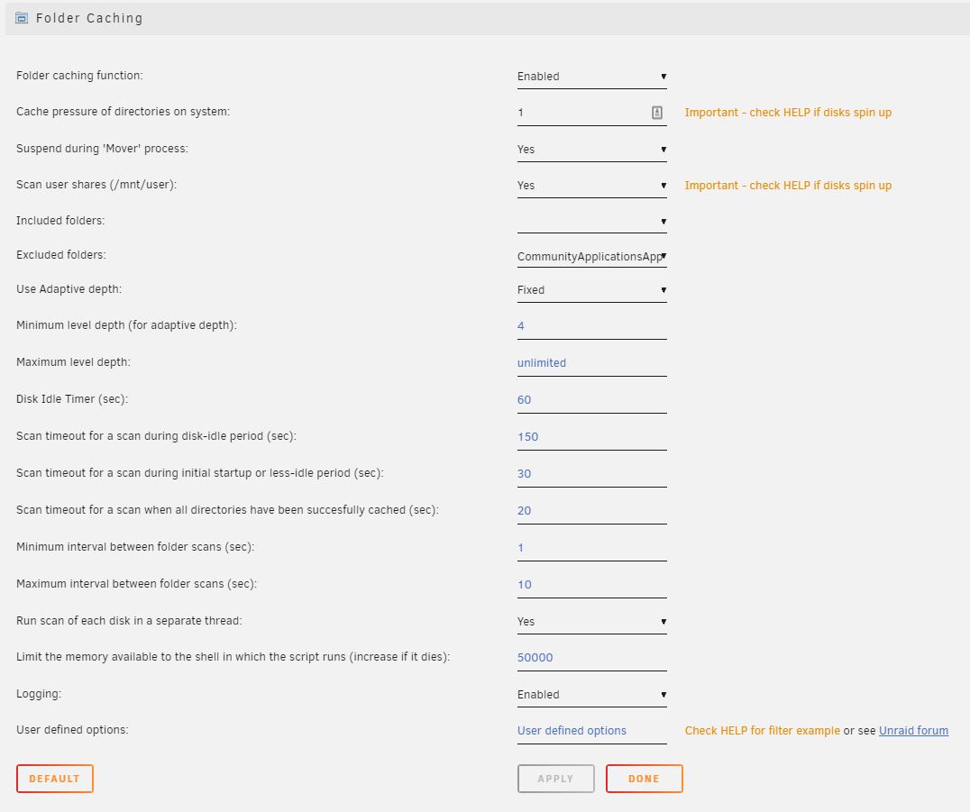

I believe that under 6.9 scan user shares (/mnt/user) should be set to no
Thx, disabling and will report back.

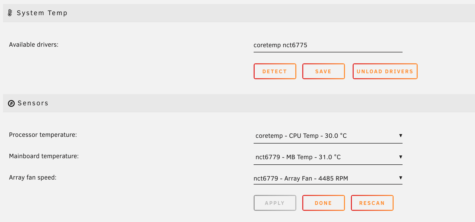

On 3/2/2021 at 3:04 PM, pervel said:
Is there something I can do to get all temperature monitors for my ASUS ROG STRIX B550-E GAMING motherboard?
This is the only thing I am getting:
I think the three k10temp are all CPU temperature but I'm not sure. They are almost always exactly the same. I would really like to also get motherboard temperature.
Did you ever find a solution to this? I have the same issue.
Sadly not. I've basically given up on this issue.
Appending
acpi_enforce_resources=lax
to the syslinux config works, but I don't consider it a permanent solution.
Do we need a new kernel version to get all readings on B550 boards or what's the deal?

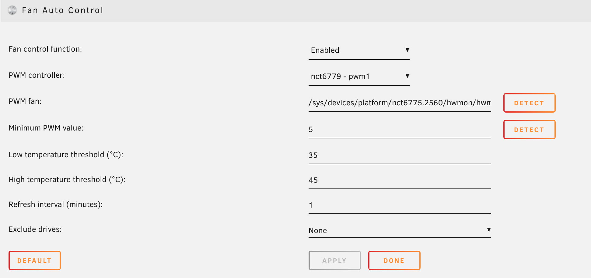

Hello,
i'm having some issues with my chassis fans on unraid 6.9.2.
I installed 2 new fans to my MSI Z97 PC Mate(MS-7850) mobo today.
i introduced a 3 male to 1 female splitter with the two fans that came with my chassis and 140mm noctua, going to sys_fan3. I have 1 140mm noctua plugged directly in to sys_fan2 and have a water cooler plugged in to cpu_fan1.
Until i installed the two noctua fans today, the two chassis fans and the cpu cooler fans seemed to operate normal. After introducing the 3 to 1 splitter and adding 2 new fans today, my system sounds like it's about to take flight.
I've tried installing the SystemTemp plugin 2020.06.20
as well as Autofan 2020.06.21
But i dont seem to have any progress slowing the fans down. Please help! I can't keep my server running at this dB level!
Try running the "detect" minimum PWM value again, or trying manually setting it higher.
hey tjb, all my settings in there were from detect except the minutes to refresh which i set manually to '1'
I opened my rig open and tore all the fan connections apart and started testing things 1 by 1. It seems my issue was:
Noctua fans had a 4 pin connector
the 1 female to 3 male adapter had 4 pins or holes on each end
The 4 pin female end adapter was plugged in to sys_fan3 which only had 3 pins.
Under this setup i was trying to adjust the fan profiles in the bios but nothing worked, all the fans were only running at 1 spee: blast off.
I've learned for myself that the 4 pin fan's need 4 pins on the mobo or they will not get any directions. I moved both Noctua fans to the splitter with the 4 female holes into sys_fan1 which had 4 pins, and the 3 pin fans that came in the case from fractal are going straight to the 3 pin fans on the mobo.
Those noctua fans on full blast are no joke, but I'm finally able to hear myself think :D

Any idea why the Dynamix System Temperature is not updating? It is just stuck reporting a singular temperature for my MB and CPU
