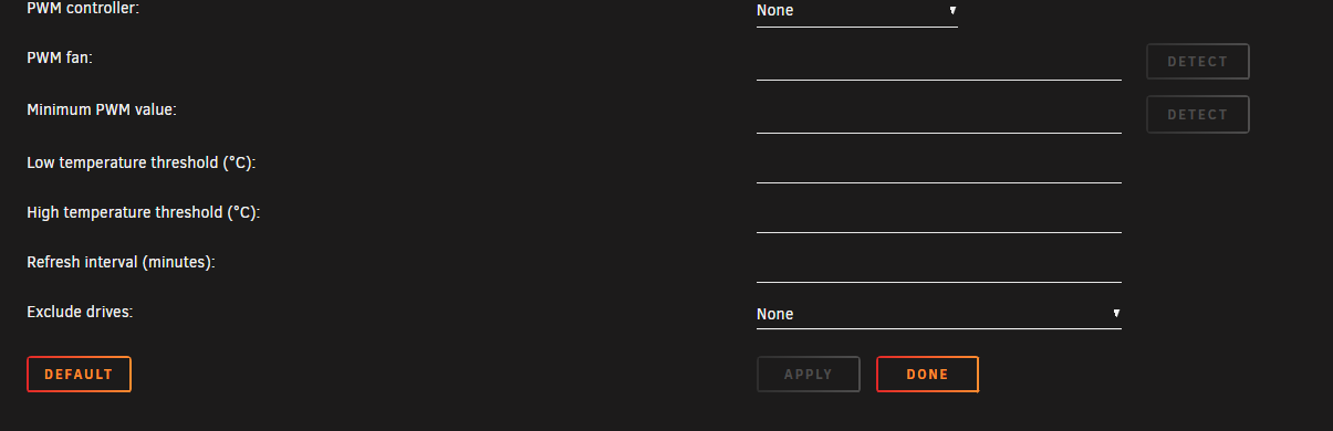

I´m trying run Dynamix System Autofan on MSI 460M Mortar, but cannot see properly the fans and show the error below:
"<br /><b>Warning</b>:  file_get_contents(/sys/devices/platform/nct6687.2592/hwmon/hwmon3/pwm3_enable): failed to open stream: No such file or directory in <b>/usr/local/emhttp/plugins/dynamix.system.autofan/include/SystemFan.php</b> on line <b>40</b><br /><br /><b>Warning</b>:  file_put_contents(/sys/devices/platform/nct6687.2592/hwmon/hwmon3/pwm3_enable): failed to open stream: Permission denied in <b>/usr/local/emhttp/plugins/dynamix.system.autofan/include/SystemFan.php</b> on line <b>42</b><br /><br /><b>Warning</b>:  file_put_contents(/sys/devices/platform/nct6687.2592/hwmon/hwmon3/pwm3_enable): failed to open stream: Permission denied in <b>/usr/local/emhttp/plugins/dynamix.system.autofan/include/SystemFan.php</b> on line <b>50</b><br />/sys/devices/platform/nct6687.2592/hwmon/hwmon3/fan3_input"
I could added the driver NCT6687-isa-0a20 to the GO file in the startup and the temperature for MB and CPU are working fine.
I will appreciate any help

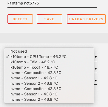

Is there something I can do to get all temperature monitors for my ASUS ROG STRIX B550-E GAMING motherboard?
This is the only thing I am getting:
I think the three k10temp are all CPU temperature but I'm not sure. They are almost always exactly the same. I would really like to also get motherboard temperature.

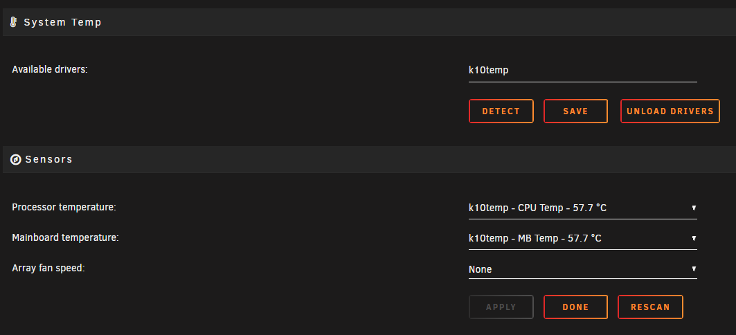

Hi All,
I've been patiently waiting for 6.9 to come out so that i could get my temps and fans working on my ryzen system.
I have a ryzen 3600 & ROG STRIX B450-I MB.
I managed to get the temps working but the PWM fans arent being recognised.
I installed Noctua case fans and CPU fan.
Heres my temp set-up in Dynamix System Temperature
And here what i see in Dynamix Auto Fan Control
Any help would be great.!
Cheers
D.

You need to run “sensors detect” from the command line to see what drivers you need to load
I'm guessing this is my problem:-
Driver `to-be-written':
  * ISA bus, address 0x290
    Chip `ITE IT8665E Super IO Sensors' (confidence: 9)
Yep.

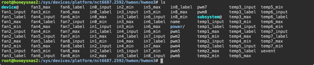

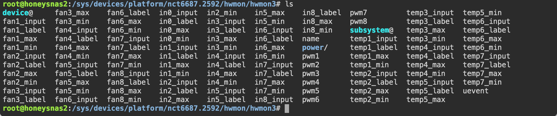

any update for the drive NCT6687? When I try to use the Autofan plugin and press detect, the below message show up:
Any help to fix this?
Also checking the file location:

/tmp/user.scripts/tmpScripts/FanSpeed/script: line 90: /sys/class/hwmon/hwmon3/device/hwmon/hwmon3/pwm3_enable: Permission denied
Setting pwm to: 30"
Also in the folder /sys/class/hwmon/hwmon3/device/hwmon/hwmon3, i don´t have any permission and pwm3_enable is not present
