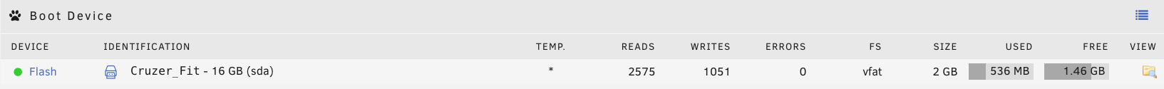

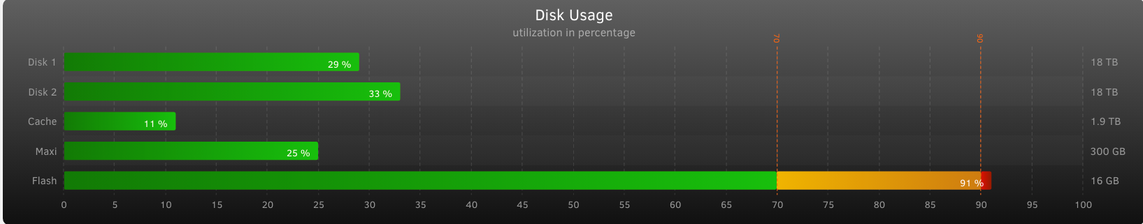

Ha! On the advice of @SpaceInvaderOne I've just installed the Dynamix Stats plugin, which has drawn my attention to an anomaly with my boot flash drive.
I hadn't noticed before that on the MAIN tab what is supposed to be a 16GB USB stick is reported as only having 2GB capacity. The Stats plugin seems to make this very clear.
Is this 16GB CruzerFit a fake? All suggestions welcome.
Chris
Edited by bidmead
Chris
If you back it up first, it should be easy enough to test by seeing if you can successfully write the expected amount of data to the drive and then also read it back intact.   If it IS a fake one of those steps will fail.
