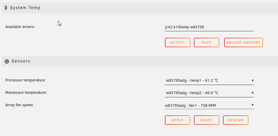

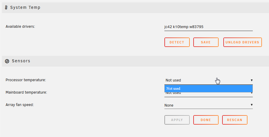

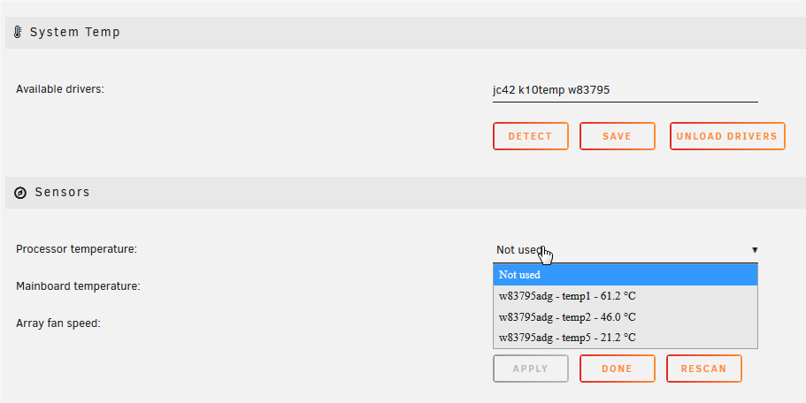

On 6/23/2020 at 1:08 PM, GFRoSTY said:
I
I can second this find.
I'm playing with a HP NL54 microserver.
After installing the plugin it detects the correct sensors.
Assignment of sensors
Pressing "APPLY"
Of course, no sensor data is displayed.
After deleting /etc/sensors.d/sensors.conf I can repeat the procedure. If the file is not deleted or modified like below, no chance to
get the selection back.
Initial sensors.conf
root@Tower:~# cat /etc/sensors.d/sensors.conf
# sensors
chip "k10temp-pci-00c3"
label "temp1" "CPU Temp"
chip "w83795adg-i2c-1-2f"
label "temp2" "MB Temp"
label "fan1" "Array Fan"
root@Tower:/etc/sensors.d# sensors
Error: File /etc/sensors.d/sensors.conf, line 4: Undeclared bus id referenced
Error: File /etc/sensors.d/sensors.conf, line 6: Undeclared bus id referenced
sensors_init: Can't parse bus name
Deleted the sensors.conf and rescan. Sensors were back for selection in the GUI.
Note, the K10 sensor disappeared...
Pressed APPLY again and they were gone.
I change the sensors.conf like this
root@Tower:/etc/sensors.d# cat /etc/sensors.d/sensors.conf
# sensors
chip "w83795adg-i2c-12f"
Error: File /etc/sensors.d/sensors.conf, line 2: Parse error in chip name
Error: File /etc/sensors.d/sensors.conf, line 4: Parse error in chip name
Error: File /etc/sensors.d/sensors.conf, line 6: Parse error in chip name
But the sensors reapear in the GUI.
Of course there is no further benefit in having them back for selection, as long as they can't be saved and the temps are not displayed
as intended.
@bonienl Please let me know how I can contribute further to help debugging this issue.

Installing the temp plugin on 6.8.3 shows: Unraid version too high, requires at most version 6.7.2...
Is this plugin obsolete?
On 7/13/2020 at 2:13 PM, Fireball3 said:
I can second this find....
Thirding this, my sensors suddenly all vanished (Beta 25 if that helps). Manually editing sensors.conf and removing an extra dash from the jc42 sensor fixed this for me after my sensors all dropped off the face of the earth suddenly.
Upon further sleuthing, this doesn't ACTUALLY fix the issue though, the sensors command whines and the labels don't work properly if you have overlaps (ie, "temp1" isn't properly pinned to jc42). It seems the "correct" fix is to add a bus statement before the chip, eg
label "temp2" "CPU Temp"
bus "i2c-0" "SMBus adapter"
chip "jc42-i2c-0-19"
label "temp1" "MB Temp"
fixes the error, though I'm still having trouble getting the label command to work properly, time to hit the man pages I guess. HOWEVER, it's worth noting that jc42 are smbus memory sensors, so this has been mostly a goose chase; mobo temp can't yet be read as we're still missing a driver in unraid for the ITE IT8665E
That said, selecting jc42 forever breaks the plugin since it won't remove the line from sensors.conf, and one selected it writes a bad line that breaks the sensors command. The current fix is to remove the line manually from sensors.conf, the plugin should either handle smbus sensors properly or, as a hotfix, just blacklist jc42 and handle the failure mode better.
Edited by Spitko
