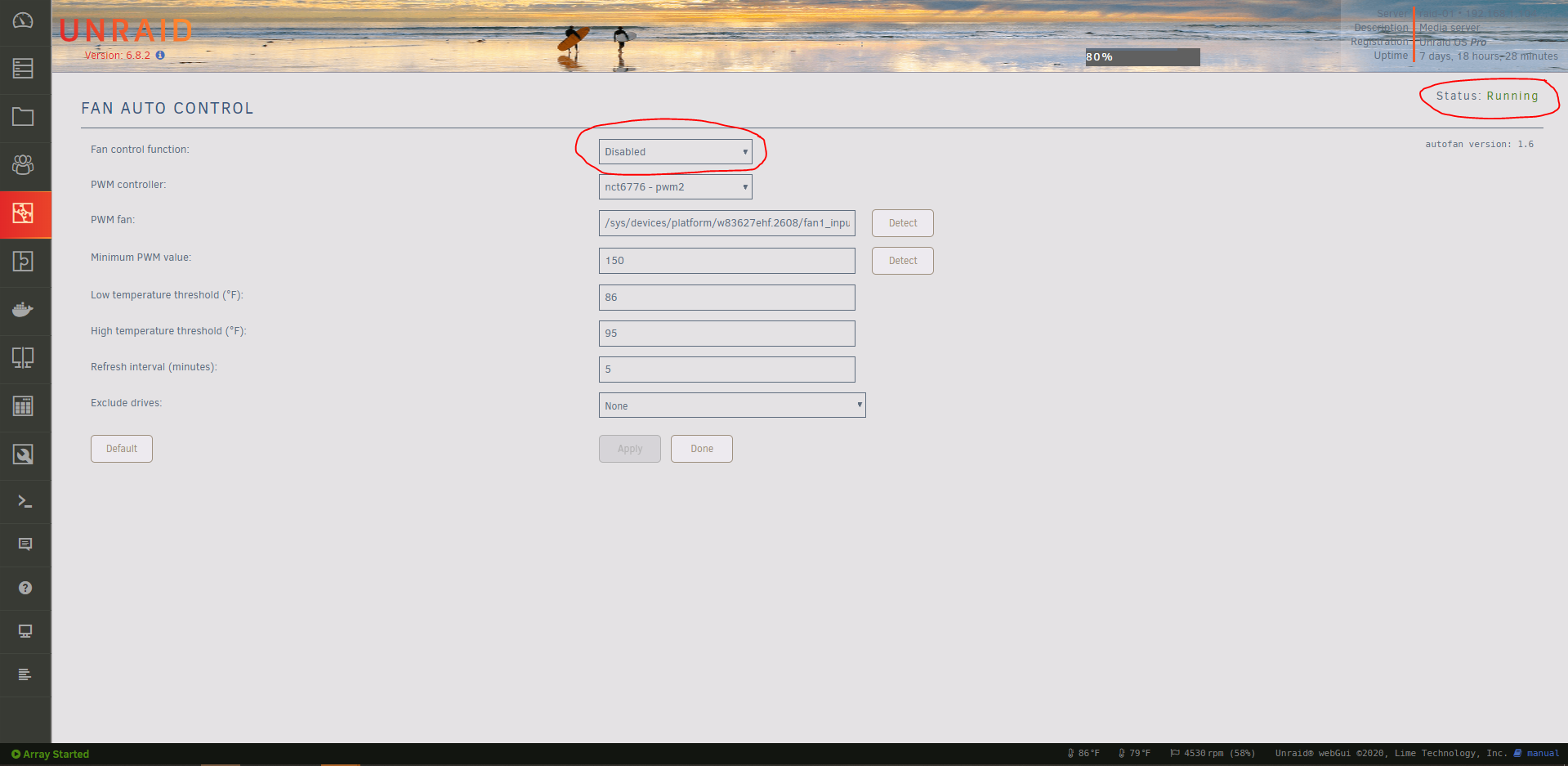

On 4/6/2020 at 2:40 PM, Tom3 said:
Dynamix System Temp - update seems to have display issue.
Previous Dynamix System Temp worked fine, displayed correct values. Updated to 2020.03.31 and now the motherboard temperature displays as infinty symbol
(wow, that's really hot).  The Processor temperature still displays correctly.  Unraid 6.8.3
Attached is a screen clipping of just the bottom right part of the display.
-- Tom

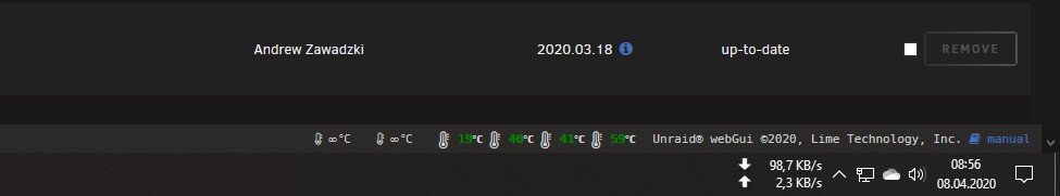

Same here.
unRAID 6.8.3. Just updated plugins and it behaves like on my screenshot ie. infinity temp.

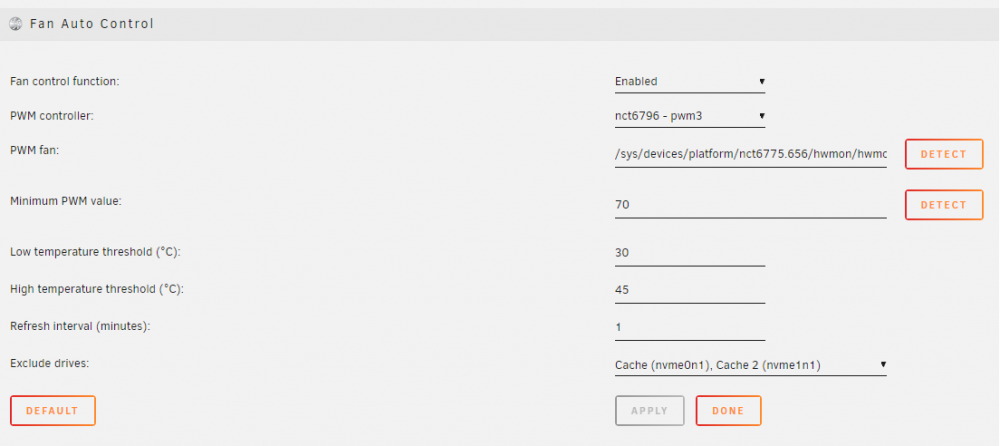

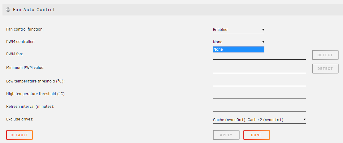

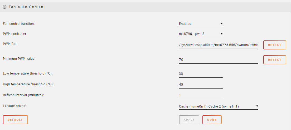

Auto Fan Control stopped working on Asus Z390M-PLUS (NCT6796D / NCT6798D) when upgrading to 6.8.x
I built my third UnRAID server last summer running with version 6.7.1. Out of the box most sensors were not detected (eg. the fan speeds), only temperatures were. After a quite a bit of reading in this thread and else where I managed to understand that I needed to manually load the correct driver module with command "modprobe nct6775" which I also put to my go file to make it persist over boot. Everything was fine from sensors perspective and Auto fan control was working pretty nicely (except for the nvme exclusion issue).
I recently discovered that the Auto Fan Control had stopped working at some point. It's been several months since I updated to 6.8.x but I suspect it stopped working at that point. I've made zero changes to core/plugin settings in between, only adding/changing dockers.
Any help is well appreciated. This is a really long post but it is mostly debugging info for the devs. It could well be that this will be solved when moving to 5.x kernal with Unraid 6.9.
This is how it shows in the UI comparing 6.7.x and 6.8.3. I took the 6.7.x screenshot last summer when I got it working. Unfortunately I did not take notes about the results of "sensors" or "sensors-detect" outputs or any other debugging I did back then.
6.7.x Fan Auto Control UI
6.8.3 Fan Auto Control UI
Same here except I have a SuperMicro X9SRL-F and am on Unraid 6.8.2 and the bad behavior started after updating dynamix.system.autofan from the previously working 2017.10.15 version.
It's worth noting I saw and reported this kind of behavior before last year.  In those cases it seemed to be related to changes in Unraid (6.7.0)
Either way none of the reports here were acknowledged.  See posts 1, 2, 3, 4
Same as before I am reverting to unraid-fan-speed.sh called from the User Scripts plugin.

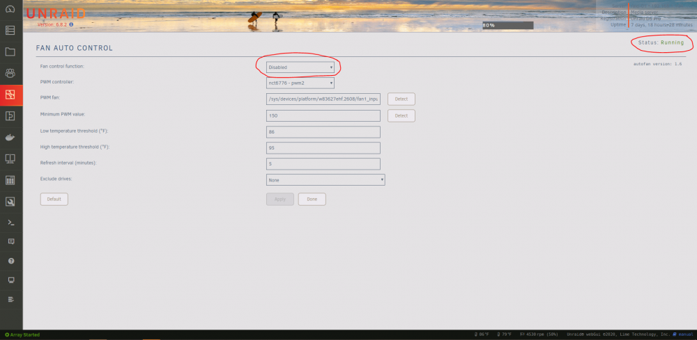

The best and most helpful write up I found implementing unraid-fan-speed.sh from another user also noting the broken Dynamix System AutoFan, is here.
One additional oddity in behavior with dynamix.system.autofan 1.6 on my system is that after entering a stopped state I set the plugin to disabled and sometime after that the plugin state changed to running again.
Edited by dabl
I have a ASUS Z170 PRO GAMING and cant see any status of my new PWM fans. I've changed the fans in BIOS from DC to PWM.
I've run sensors-detect and also tried with https://github.com/lm-sensors/lm-sensors/blob/master/prog/detect/sensors-detect
I've added modprobe coretemp and modeprobe nct6775 to the "go"-file. Still nothing :(. Ideas?
root@Tower:~# pwmconfig
# pwmconfig version 3.6.0
/usr/sbin/pwmconfig: There are no pwm-capable sensor modules installed
EDIT. Unraid 6.8.3
Edited by Daggr
On 4/12/2020 at 9:15 AM, bonienl said:
I made a new version available with the correction, please update and retest.
Works like a champ! Thank you very much.
