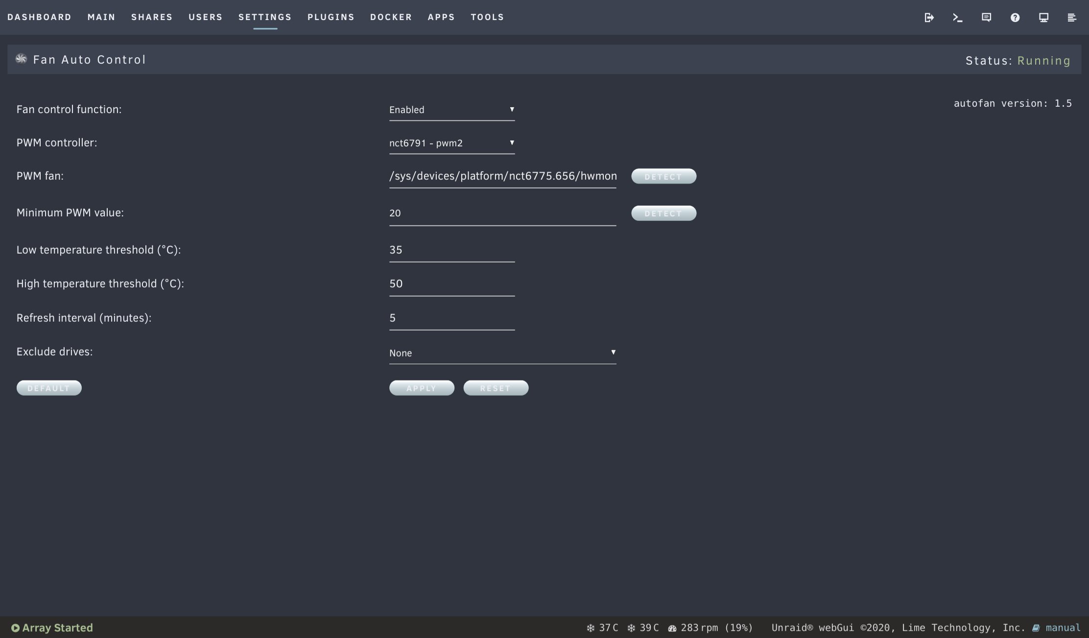

Having trouble with AutoFan 1.5 (UnRaid 6.8.2) the only option for PWM controller is 'none', and the 'detect' buttons do nothing.
My Asus X570-Plus has 6 pwm fan ports, and I am only using two (the CPU for the cpu fan and CPU-OPT which is connected to a fan hub powering the front 6 drive bay fans). Everything looks fine in bios.
I really want to control the speed of this fan hub based on the temp of the drives if that's possible...
Any ideas?

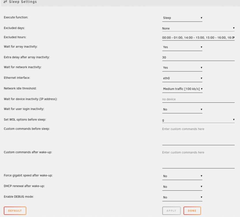

Hello,
I have installed S3 Sleep a while ago (almost 2 months now) and my Unraid never went to sleep as far as I know. My config plugin config is in the attached screen. I also have running duckdns and OpenVPN docker container (I think that might be the problem?). No idea, to be honest, but I would like to use the sleep mode (it consumes around 75 Watts).
Also I am wondering if its possible to wake it up over VPN or at all? But I doubt it.

Just a quick question, I am wanting to know how I can adjust my PWM fans on my AIO to coincide with CPU temp? It looks as though it’s tied to hard drive temp but I have very quite 140mm noctua fans running at 100% for my drives so they’re always cool. I am trying Auto Fan from Dynamix but I don’t think it’s working properly as in the fan speed does not increase with cpu temp.
As you can see my AIO noctua fans are running in the 200rpm range lol. Is Auto Fan purely tied to HDD temp? And if so is there any plugin tha.t will make fans work via CPU TEMP? Or unRaid is not capable of this so I’m stuck with BIOS Q-fan instead?

On 2/4/2020 at 1:06 PM, Healadin said:
Hello,
The sleep plugin is know for being defunctional for quite some people since the last update nearly two years ago.
You could give this a try:
Edited by darkside40
firstly sorry, I thought I answered you already.
Thanks for response. I tried to comment out those three lines and change the condition, then put it back into .txz file (zipped it and then with xz I turned it into .txz). Sadly, I haven't found what to change in that .plg file and it doesn't show version 3.0.6.1. (added it into commentaries at the top of s3_sleep file).
File that you attached to that post is no longer available, so if you could upload it for me again it would be great :) .
Thanks once again for respoding, I already though it wouldn't get answer.
You must calculate the MD5 hash of the new txz and add edit that in the plg. Than reboot your server and you should use the edited script.
Btw i can download the attache file without any issues.
maybe noob question but how do I calculate it?
oh its just md5sum command on linux? that should be easy then
ok, now there is no longer even sleep button... so I guess it is safe to assume, it would not work for me right? :/
