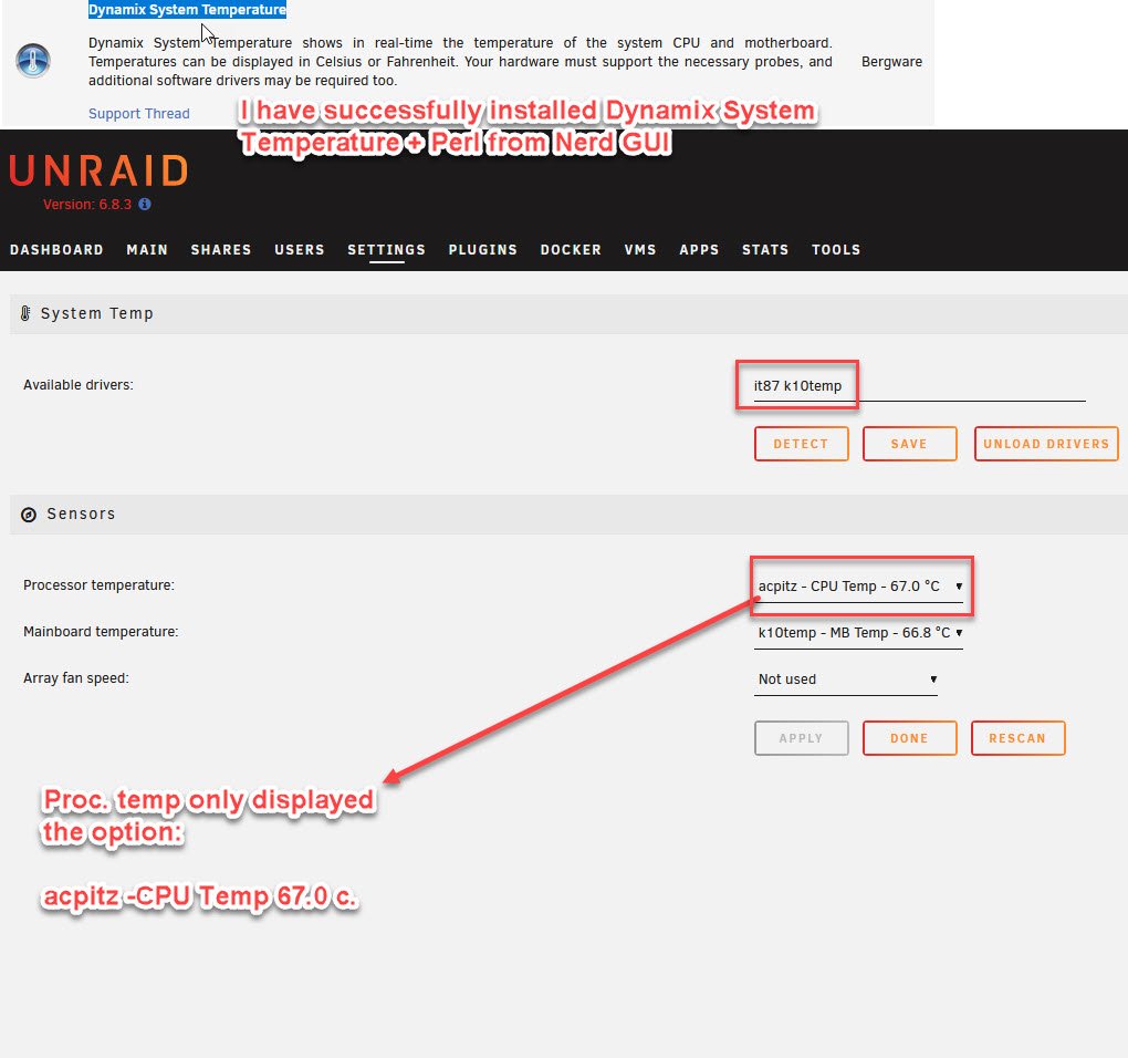

I am just wondering does the k10temp drivers working properly?
The only selectable option for my proc. temp. is: acpitz
Not k10temp.
Thank you.

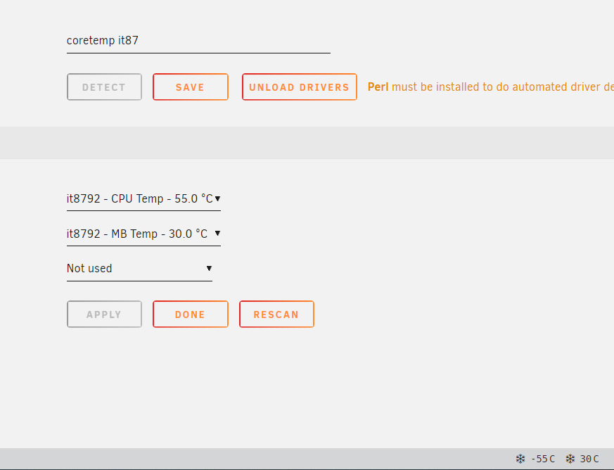

I'm having trouble with the fan speed controller (I guess?) on one of my unraid servers.
I have a Z10PE-D16 WS motherboard in that case and in the System Temp plugin I find "coretemp" and "nct6775" drivers.
I get the sensors for the processor and the mainboard, but at Array fan speed I only have "Not used".
I've googled the issue and searched this forum up and down, but can't seem to figure this thing out.
I'm really bad at stuff like this and I'm guessing I'm the root cause of the problem somehow.
Does anyone have any idea of what I'm doing wrong?
As an result I cannot use unraid to control the fan speed inside the chassi.
Any help would really be appreciated!!

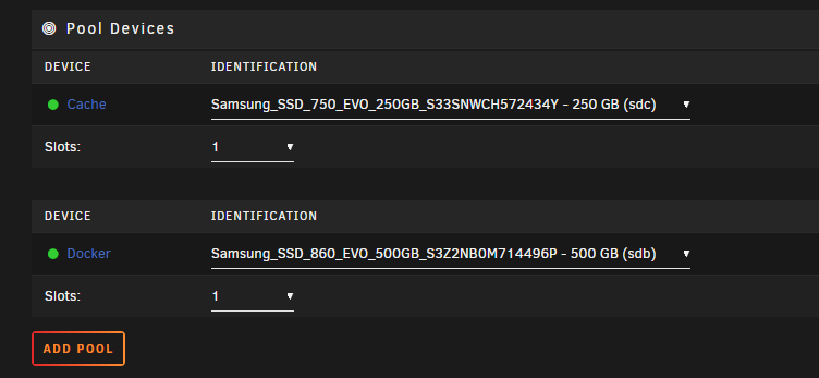

- Multi cache pool support
- Multi-language support
The implementation in the plugins is made such that backward compatibility is in place, this means the plugins keep running on your existing version of Unraid, eventhough it doesn't have the new features of Unraid 6.9. It is always recommended to use the latest version of Unraid, but you are not forced to do so when updating the Dynamix plugins.
Once Unraid 6.9 becomes available, it will automatically make use of the new features, prepared in the plugins.
Go ahead and enjoy the updated Dynamix plugins suite.
