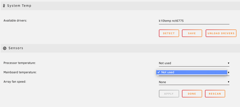

Hi all, System Temp doesn't seem to have drivers for my motherboard's temperature sensors (Gigabyte Z390 M Gaming - ITE IT8688E). Here's the "sensor-detect" output:
Here's the "sensors" output:
I set ACPI Temp 2 as MB Temp, but I have no idea if that's correct. I in fact have no idea what those 2 ACPI tempeatures are. The motherboard has 6 thermal sensors and 4 fan headers:
Furthermore, under "Array Fan Speed" in Dynamix System Temp, I'm not able to select anything at all.
Any help would be appreciated.
I found a workaround:
Specifically, this part at the end:
Fan Speed Sensors and PWM Controllers: See warning below!
You can already see your CPU temp (Tctl) using the k10temp driver with Dynamix System Temperature. If you want to see Fan Speeds on your dashboard, or use the Dynamix Auto Fan Control plugin, we can force the it87 driver to load for the it8628 on this board. To force this we need to set another boot flag, "acpi_enforce_resources=lax". Add this the same way as above, after "video=efifb:off". That line in your syslinux.cfg should now read "append initrd=/bzroot video=efifb:off acpi_enforce_resources=lax".
Next, add the following line to /boot/config/go
modprobe it87 force_id=0x8628
The it87 driver will now load on boot and your fan speeds will be displayed on the Unraid dashboard, and the fan controllers will be available in Dynamix Auto Fan Control.
Warning: Setting acpi_enforce_resources to lax is considered risky for reasons explained here.
Of course I didn't need the "video=efifb:off" part, so I just added "acpi_enforce_resources=lax" to my /boot/syslinux/syslinux.cfg, then "modprobe it87 force_id=0x8628" to my /boot/config/go. A little risky (see link above), but otherwise seems to be working well so far. Will monitor it for any instability. Just want to share my findings in case someone else finds this post later.

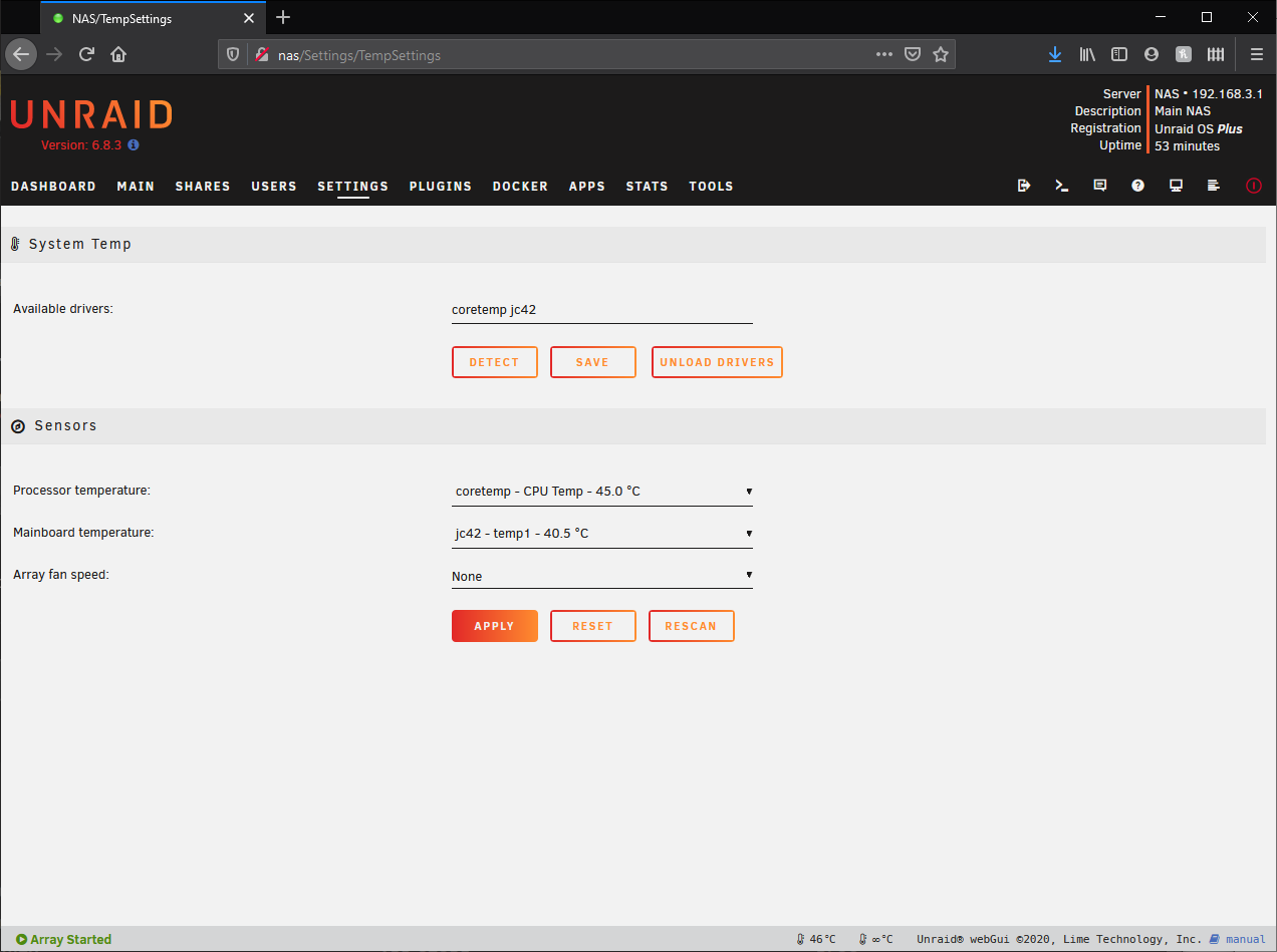

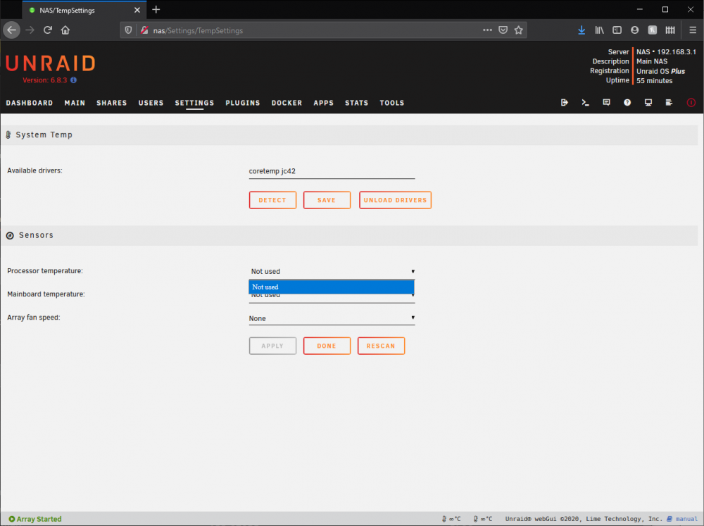

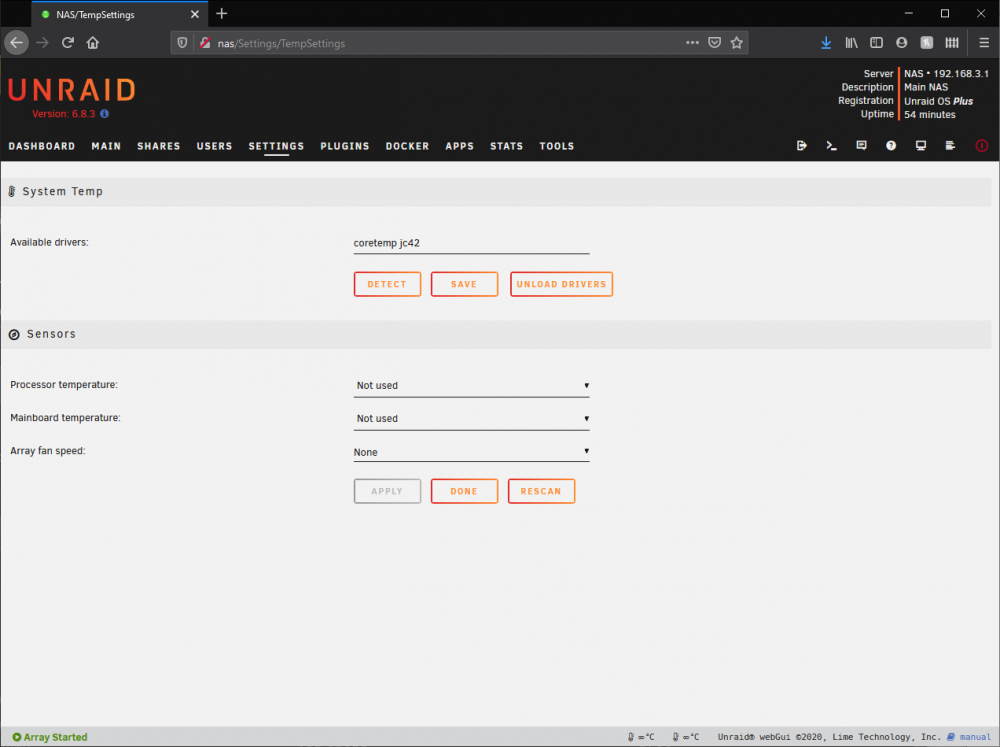

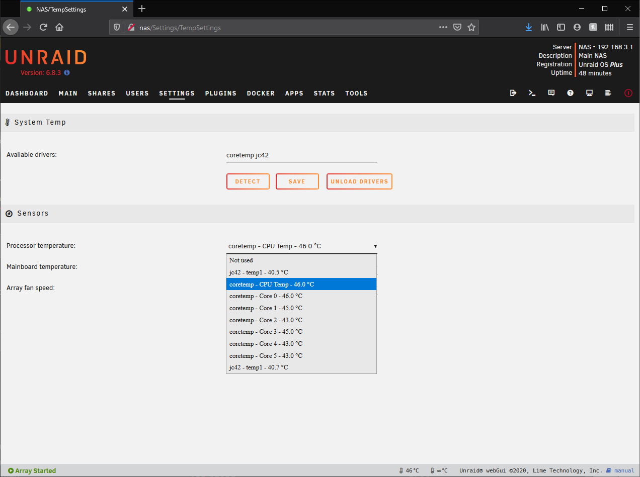

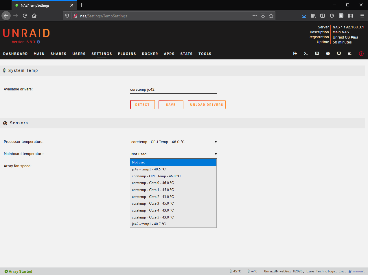

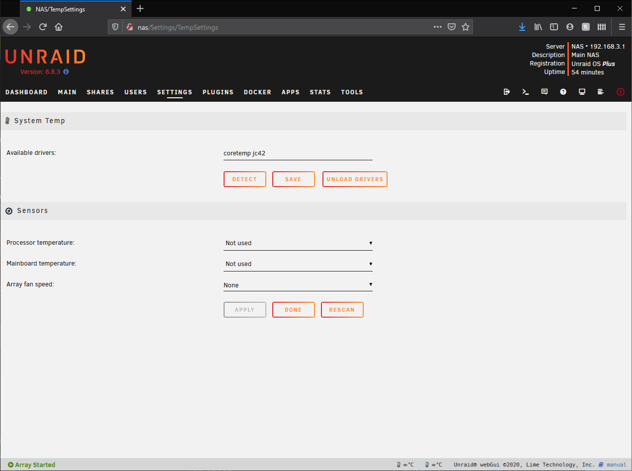

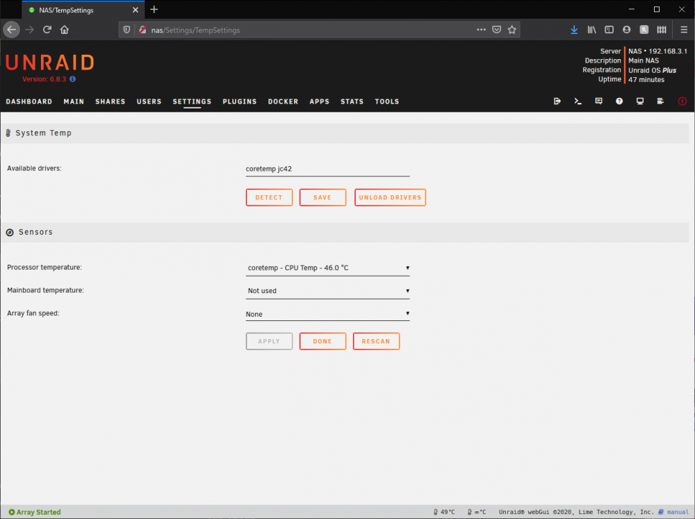

Hi all,
I've got some problems with the "Dynamix System Temperature"-plugin. I don't know if it is already a known problem (didn't read the thread). 😅
First of all, I want to thank for all these nice Dynamix plug-ins: Thank you for the nice plug-ins!
Secondly, if it helps, l this is my config:
  • Motherboard: ASRock Z370M Pro4
  • CPU: Intel Core i7-8700T (previously i3-8350K, but had same problem)
  • Ram: 4x 4GB DDR4
  • Cache: 2x 256GB m.2 nvme SSD
  • Storage: 3x 8TB

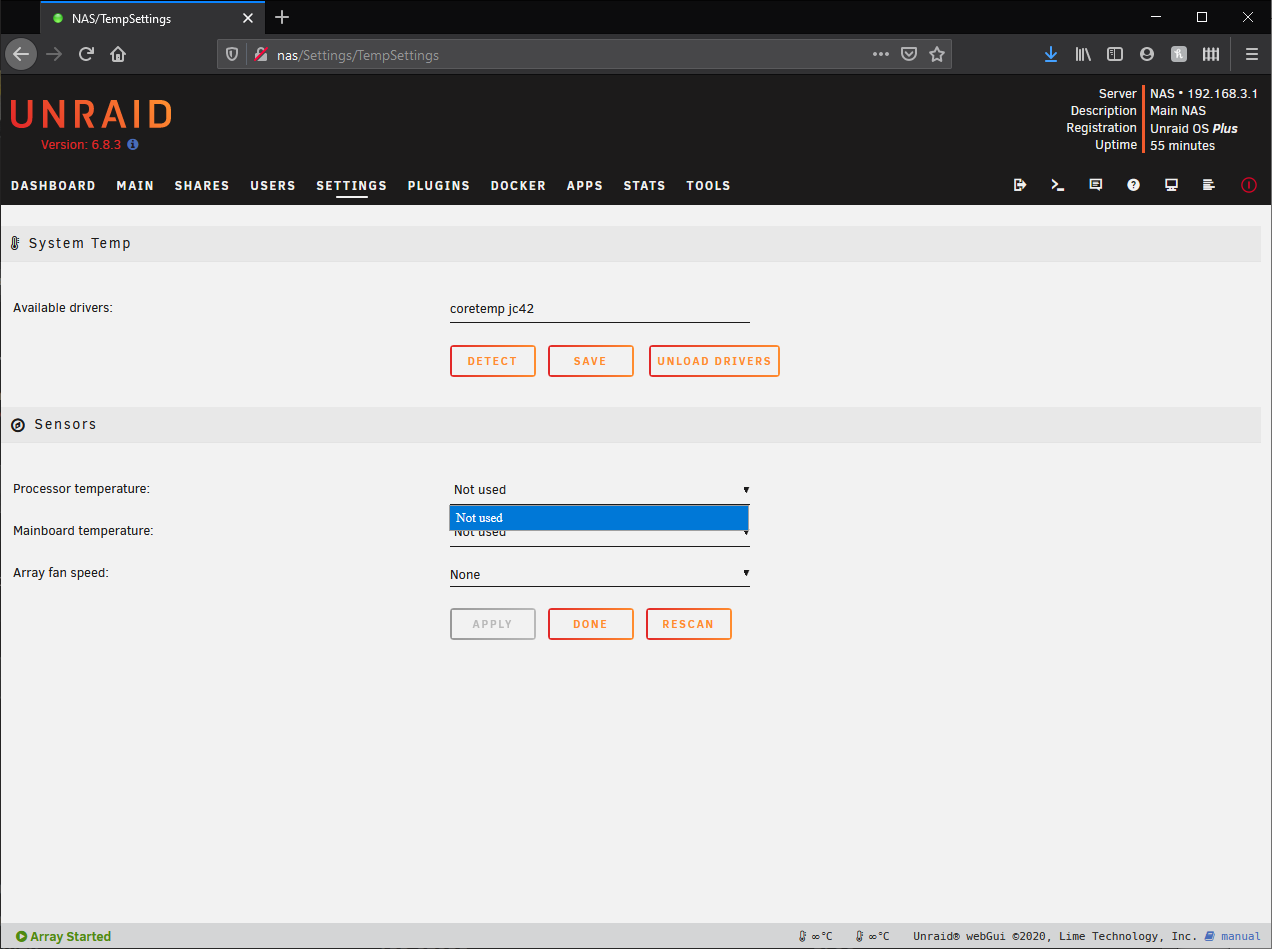

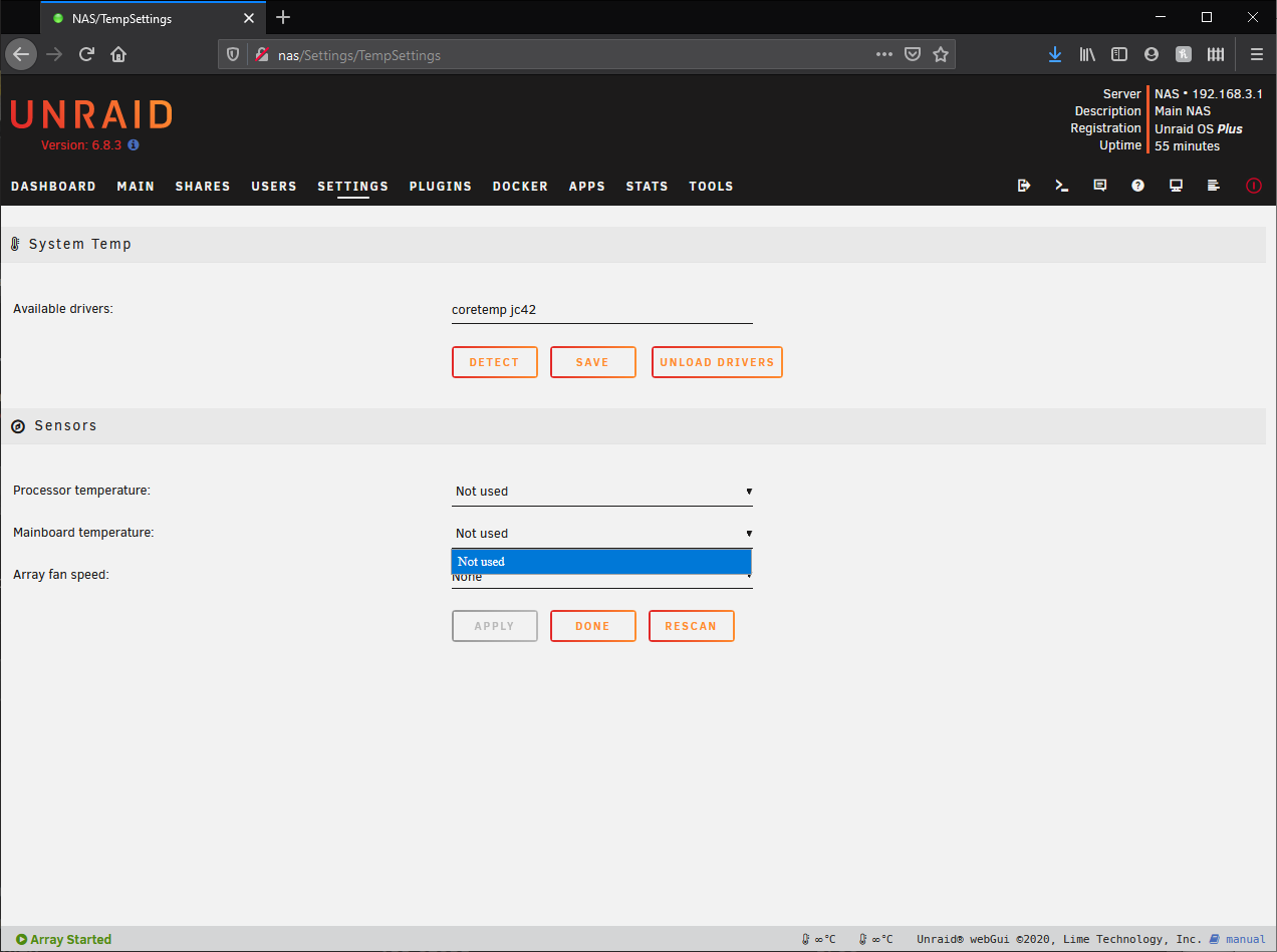

The problem is that the app doesn't want to show the motherboard-temps after applying them. If I first select only the cpu it works. I can see it everywhere (Mainboard, bottom info bar,...).
If I try to load the motherboard temperature, I can see the temperature before applying. When I apply: I can't see any temperatures anymore (cfr. all pictures in attachment).
 If I want to get it working again, I have to delete the plugin, reboot, reïnstall and hope it works. (If doesn't work, I have to try to reïnstall it again untill the motherboard temps work again.)
Could I have a script in the background ruining the plugin?
Is there a solution to the problem?

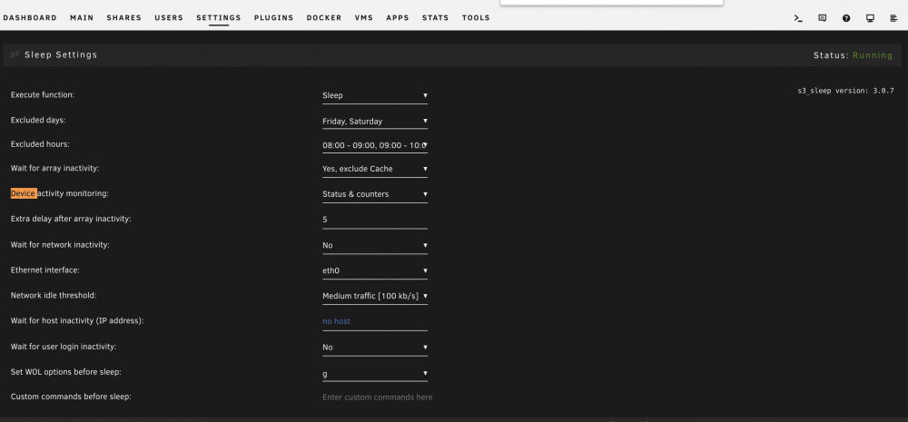

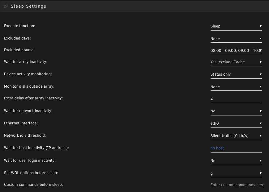

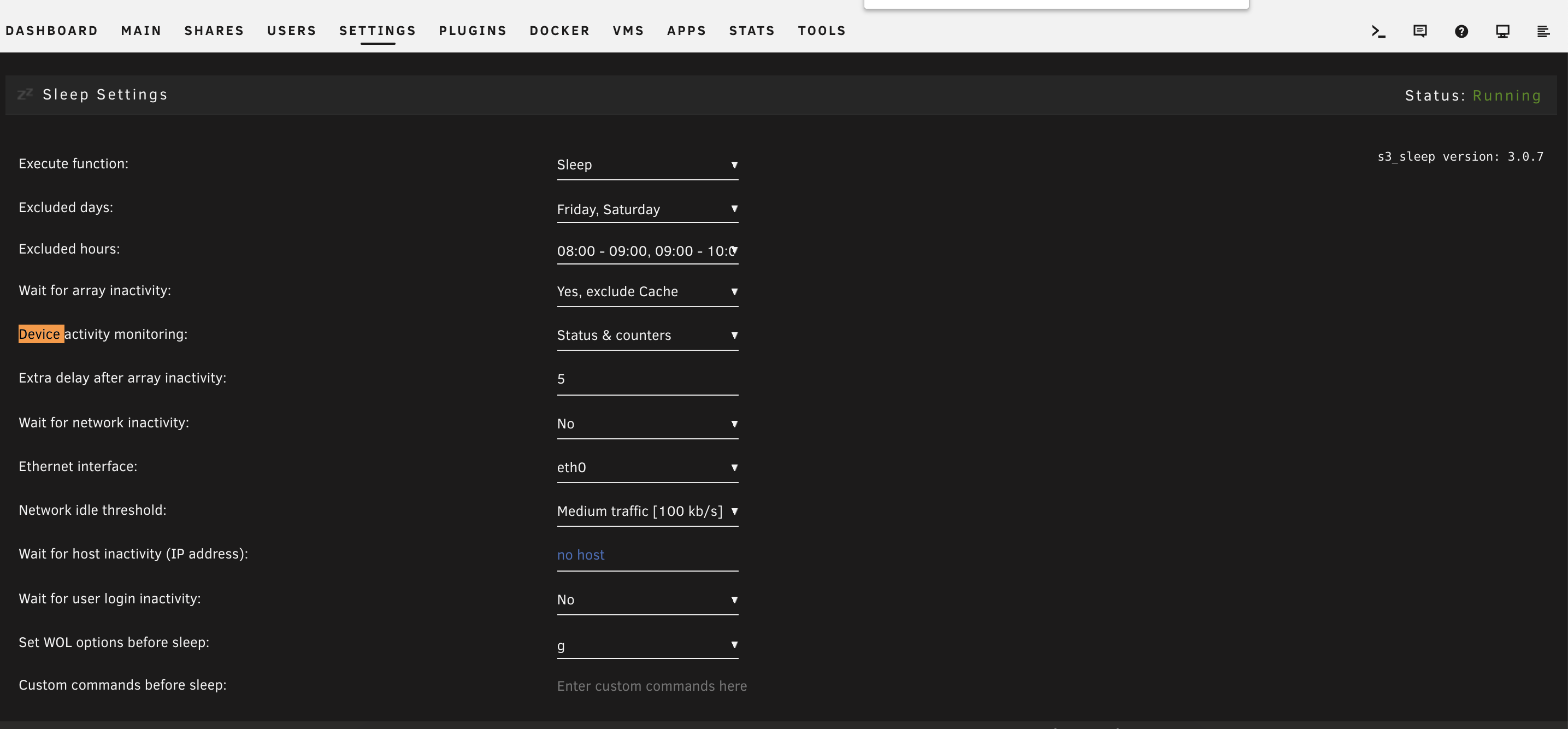

I've installed and configured the dynamix s3 sleep plugin according to the Space Invader tutorial. It does not seem to put my system to sleep at the given time and days. When I activate sleep mode directly from the array operations (which also uses S3 Sleep) it works fine.
Attached a screenshot of my current settings. The plugin status that it is "Running".
Anyone a clue how to fix this?

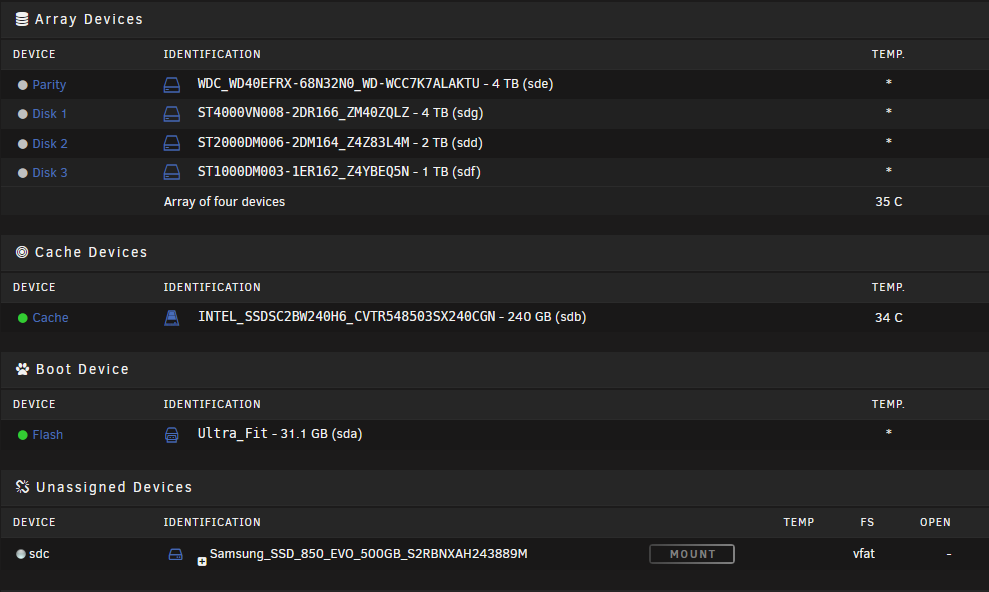

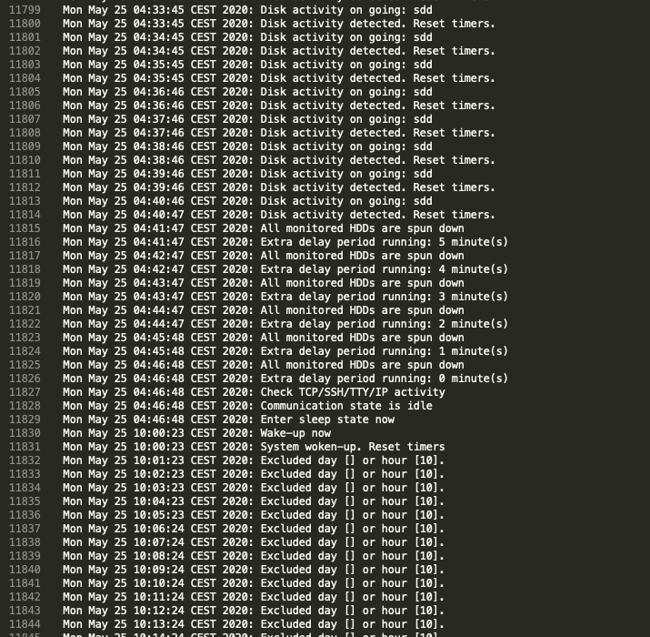

@bonienl After some days of testing, I'm completly lost.
I set a global spin down AND to be sure - for every disk of my array as well.
As you can see in the screenshot (made only a couple of minutes before going to bed and before the sleep time) all drives are spun down.
But my server won't go to sleep ... and to make it even more cryptic - on one day it worked fine.
I attached the debug log as well - on 19th of May it went to sleep with the exact configuration. (dockers [only on cache drive] are running and spun down is set up)
But after that day - no sleep.
Today as I wake up (8am) - the webgui of unraid even showed all drives spun down - but also no sleep in the night or even now dispite the set for sleep from 00:00 to 10:00am. How is this possible?
Is there any way to see exactly what keeps the drive sdd  (as mentioned in the debug log) spin up?
Thank you for your help.

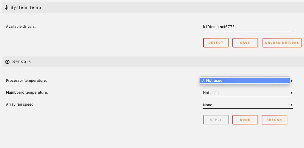

My setup is a Asus Prime X570-Pro with a Ryzen 9 3900x
Im trying to get the board and CPU temp to show.
Thnx in advance.

I was able to get mine to work by inputting the following in my go file:
modprobe nct6775 force_id=0xd120
Hopefully this works for you!

In the night from sunday to monday it went to sleep from 04:43 to 10:00. (see screenshot attached)
Again it doesnt work correctly - because it should be go to sleep at around 00:01 due to my settings.
And in the night from monday to today it completely ignored my settings again. 😡
Sorry for this (maybe) provocative question - but Is that plugin just simply unstable and/or unRaid not able to set the correct status of the hdd and I have to deal with it.
I just ask because in over 25 years I never got such problems on ANY other device or OS setting up such a basic function like sleep.
Windows goes to sleep, macOS goes to sleep, Playstation goes to sleep, QNAP /Synology goes to sleep - only unRaid cant handle such a basic thing?
I even reduced the settings to make it as simple as possible. Just by time and activity. (see screenshot attached)
No setup to network devices or something - but even this dont work.
It can't be any user driven activity - because I'm always the last one going to bed - no one is doing anything in my network because everybody is sleeping.
It's very frustrating to fail on this nobrainer (for at least it just works on any other hardware/OS)
But the information "Disk activity on going: sdd" is useless if there is no hint what causes this.

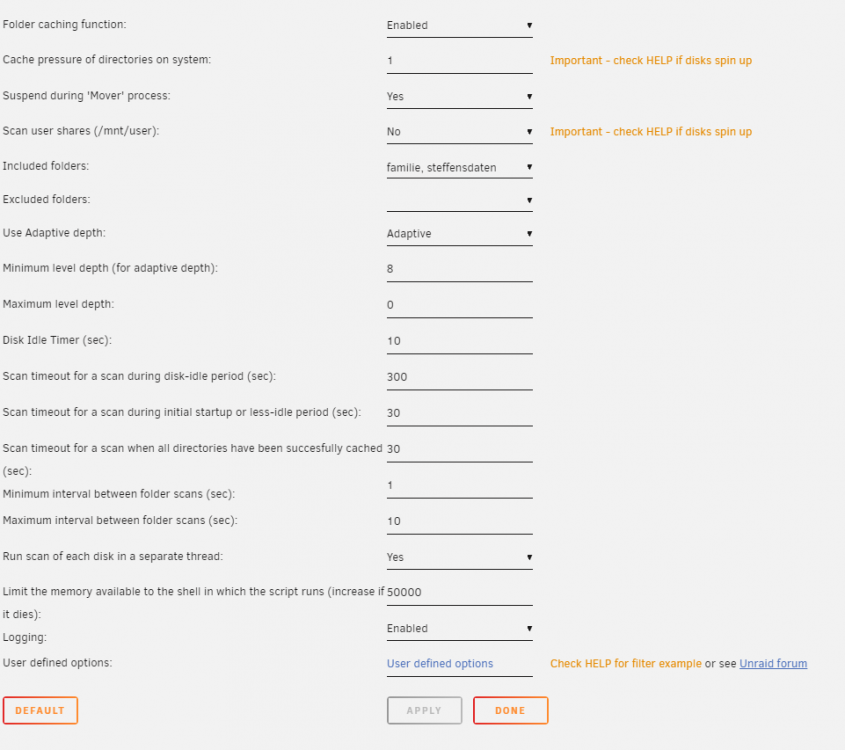

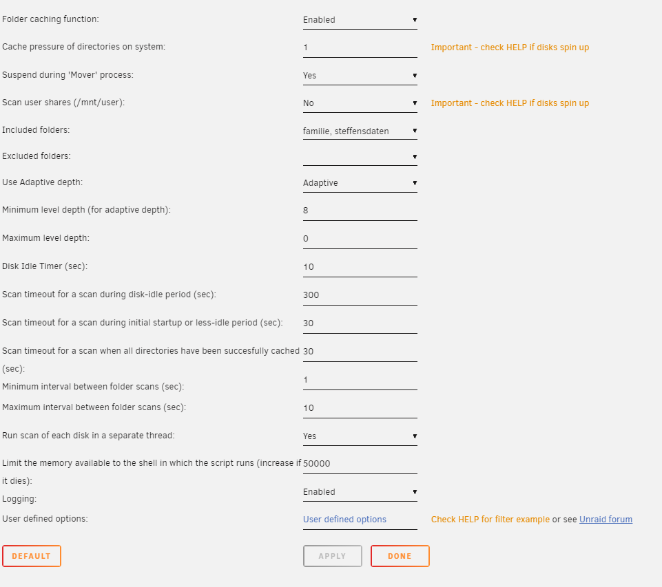

i installed the Folder Caching app but somehow it wont work. It does nothing^^
Do i have to change anything? I wanna only cache the Stuff from the two shares. My disks are never spinning down. Like i set them up. As far as i read this app should help too, if i search in a folder for some files. Like file names with the artist in it.
For example in the mainfolder for the musik in the share "familie" i want all tracks with the name "%george%". Normal filesearch in windows with the folderexplorer. But the cache wont cache at all and so it takes up to a minute to get all results. To slow....

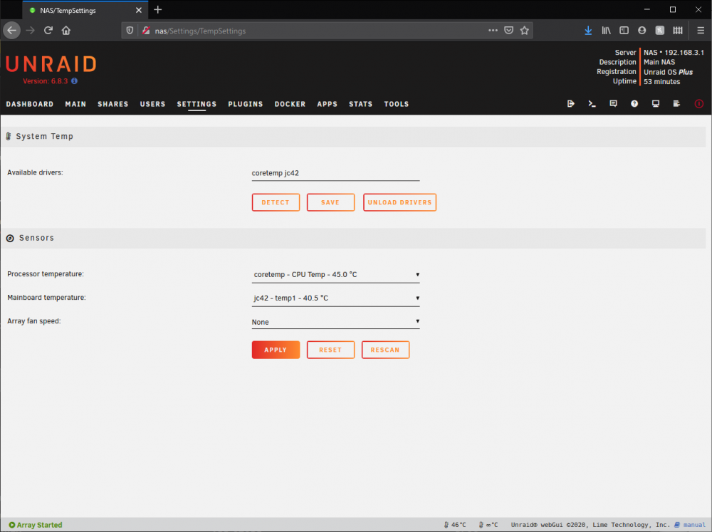

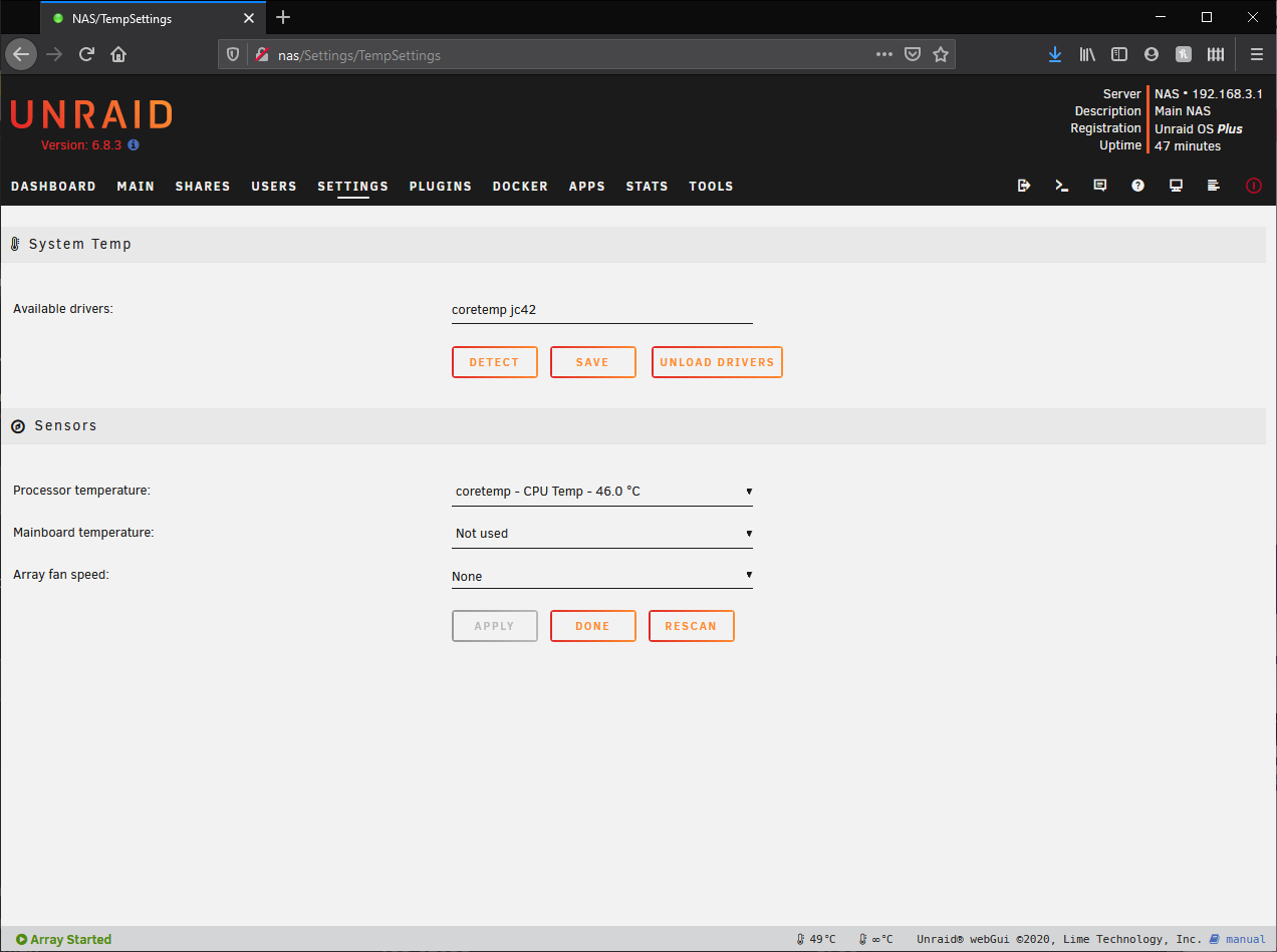

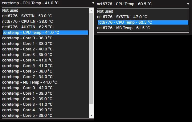

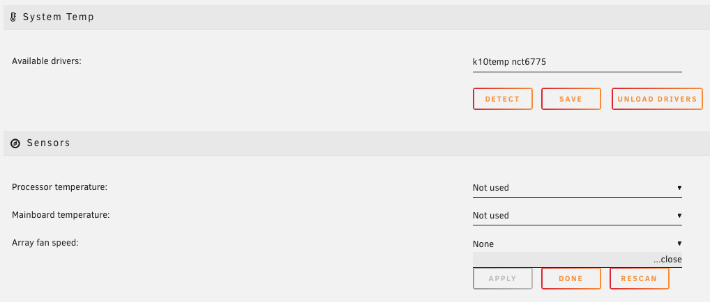

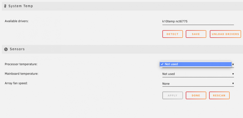

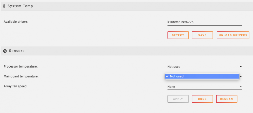

Hi all,
I am having a similar issue with the temp plug-in. However, it doesn't seem to detect anything. I'm assuming that I need enter this in my "go file" as instruction by tansmith88. Only problem, I have no idea what the "go file" is. While having a temp of infinity is neat, I'd like to know the actual temp. Pics attached of my situation.

Hey...Sorry for the late response. I had used this blog to help figure out how to get it working on my end. Let me know if you have any questions.
https://kmwoley.com/blog/controlling-case-fans-based-on-hard-drive-temperature/

@bonienl can you please help me? It seems that no one other than you can solve it.
Your addon keeps telling me about disk activity - but there is none?
As you can see HERE or HERE the WebGui shows all drives spun down, but your plugin seems to not recordnize it correctly.
I also installed the "file activity plugin" for more informations, but that also sees no disk activity.
Thank you very much.
Edited by Maddeen
Have you tried different settings of "Device activity monitoring"?
Status check is a hardware check, but may not work with all disk types.
Counters check is a software check, and can be used as alternative
Edited by bonienl
@bonienl - it seems that this does the trick for me. (see log)
I'll validate this within the next days to be sure that my server is going to sleep reliably and will give an update here.
If I can validate this, it would be nice (for others) if you extend your help description of the parameter "Device activity monitoring" with a short note, that in case of troubles users should try "counters only".
Thanks again - update follows.

Jun 4th -> going to sleep at 00:03 - wake up at 10:00 - verified ✔️
Jun 5th -> going to sleep at 00:03 - wake up at 10:00 - verified ✔️
Jun 6th -> going to sleep at 00:03 - wake up at 09:50 due to manual WOL - verified ✔️
Jun 7th ->  going to sleep at 00:03 - wake up at 10:00 - verified ✔️
Jun 8th -> going to sleep at 00:03 - wake up at 10:00 - verified ✔️
@bonienl - as you can see in my updates, I happily can verify that changing the setting to "counters only" is the solution.
So it appreciatly you can change the help note and add the information that changing to counters only will solve problems with the sleep
Thanks and have a nice day.
Edited by Maddeen
update verification
Is there anyway for Dynamix System Temp to monitor dual Xeon CPUs? In the System Temp menu under "Processor Temperature" I see all 24 cores and the "CPU Temp".  I tried to change the "Mainboard Temperature" to read one of the Cores off the second CPU but after clicking apply it always reverts back to the "MB Temp"--which makes sense in a way but is annoying.
Is there a way to add a second "Processor Temperature" so I can see the temps on both CPUs?
I did a search and did not find any solutions.  Sounds like it was added as a request back in 2017 but no word on implementation.

Side note I made the mistake of re-detecting my driver tonight, and lost all temp reading I was previously showing on my 32 cores.  Now I can only select 1 of 3 options CPU/MB/SYSTIN
Currently runnig latest update, Attached a screen to show how it was compared to now.
