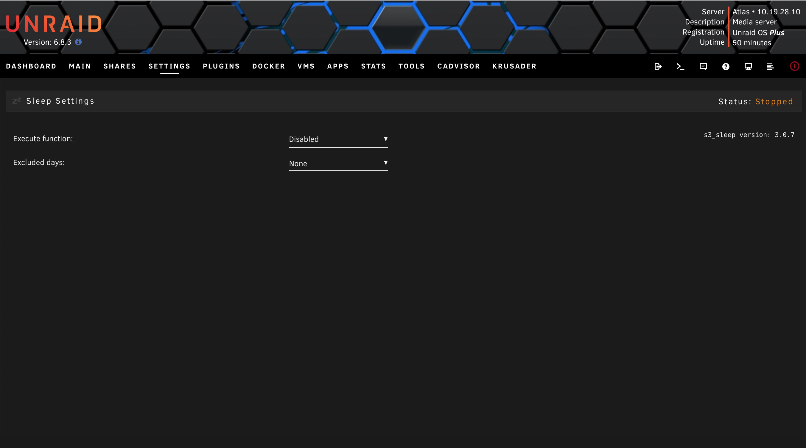

Hey, I'm new to Unraid, I've been using it for a month so far and since day one I've used the Dynamix plugins with no problem at all... until yesterday. Out of nowhere, without me touching the config at all, Dynamix S3 Sleep and System Statistics stopped working.
Suddenly, the server didn't go to sleep, as usual. When checking the config to see what was happening, I found this. As you can see, S3 Sleep config menu looks incomplete now, is not showing me the full set of options (the capture is after reinstalling the plugin, that's why status is shown as stopped. Before reinstalling the status was "active", but the menus were incomplete too):

As the whole Dynamix package has been updated these days, I've checked the rest of the plugins just in case, and I found that System Statistics is also not working. This time the config menu looks OK, but the Stats tab shows an error:

I've tried everything, restarting, deleting and reinstalling the plugins, etc... and nothing. Could this be related to the latest language support updates of these plugins?
I'd appreciate some light on this please.

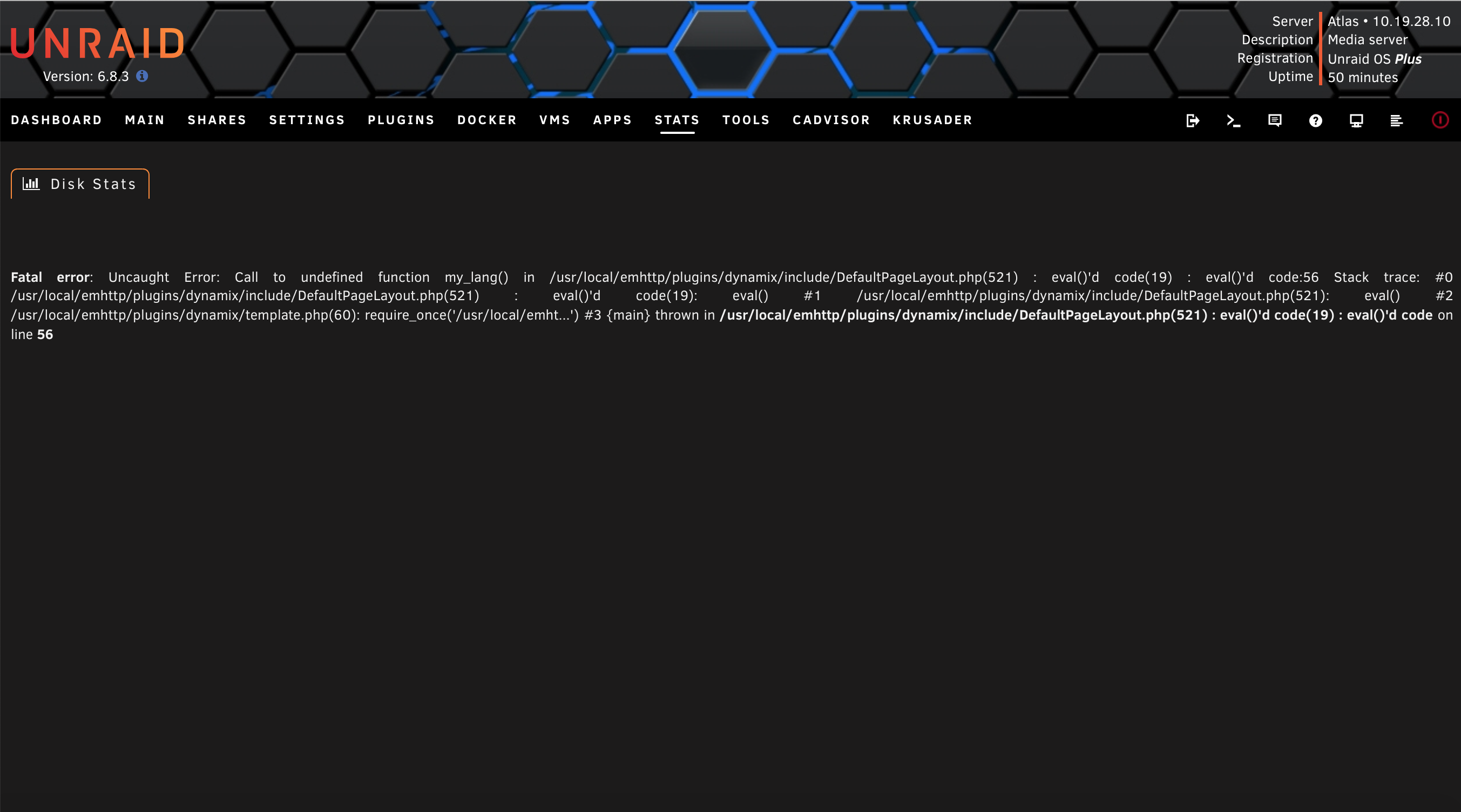

after update Dynamix System Stats to version 2020.06.20. I get on the Tab "Stats" the following error.
I use unraid 6.8.3.

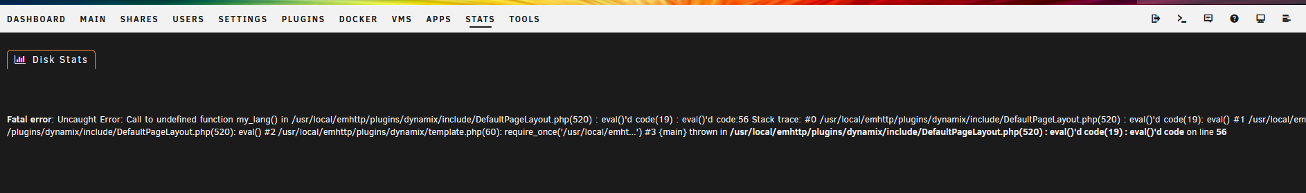

Fatal error: Uncaught Error: Call to undefined function my_lang() in /usr/local/emhttp/plugins/dynamix/include/DefaultPageLayout.php(520) : eval()'d code(19) : eval()'d code:56 Stack trace: #0 /usr/local/emhttp/plugins/dynamix/include/DefaultPageLayout.php(520) : eval()'d code(19): eval() #1 /usr/local/emhttp/plugins/dynamix/include/DefaultPageLayout.php(520): eval() #2 /usr/local/emhttp/plugins/dynamix/template.php(60): require_once('/usr/local/emht...') #3 {main} thrown in /usr/local/emhttp/plugins/dynamix/include/DefaultPageLayout.php(520) : eval()'d code(19) : eval()'d code on line 56
Edited by Thorsten
You found a bug, I need to correct that.

Would this bug be related to the other issues I'm suffering in S3 Sleep? S3 Sleep and System Stats started doing strange stuff pretty much at the same time.

Okay after i update this to version 2020.06.21 everthing works fine
Yes, several plugins have the same bug.
I have made an update for all affected plugins. Please update.

Updated, it's working again. Thanks for the quick fix.

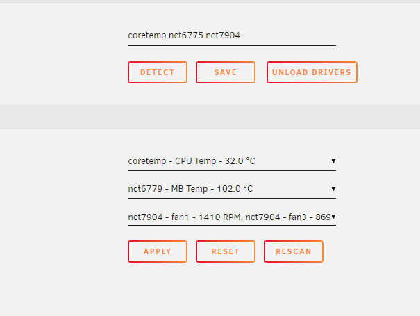

I may have found a reason why we are all having issues with the not being able to see the system temps anymore.

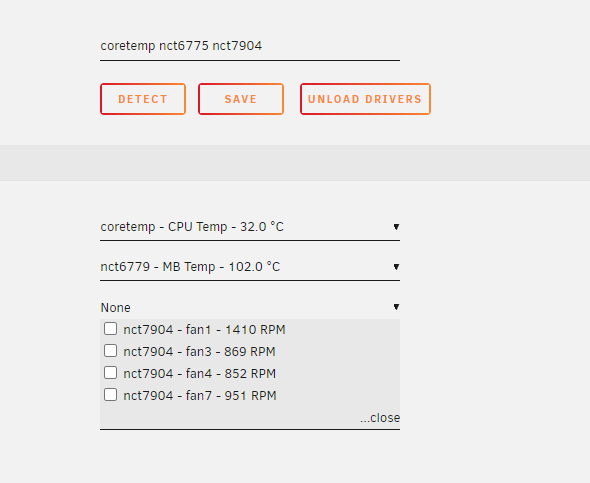

so I make changes from '0-2d' to '02d', thereby removing the minus char.
I go back into settings>system temp and it now shows me all the settings!!!!!
I choose all the fans, HOWEVER... when I click on APPLY.  The page reloads and the temperature settings have reset and NOTHING shows and the sensors file is reset to show references to '0-2d' - argh!
BUT.... If I do all the above and NOT click on APPY', the cpu and motherboard temps NOW show up in UNRAID.
