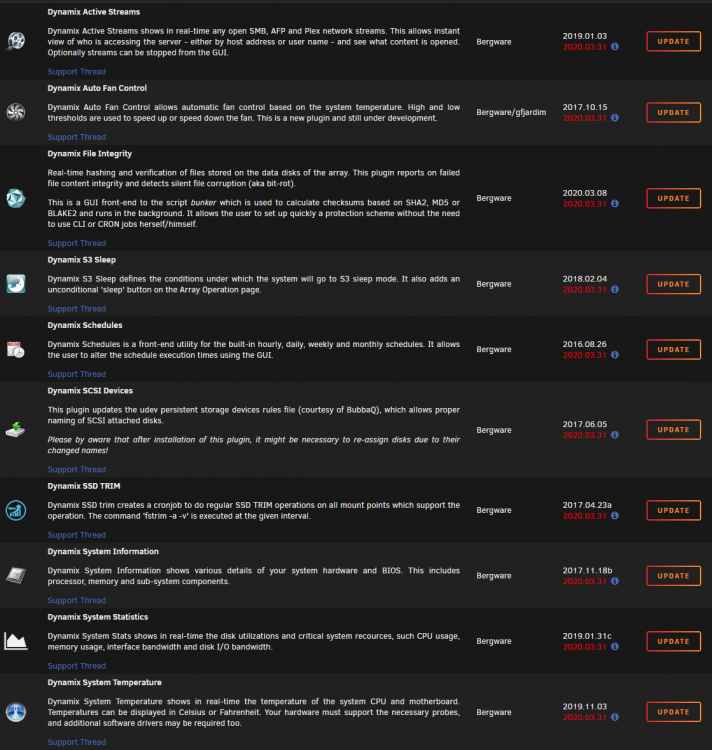

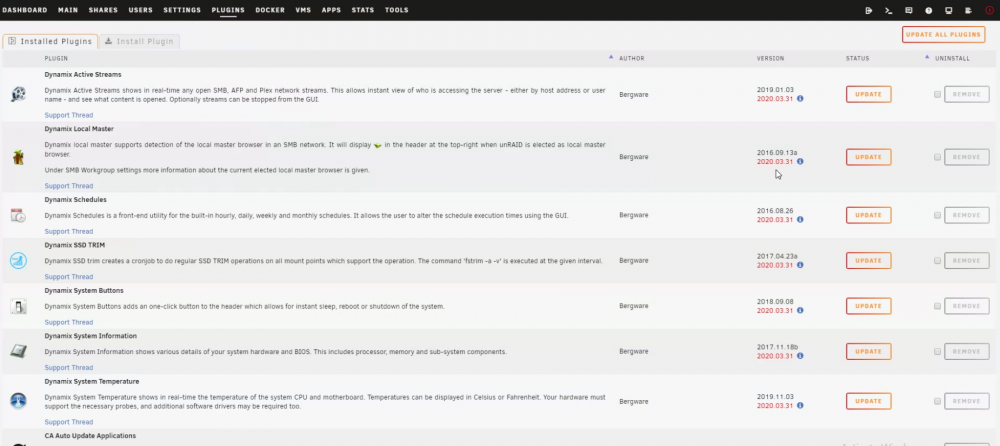

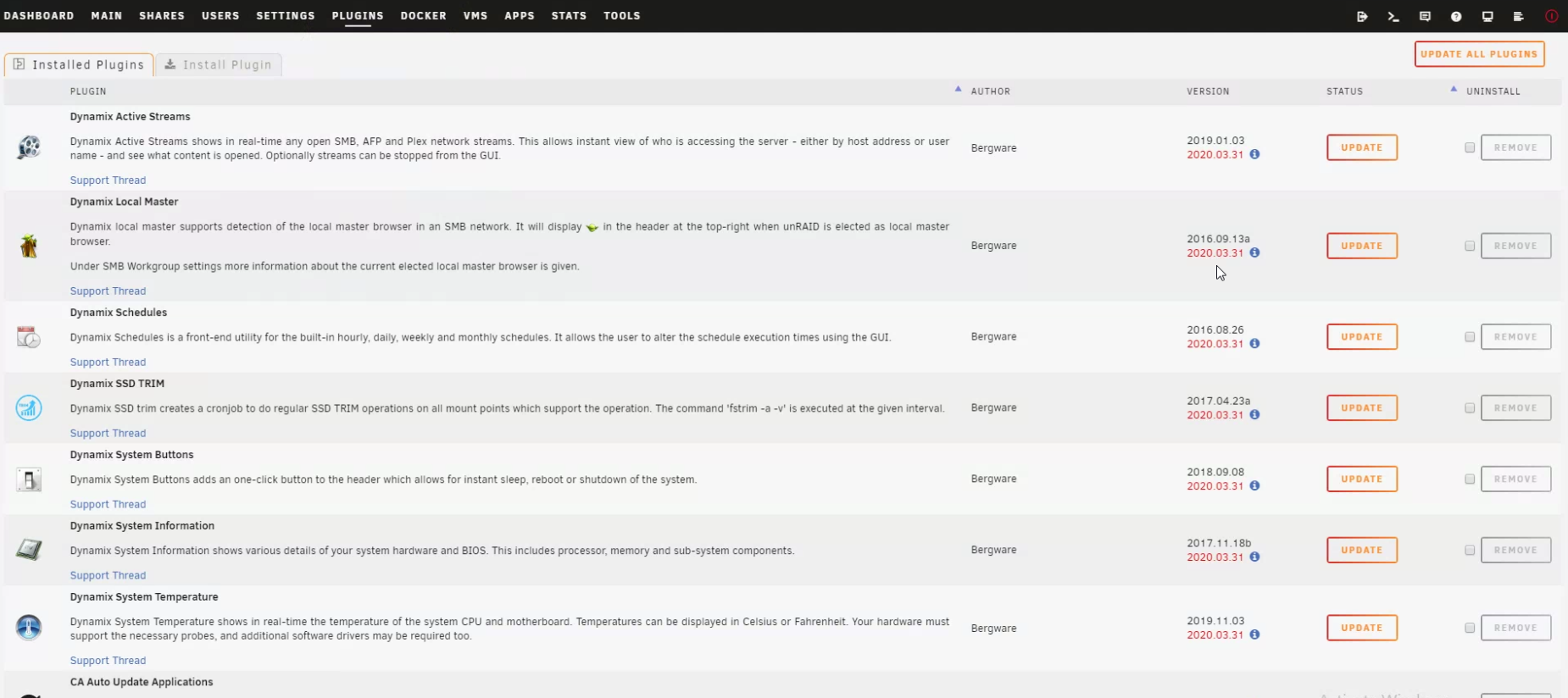

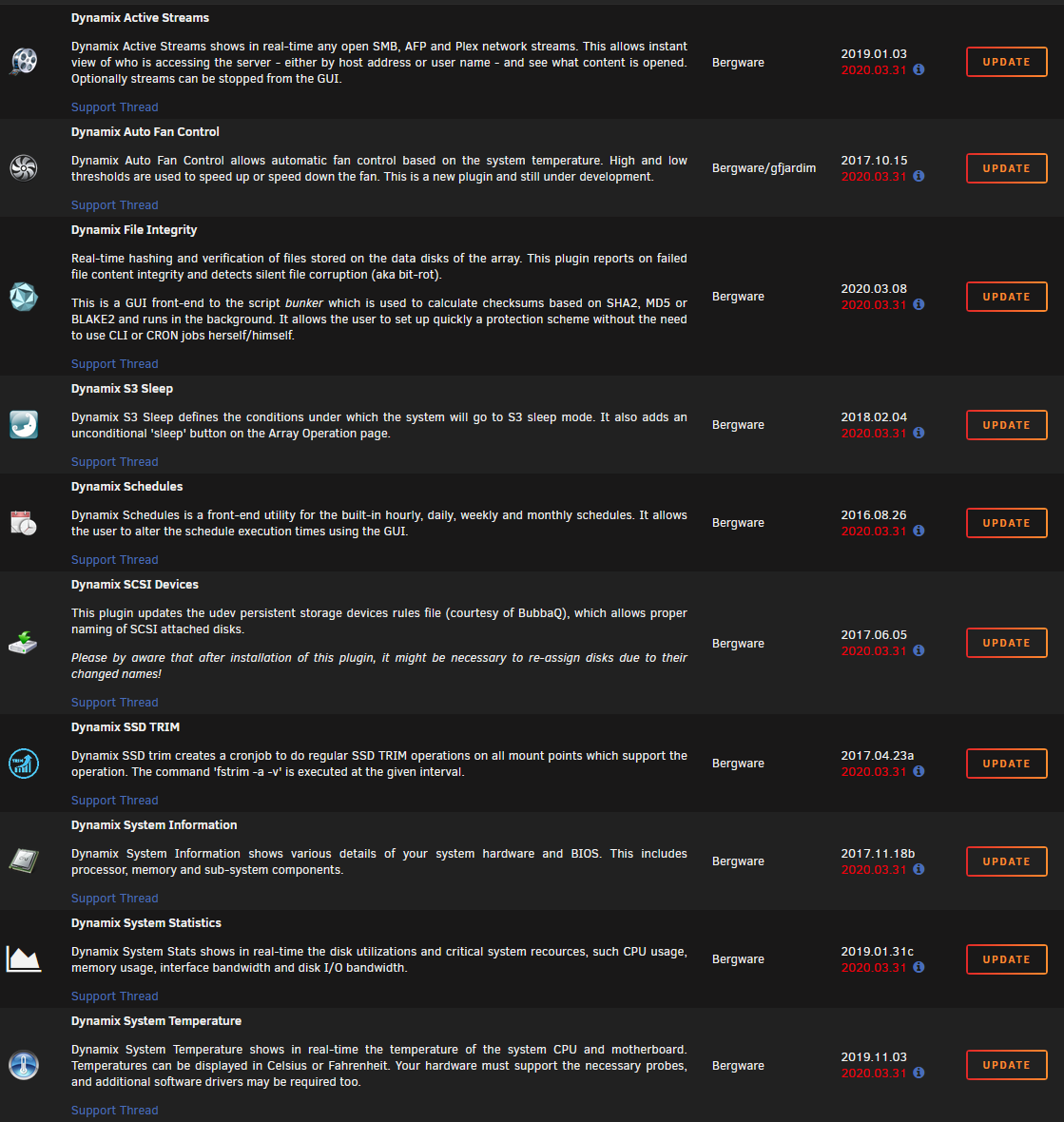

  • Today has been a productive day   I have updated several Dynamix plugins, mainly bug fixes. Please check your plugins to get the updates.
Kinda weird to routinely check your plugin page for maybe one or two updates and apply them. But than you see this
First i though maybe it's a late april's fool by one of the devs, you never know 😂
After checking this forum and see the post from @bonienl I realised the update orgy is real. Thanks for the great work again.

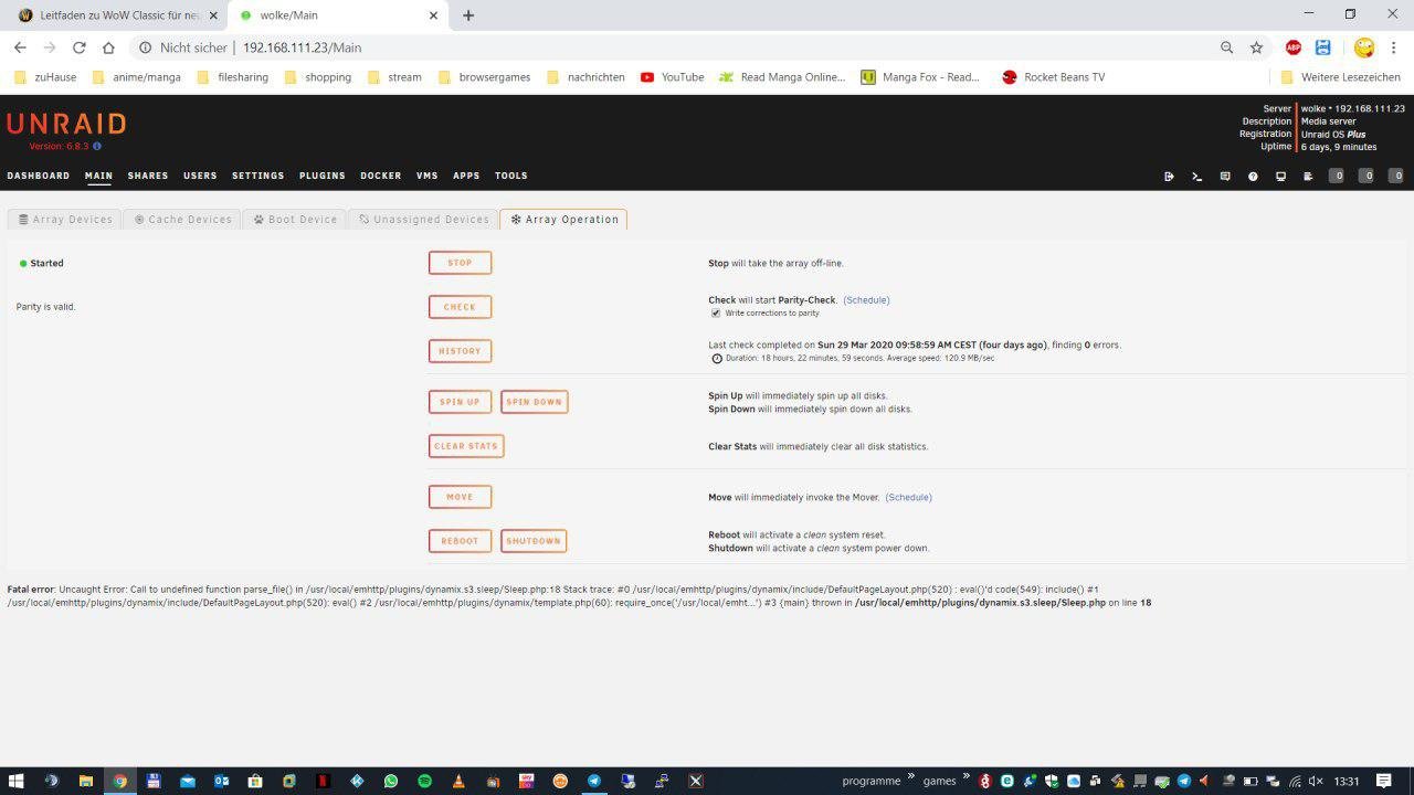

I am 65% of the way through the parity swap procedure, and when I went to the Array Operation tab to see the progress I had this error on that screen...
Fatal error: Uncaught Error: Call to undefined function parse_file() in /usr/local/emhttp/plugins/dynamix.s3.sleep/Sleep.php:18 Stack trace: #0 /usr/local/emhttp/plugins/dynamix/include/DefaultPageLayout.php(520) : eval()'d code(549): include() #1 /usr/local/emhttp/plugins/dynamix/include/DefaultPageLayout.php(520): eval() #2 /usr/local/emhttp/plugins/dynamix/template.php(60): require_once('/usr/local/emht...') #3 {main} thrown in /usr/local/emhttp/plugins/dynamix.s3.sleep/Sleep.php on line 18
I had just installed the preclear plugin through the community applications plugin, but have not started any preclear, or done anything else since installing the plugin.
I'm not sure this is a sleep plugin problem, I'm only reporting here because it's the only thing mentioned in the error.
It is S3-sleep plugin related, it is missing the compatibility functions needed for Unraid legacy support.
Did this error occur after you installed the preclear plugin?
Edited by bonienl

I have gfjardims preclear script install and dont have the error message regarding S3 Sleep.
Btw the Error Message which JustinChase posted is the same like in the screenshot i have posted.
