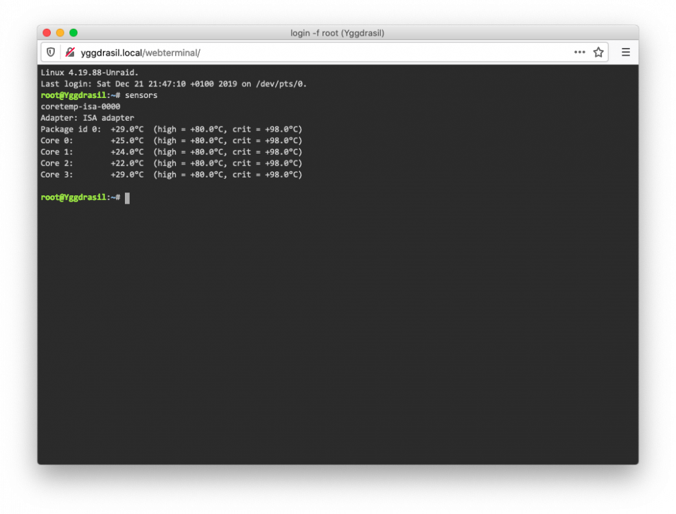

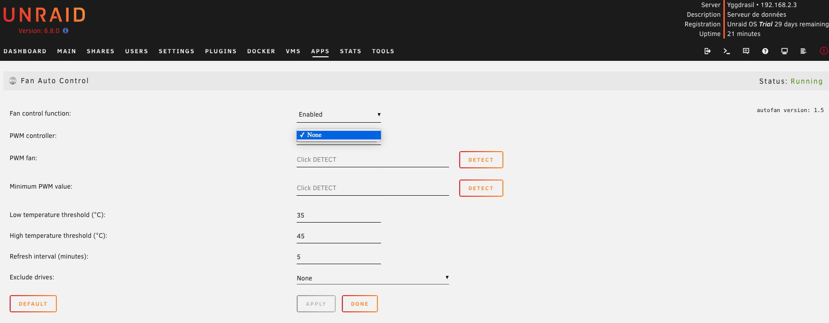

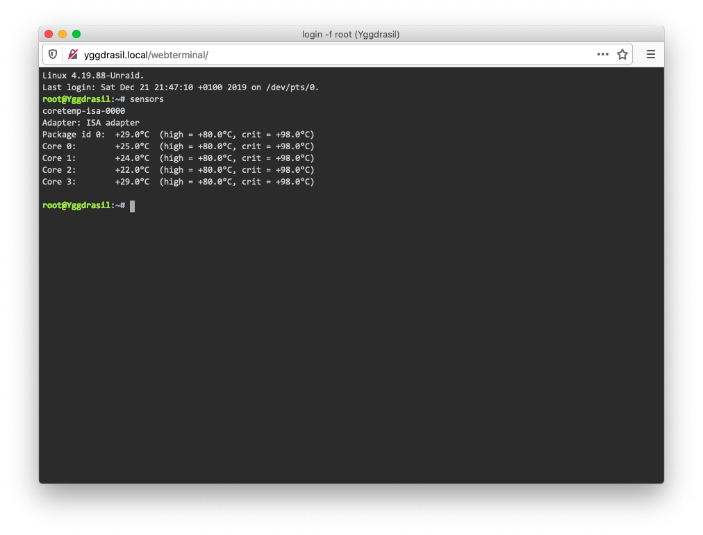

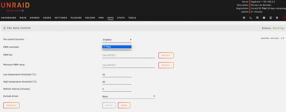

Hello everyone,
I have a Asus P8Z68-V LX motherboard. According to the specsheets, the motherboard uses PWM for fan control.
I installed Dynamix System Autofan, then IPMI, and finally try sensors-detect but i only see my CPU temp :
1943983667_Capturedecran2019-12-21a22_02_16.thumb.png.e74e2548bdad36621736113a43e320ff.png
I try to deactivate Q-Fan control in the bios and rescan everything.... But unraid still doesn't see PWM
810524022_Capturedecran2019-12-21a22_04_12.thumb.png.c5b9f8c4dcb55dbd02577cb15a6fb5a3.png
I ran out of ideas, did you have any advice for me ?
Thanks !

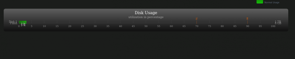

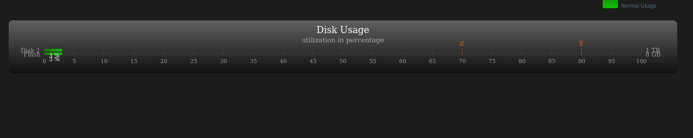

On 12/1/2014 at 12:40 AM, bonienl said:
System Stats
on my system running 6.8.0 system stats disk usage page looks like this.  my monitor is an NEC 2k.
Is it my monitor or is there a way to scale up the graphics?systemstatsoverlap.thumb.png.cf5c98cd0fbc043a5a891b73966ca772.png
