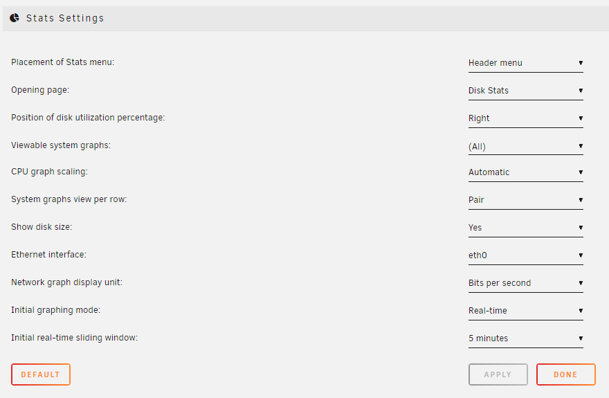

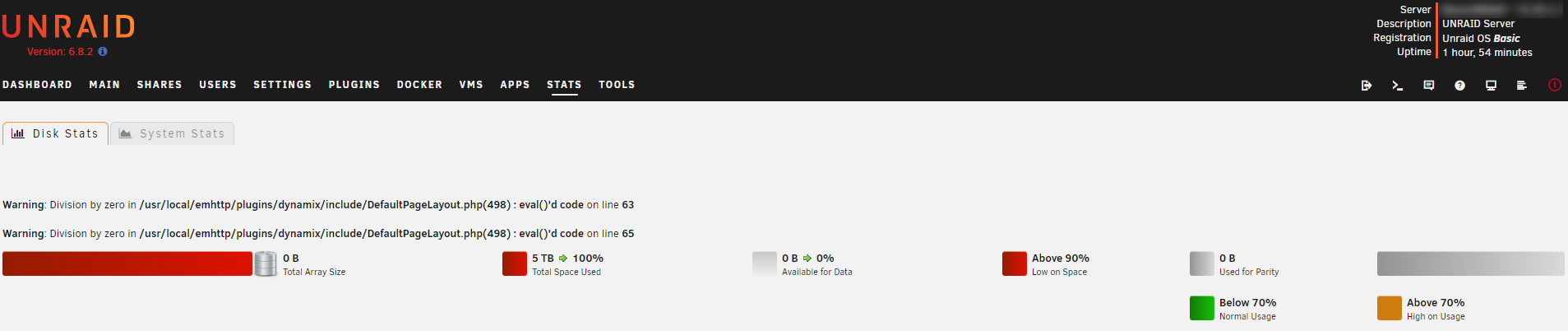

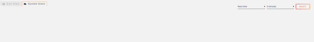

I have an issue with the system statistics.
It says this:
Warning: Division by zero in /usr/local/emhttp/plugins/dynamix/include/DefaultPageLayout.php(498) : eval()'d code on line 63
Warning: Division by zero in /usr/local/emhttp/plugins/dynamix/include/DefaultPageLayout.php(498) : eval()'d code on line 65

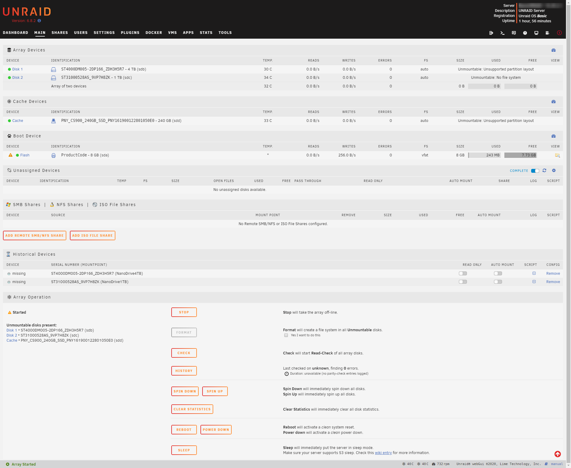

I'm completely new at unraid, so I don't know what you need to help me, so I've taken some screenshots of main, stats, and the settings in the plugin.
If you need anything else, let me know.

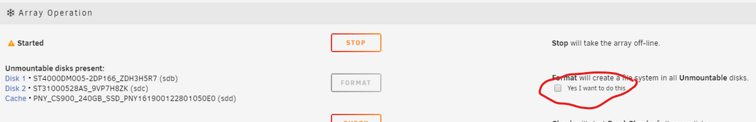

First thing, I would do is to format those two disks you have added to the array!  Since they are not formatted, you can see that the total 'Size' of the array is zero.  That 'Size' will be the denominator when calculating percentages.
In case, you are wondering how to format those disks, look below to see where to check and then click the 'Format' button.
I just did it. I realized I couldn't even use a docker, so I asked here on the forum about that as well.
Thank you. It works now.
Amazing people here!

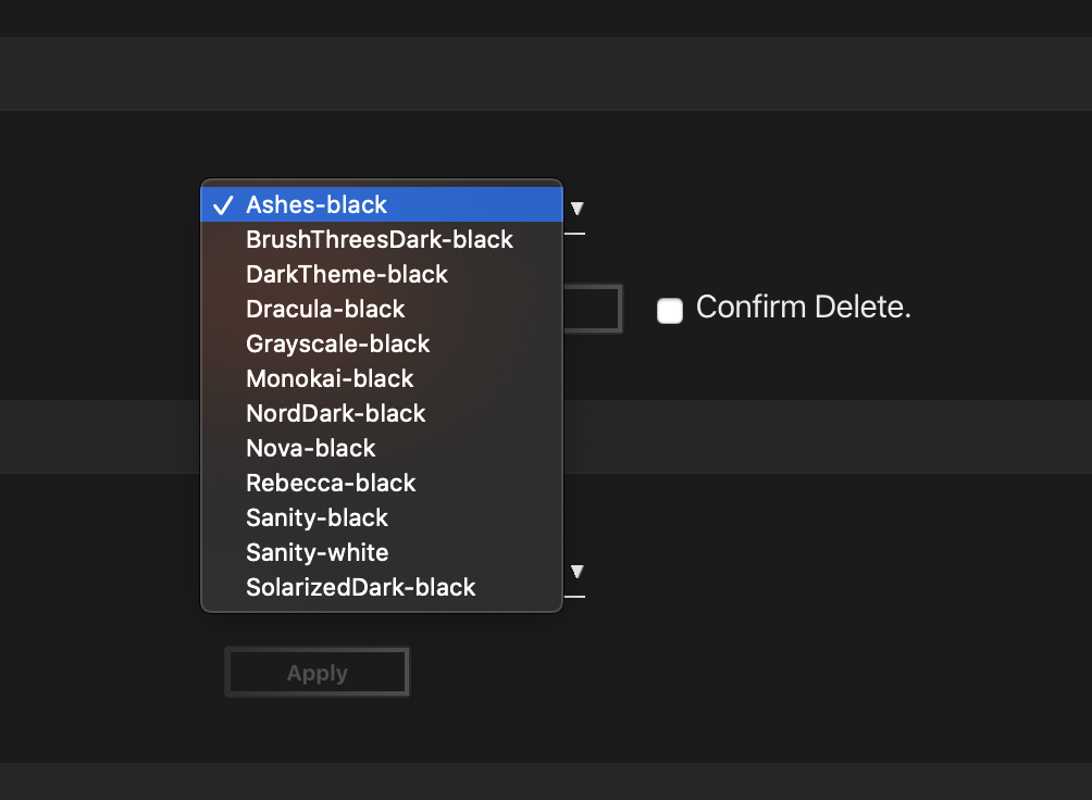

Any chance of getting the day/night plugin to work with custom saved themes?
I install Sanity Theme from Github Here after seeing a screenshot and link in Reddit and would love to set the white for day and black for night like this wonderful plug-in does
When a default theme store its style files as "default-<name>.css" and "dynamix-<name>.css", it will automatically appear as a choice

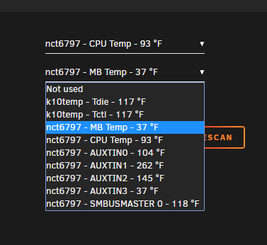

Anybody help with why these temps are so wonky...  262F ???
and why nct6797 is so different from k10temp ?
ok thanks ill reach out to the creator to see if they can update the names of the files. it does import to the Theme Engine Plugin
this is the file naming as it is is installing

here is it showing in Theme Engine
not sure they can do that without configuring it as a complete theme here is the original Reddit post I quoted you in it (hope thats ok), this one is a cfg file and a couple of 3kb .css files that basically tells Theme Engine how to configure it. so was basically wondering if Day/Night could be updated to support all the themes that can be imported and used in

Dont know F but its probably a sensor that isnt actually there that it shows

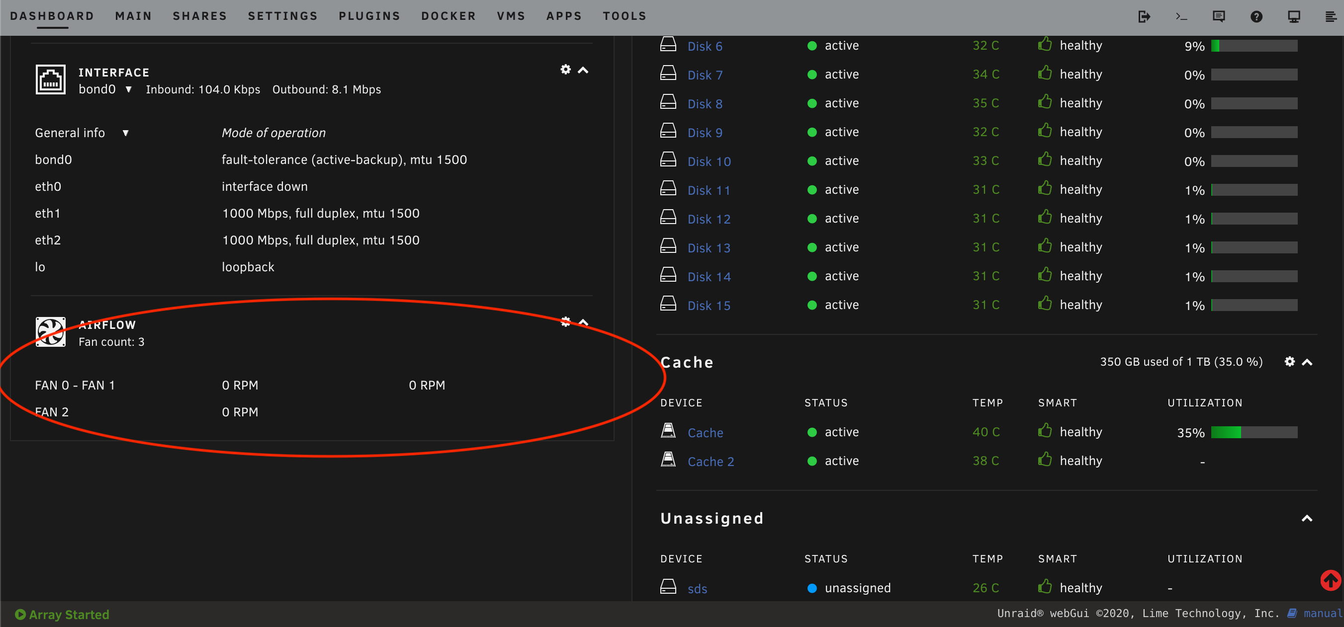

So, I added the Dynamix System Autofan plugin which added the Airflow section to my Dashboard.  Ultimately the plugin didn't work out for me so I removed it.  Now I have the Airflow section orphaned on my Dashboard.  How do I go about removing the Airflow?207034100_ScreenShot2020-03-12at8_59_47PM.thumb.png.1a193616618e048ae9d342610e3154ff.png
Have you tried rebooting?
Yes, I've uninstalled and rebooted.
Have you tried clearing browser cache?
