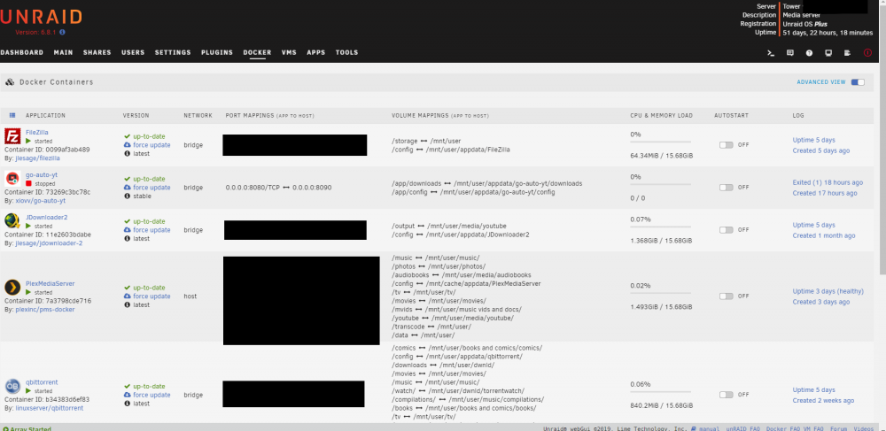

Step 1
go to the docker tab in the unraid gui.
should look like this.

Well now you have docker set up and its time to add a "container" or application or what ever you want to call it.
I will start with plex media server as quite a few people use it I assume
Click the big green add button Screen%20Shot%202015-01-16%20at%207.38.13%20PM.png
you should see a window that pops up that looks like this.
press select a template and scroll down to plex media server and select it.

This step is easy, just click apply at the bottom and let everything install.
Now after it says it completed just close the window and it should look like this, minus all the other apps I have installed.
