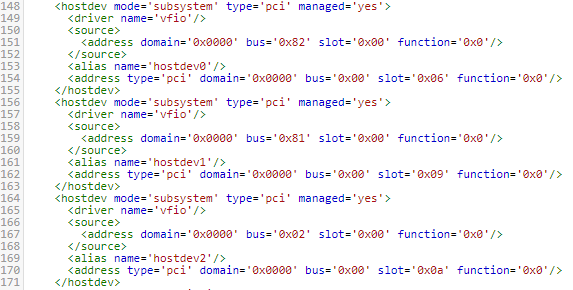

i tried this in my XML but i think this is wrong :D
      <driver name='vfio'/>
      <source>
        <address domain='0x0000' bus='0x04' slot='0x00' function='0x0'/>
      </source>
    </hostdev>
      <source>
        <address domain='0x0000' bus='0x05' slot='0x04' function='0x0'/>
      </source>
    </hostdev>

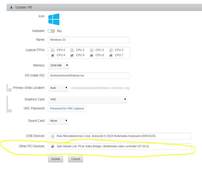

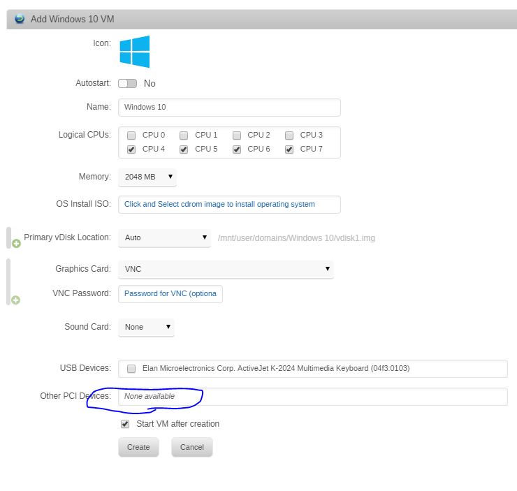

Hi i wonder could you help me,
I'm attempting to pass through a DVBSky T9580 PCIe card with no joy.
So when setting up VM, you can see PCI is not available.
I do as suggested, find the bus vendor id etc, then modify the XML
So original xml will be changed from this;

and will be edited to;
      <source>
        <address domain='0x0000' bus='0x07' slot='0x00' function='0x0'/>
      </source>
    </hostdev>
Modify my XML now,

And when i go back to edit, you can see the pci card available.

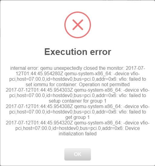

Now when i select Update then run VM, i get this prompt
And if i got back to the edit XML, the code has changed;

You should stub the device in the syslinux.cfg. Then it shows up in the other devices list and will not dissappear when you reboot your server.
Is the card in its own iommu group?

Hi, I have had a read through your post.
As  @saarg says it is best to stub the device in the syslinux config. You will be able to edit the syslinux file from the main tab. Click main then flash. About half way down you will see
the following
default menu.c32
menu title Lime Technology, Inc.
prompt 0
timeout 50
label unRAID OS
  menu default
  kernel /bzimage
  append  initrd=/bzroot
label unRAID OS GUI Mode
  kernel /bzimage
  append initrd=/bzroot,/bzroot-gui
label unRAID OS Safe Mode (no plugins, no GUI)
  kernel /bzimage
  append initrd=/bzroot unraidsafemode
label unRAID OS GUI Safe Mode (no plugins)
  kernel /bzimage
  append initrd=/bzroot,/bzroot-gui unraidsafemode
label Memtest86+
  kernel /memtest

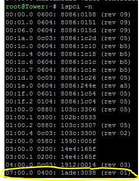

you need to add your device to be stubbed/isolated your device id is 1ade:3038
So we add this to the syslinux config
vfio-pci.ids=1ade:3038
so syslinux should look like this
default menu.c32
prompt 0
timeout 50
label unRAID OS
  menu default
  kernel /bzimage
  append  vfio-pci.ids=1ade:3038 initrd=/bzroot
  kernel /bzimage
  kernel /bzimage
  kernel /bzimage
label Memtest86+
  kernel /memtest
If you have enabled acs override then the above syslinux will already have extra into it so you would add it after
append pcie_acs_override=downstream  vfio-pci.ids=1ade:3038 initrd=/bzroot
After stubbing a reboot is required
But
I think your problem is due to the iommu groups. Please check the iommu group (group one your card is in) has only itself in that group.
Please post the iommu groups here
If other devices are present you will need to try and split them up. And if you haven't already you can try enabling the acs override I mentioned above.
For this, go to settings, vm manager,  (toggle Advanced view) then for,  Enable PCIe ACS Override: select  Yes
Then reboot the server and see if the device is now in its own iommu group.
Best of luck and please report back :)

9 minutes ago, dharrah said:
Thanks 1812. Group 21 only has the one device. However, I followed your link to 'HP Proliant & unRaid Information Thread' and started going through your steps just to see if anything would help. I am embarrassed to admit that I didn't go to the system log during all this testing, but right at the bottom after trying to dupe the problem I found this little gem
No interrupt remapping support.  Use the module param "allow_unsafe_interrupts" to enable VFIO IOMMU support on this platform
So I've added the following snippet
vfio_iommu_type1.allow_unsafe_interrupts=1
to my syslinux.cfg file and am rebooting.
I'll post my logs if this still doesn't work.
That should fix thta problem. Hopefully there won't be more!
That was it! Thanks again. It was the kick in the pants I needed
I saw it was on a Dell, and while I have unRaid on a couple older Dells, I didn't do any passthrough so I wasn't aware that it appears some do not support interrupt remapping. I'll have to file that one away in the brain somewhere for future use.
Have fun playing around!

Had to rebuild a Win10 VM and trying to figure out why my USB 3.0 controller card (click here for specs) is not working.
Here is the USB Card that VM doesn't see, as well as the video card that it DOES see:
Here is a Hauppauge Colossus that is working fine:
Here is the XML where I have attempted to make the changes recommended in this thread:
What am I not seeing?
unraid-diagnostics-20171113-1125.zip

Is there an ETA for getting non-GPU devices selectable (or at least IOMMU groups)?
There is already support for it. All you have to do is stub them.
When I am in the GUI for VM creation I can't select any of my PCIe devices (USB show up fine). I have to manually "virsh edit <vm_name>" and manually add the device/function assignments. Not the worst thing in the world. Am I doing something wrong? I am also on the free trial at the moment, kicking the tires.
You need to stub them before they appear in the list.
Install the VFIO PCI Config plugin and stub the devices there. You can also append the ID to the syslinux.conf file, but the plugin is probably easier.
Cool! That subbed it correctly.
