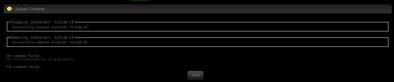

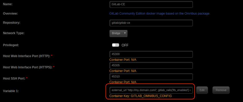

Hi
I'm trying to pass in a variable which contains a ';' in the value (it's a convention when using the official GitLab docker and you want to change some configuration key/value pairs: http://docs.gitlab.com/omnibus/docker/)
However i encounter an issue as soon as i click "Add Container" or try to update the container with this particular variable.
Variable name: GITLAB_OMNIBUS_CONFIG
Variable value: external_url 'http://my.domain.com/'; gitlab_rails['lfs_enabled'] = true;
I also tried adding it directly into the "Extra Parameters" like this:
--env GITLAB_OMNIBUS_CONFIG="external_url 'http://my.domain.com/'; gitlab_rails['lfs_enabled'] = true;"
but i still get the same error:
The command failed.
sh: /usr/local/emhttp: Is a directory
Attached some screenshots as well

Does the same thing happen if you run the command in command line?
Just go edit the container, remove the problem variable and hit save. Then you will have the docker run command in the last command box. Copy it and ssh into your server and issue the command with the added problem variable. If that works, use the full path from /usr/local/emhttp/etc... and see if that works. If not, it's a bug in dockerman.
Ok i tried both things, this is the result:
docker run (works fine):
root@unRAID:/mnt/user/appdata# docker run -d --name="GitLab-CE" --net="bridge" -e TZ="Europe/Paris" -e HOST_OS="unRAID" -p 45300:80/tcp -p 45305:443/tcp -p 45310:22/tcp -v "/mnt/cache/appdata/gitlab-ce/config":"/etc/gitlab":rw -v "/mnt/cache/appdata/gitlab-ce/data":"/var/opt/gitlab":rw -v "/mnt/cache/appdata/gitlab-ce/log":"/var/log/gitlab":rw --env GITLAB_OMNIBUS_CONFIG="external_url 'http://my.domain.com/'; gitlab_rails['lfs_enabled'] = true;" gitlab/gitlab-ce
724e403bc962631a9aa773d24f8657055f6d18f6db854a38794916e4bcf7680e
docker run full path (works fine):
root@unRAID:/mnt/user/appdata# /usr/local/emhttp/plugins/dynamix.docker.manager/scripts/docker run -d --name="GitLab-CE" --net="bridge" -e TZ="Europe/Paris" -e HOST_OS="unRAID" -p 45300:80/tcp -p 45305:443/tcp -p 45310:22/tcp -v "/mnt/cache/appdata/gitlab-ce/config":"/etc/gitlab":rw -v "/mnt/cache/appdata/gitlab-ce/data":"/var/opt/gitlab":rw -v "/mnt/cache/appdata/gitlab-ce/log":"/var/log/gitlab":rw --env GITLAB_OMNIBUS_CONFIG="external_url 'http://my.domain.com/'; gitlab_rails['lfs_enabled'] = true;" gitlab/gitlab-ce
7b3c680e8609383b4d28d9f134d4735c162acfd6a1811e5ca0dcbe5ba8c9604b
So it must be something in the WebUI i suppose?

Looks like a webgui bug then. You should file a defect report so it gets picked up.
