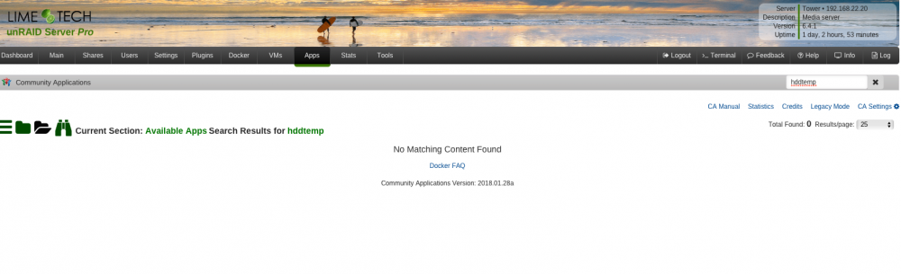

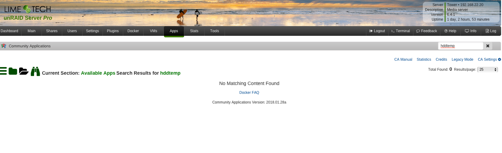

anyone know why I'd be missing the "Get more results from Docker Hub" if an app is missing?  I'm working on a Grafana dashboard, and in searching the apps section for hddtemp, I'm supposed to see  a whale with get more results, but I don't.

Go to CA settings in top right and enable dockerHub search results
that was it, thanks!

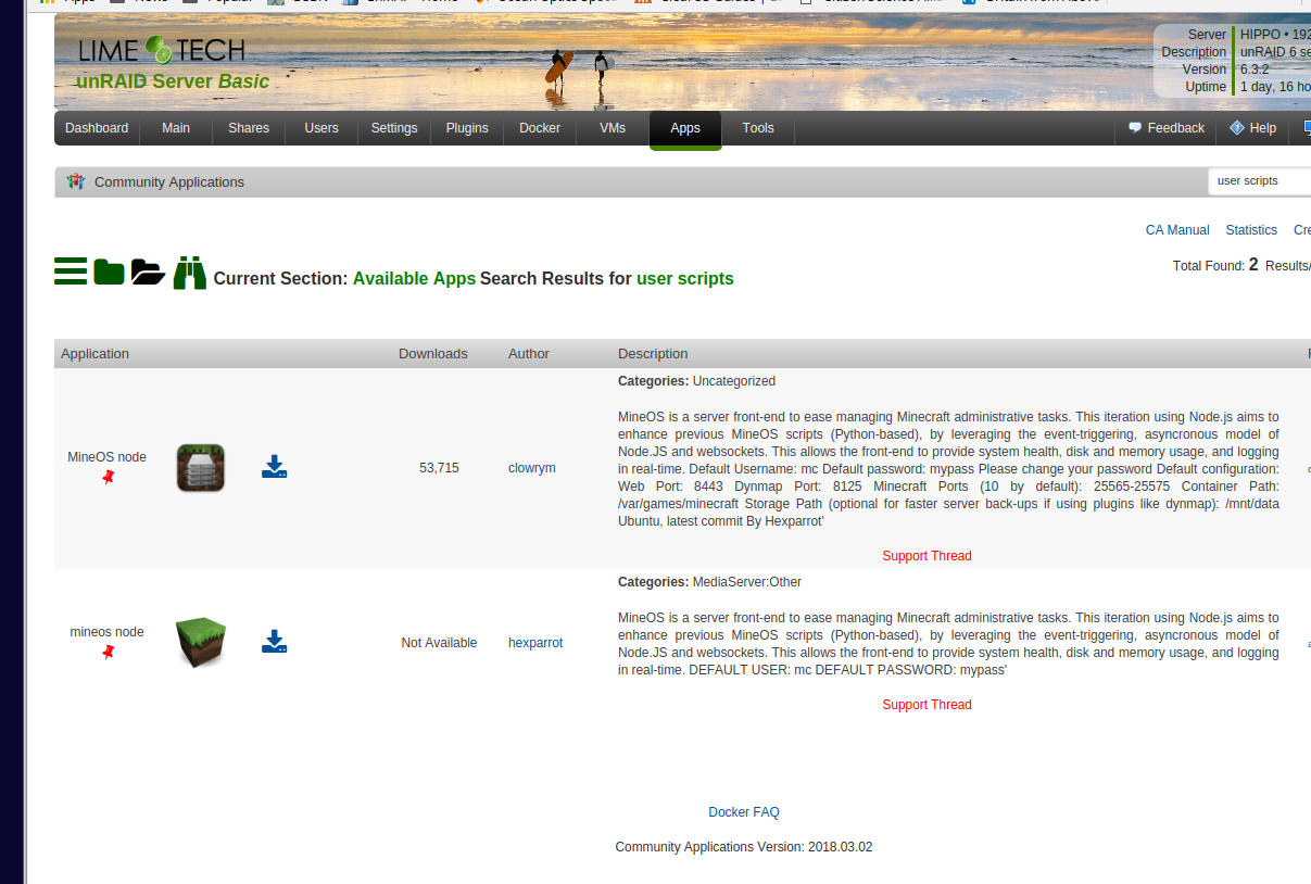

Apologies if this is off-topic, but I can't find a general CA support thread. I've installed several CA plugins in unRAID 6.3.2 (e.g. Backup 2, Fix Common Problems)  but can't find CA User Scripts. Searching just brings up two scripts: MineOS node and mineos node. I've trawled through lots of forum posts with no success. Can someone point me to the right place to install this please? It sounds like a really useful plugin! My CA plugin is up to date (2018.03.02).
Because you're running 6.3.2 and the minimum OS version for user scripts is 6.3.3  (BTW, the latest stable version of unRaid is 6.4.1)
Thanks Squid, I'll update to 6.4.1 as soon as I can.

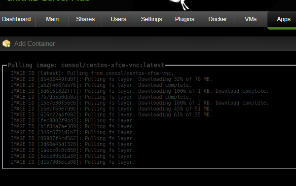

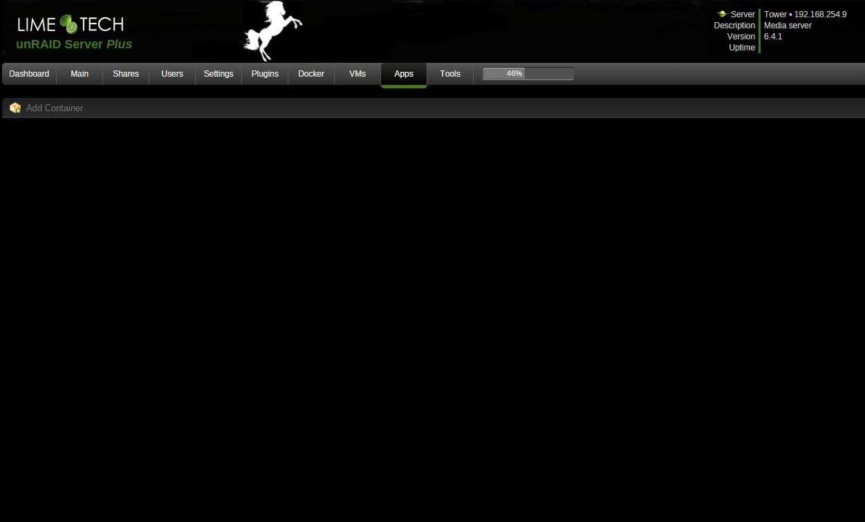

I've been looking for the answer to an issue with no luck, so I guess its time to ask.
A few days ago, during a docker install using CA, my internet went down.  I didn't realize it at first until I saw that the screen wasn't updating install progress.  I gave things way longer than necessary to actually complete or fail, but the screen never updated, and I ended up going to a new tab, then back to apps (once my internet was back.)
Just to make sure things were clean I used cleanup appdata and sure enough, there was an 'orphan' there.  I removed it and assumed all was ready to try again.  Unfortunately, ever since then, something has gone sideways.  Doing docker installs does work, but the screen doesn't update properly, though eventually screen updates do occur.  It can take 2 to 3 minutes before anything appears on screen (showing completed layers, and layers in progress) at which point there are again no updates for a few minutes.  Its frustrating when it seems that a tiny layer is just NOT downloading.  I have been forcing myself to just walk away and not look at the screen until the docker install is done, and the screen shows that it is so.
I have rebooted, cleaned up appdata (as mentioned) and even used the programmers prayer (finger crossing) but am unsure how to get screen updates working as they should again.   (hmm, though it just popped in to my head it might be a good idea to reboot my windows box too.. Perhaps its on my side, rather than server side. Will try that next)
Any and all suggestions welcome, and I'll post an update here if I get it working (or if I don't)  Oh, and I have a second unraid that I fired up and it does properly update the screen during docker installs, so there is that.
EDIT: Nope, restarting my machine had no affect.   Doing an install now, and still waiting for the initial screen update.
post your diagnostics showing this.
First diagnostic is during a docker add.
tower-diagnostics-20180309-1014.zip
As i'm typing this, the screen still shows this..
The screen has now updated once so I've added another diagnostic post update.
Its currently stuck and non-updating at the following screen.
Updates do seem to be coming a bit faster since the server and windows reboot, but its not even remotely comparable to what it was before this started happening.
(it has updated once more now, no need to add another pic, you get the gist.   Once its done I'll post a final diagnostic.)   I have a feeling that I've shot myself in the foot some way, I just don't know how.
Still downloading (slow connection, around 4Mbps at the best of times.)
Ok, done, and noticed that the last 4 digits of the first two diagnistics are the same.  If this is a time tag, does it indicate nothing changed at all in the diags, or that it was less than a minute since the last one? (did I mention its running a little better?)
