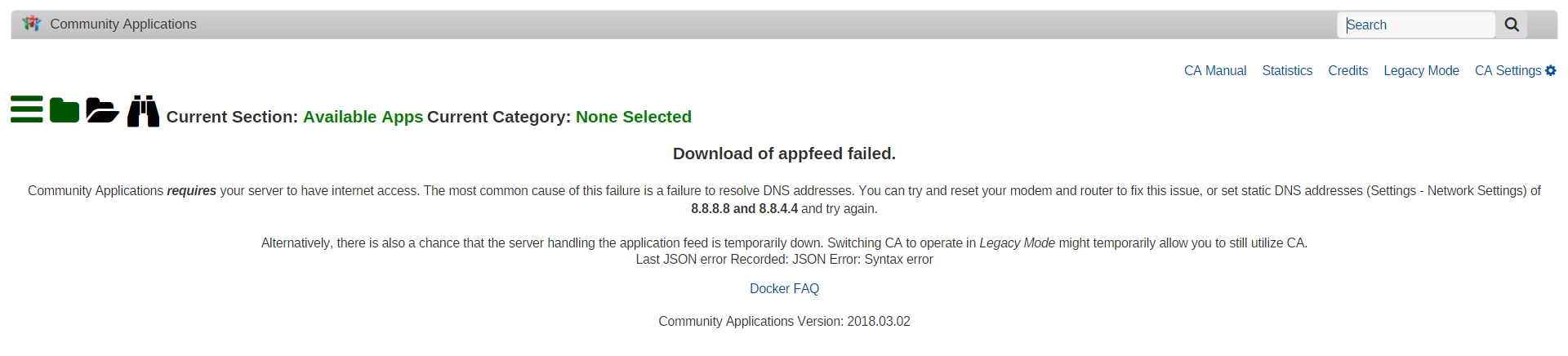

I'm suddenly having connection problems with my CA plugin on my Unraid server.  When I click on the Apps menu button, the system hangs for a minute or so before producing the following error:
Download of appfeed failed.
Community Applications requires your server to have internet access. The most common cause of this failure is a failure to resolve DNS addresses. You can try and reset your modem and router to fix this issue, or set static DNS addresses (Settings - Network Settings) of 8.8.8.8 and 8.8.4.4 and try again.
Alternatively, there is also a chance that the server handling the application feed is temporarily down. Switching CA to operate in Legacy Mode might temporarily allow you to still utilize CA.
Last JSON error Recorded: JSON Error: Syntax error

The server is connected to the Internet and can access its resources, so the first suggestion is not the cause of the problem.  It might the access to the application servers but I can't imagine this being the case.  I've already tried a deinstall / reinstall but same symptoms are occuring.  How should I go about debugging this problem?

Hi. Download of appfeed failed. I also tried in Legacy Mode. No difference. The Server is on the internet.
Is there something i'm doing wrong?
Try setting static DNS addresses in Settings - Network
