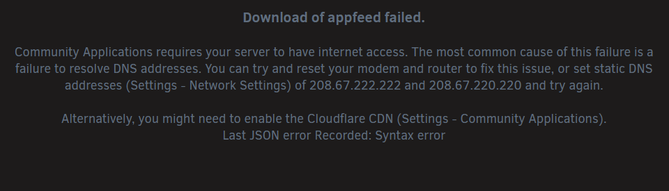

Just upgraded to 6.5, and updated the CA app to 2018.03.14 version, and I am getting "Download of applied failed" but if I switch to Legacy Mode, everything works peachy keen. My problem, or something outside of my orbit?
Outside of both of ours.  Outage started ~an hour ago.  I usually wait a couple of hours to see if the appFeed fixes itself before I bug the guys who host it.
And that's why Legacy Mode exists  :D

There's currently an issue that affects a minority of users and the docker tab,dashboard, and apps tab. If you're affected you'll see nginx timeouts in your syslog.
Upgrading to the latest "next" version of unRaid should hopefully fix
1 hour ago, saarg said:
Our host has some problems with their block storage and I guess the app feed is stored there.
http://status.digitalocean.com/incidents/8sk3mbgp6jgl
Upshot is that the rare outages let me find out minor issues (mainly PHP warnings) that happen in this circumstance and fix them
