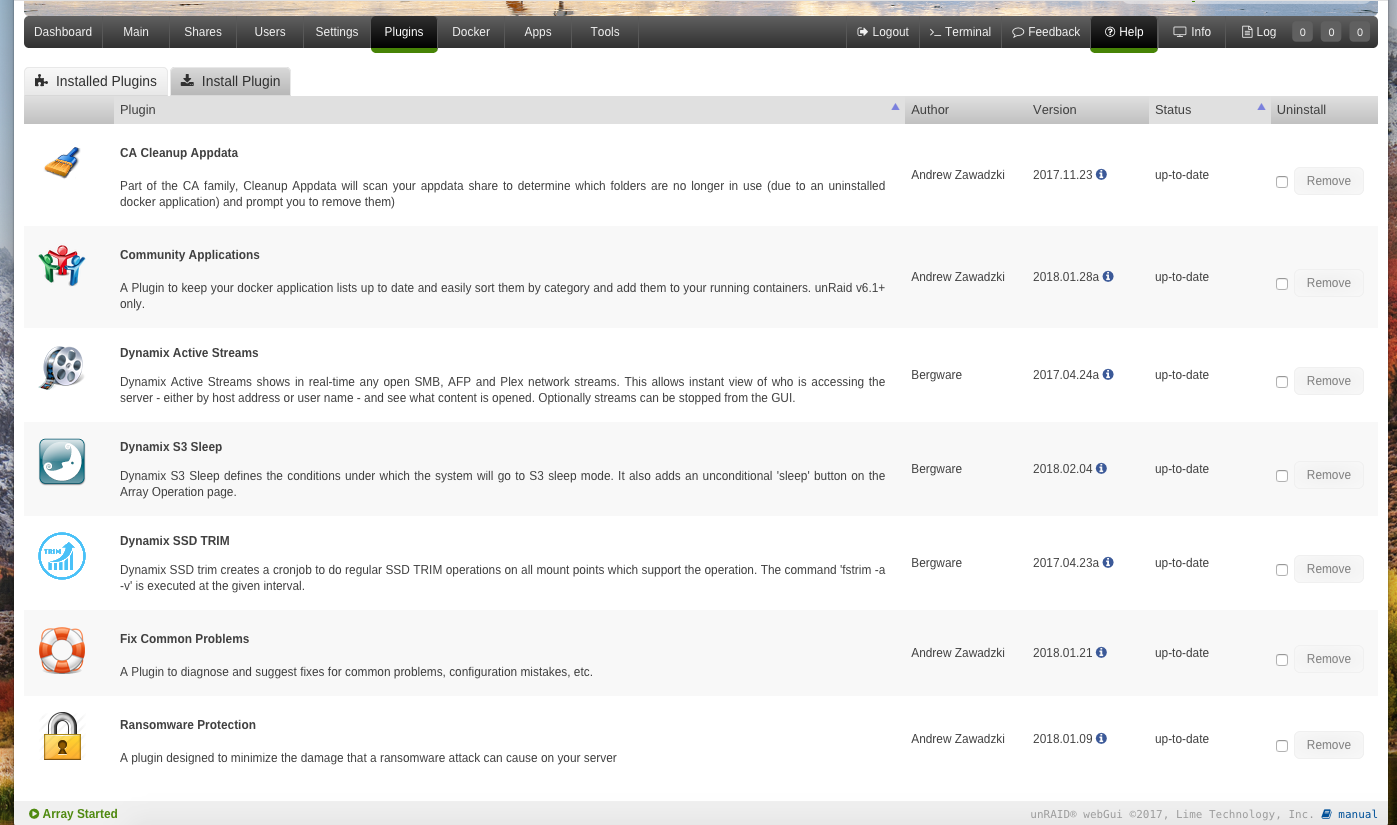

I can no longer see Limetechs Unraid icon under the plugins ... I noticed it when I went to see if there were any updates like I normally do. Can anyone help me with this? Thanks
Tools->Update OS
Tools - About - Update OS
