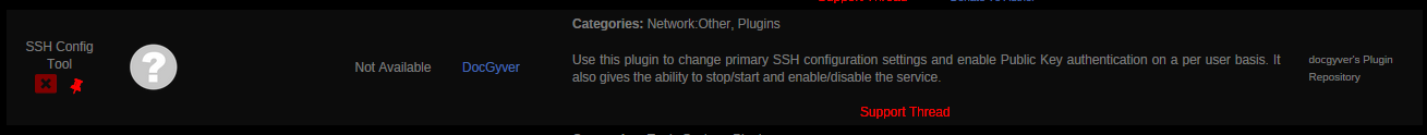

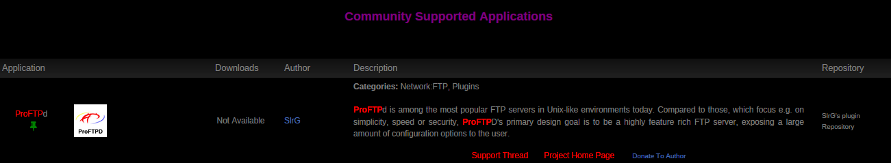

I ran the Update Assistant (which I believe is a part of CA and/or written by @Squid), and it gave me this somewhat amusing feedback:
Current unRaid Version: 6.5.0 Upgrade unRaid Version: 6.5.1
Checking for plugin updates
OK: All plugins up to date
Checking for plugin compatibility
Issue Found: ProFTPd.plg () is not known to Community Applications. Compatibility for this plugin CANNOT be determined and it may cause you issues.
Issue Found: ssh.plg () is not known to Community Applications. Compatibility for this plugin CANNOT be determined and it may cause you issues.
OK: All plugins are compatible
I find it amusing since I installed ProFTPd through CA just a couple of weeks ago, and
Also, the ssh.plg appears to be this one:
Which was also installed via CA.
Are there any actual known errors with these 2 plugins in 6.5.1 or is there a glitch in the matrix script? I'm currently running both under 6.5.0 and having no issues.
Thought I'd check before I pulled the trigger.
No issues with the .plgs that I'm aware of.  The issue with both of them is that the url specified in the template doesn't match the URL specified in the plugin.  I can work around that.
