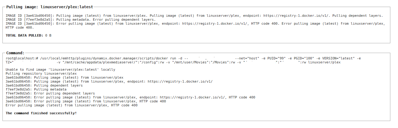

Still getting the error today 3/24 @ 10:33AM PST.
IMAGE ID [3ae61bd06450]: Pulling image (latest) from linuxserver/plex. Pulling image (latest) from linuxserver/plex, endpoint: https://registry-1.docker.io/v1/. Pulling dependent layers.
IMAGE ID [f7eef3e8d2a5]: Pulling metadata. Error pulling dependent layers.
IMAGE ID [3ae61bd06450]: Error pulling image (latest) from linuxserver/plex, endpoint: https://registry-1.docker.io/v1/, HTTP code 400. Error pulling image (latest) from linuxserver/plex, HTTP code 400.
TOTAL DATA PULLED: 0 B
Then

I can't reproduce this using VERSION = latest or VERSION = plexpass
So can only assume it was a transient issue.
Have tried multiple times now and nothing--wondering if I should try another plex docker?
looks to be a docker hub issue to me.
So for the docker novices like myself--not a local unraid/docker config issue but rather a docker linuxserver.io plex specific website issue?  Just want to make sure...
no, a docker hub specific issue...
all the images are stored at the dockerhub.
apparently some of their partners are having issues...
Ugh, still having issues and can't install Plex.

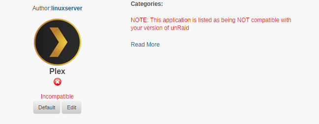

I am seeing this issues when look at "Installed Apps" under Community Applications.
"NOTE: This application is listed as being NOT compatible with your version of unRaid."
How do I correct this without losing any data? Just uninstall and reinstall the docker?
Might be helpful to know what version of Unraid you're using....
Sorry, unRaid v6.1.9

What's the output of
cat /etc/unraid-version
What version of community applications is currently installed?
When you hit Default, on the resulting page (just don't hit create / update and you won't lose anything), there's a URL?  What's the URL?
unRaid version 6.1.9
Community Application version 2016.03.04

update CA

Steps taken:
1. Update Applications - did not work
2. Uninstall/Reinstalled CA, then Update Applications - did not work
3. Stopped Array, rebooted server, updated application - still did not work

Even with the message, there is no problem with the app; CA will let you install when Hide Incompatible Apps is set to no.  (By "did not work", I am assuming the incompatible message is still there -> since I'm not following whatever else is going on here)
But, since I can't replicate this (and no one else is reporting a similar issue), I need to know what the output is of
And additionally, when you hit "Default" on the container, the browser URL is going to display a path to the template.  (Something like http://server_a/AddContainer?xmlTemplate=default:/var/lib/docker/unraid/templates-community-apps/221.xml)
Can you also post the output of:
cat whatever the path is in bold above
Able to replicate now....  There's nothing incompatible with the app itself.  The issue here is that you've changed the name of the app from plex to Plex.  I'll pump out an update to CA to address.  Sorry for the inconvenience
