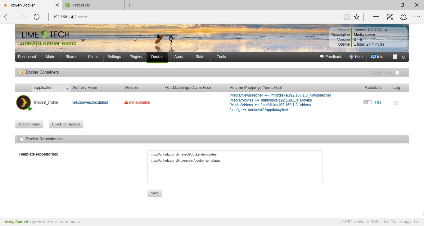

For some reason my application name is now "modest_ritchie" after I downgraded unraid 6.1.9 plex is working but not quite sure what I done wrong.
docker lost track somehow of the name of the app and picked one by itself
Is there a fix? As it no longer detecting version either.
Easiest solution is to delete the docker.img and then recreate it, and re-add your apps via CA's previous apps section.  Since you've downgraded to 6.1.9 from 6.2.x you probably should do this anyways
Sorry to be jumping from 2 threads. Will my plex data be safe if I delete image and container
Yeah.  All the meta data etc is stored within the appdata share (/config)
