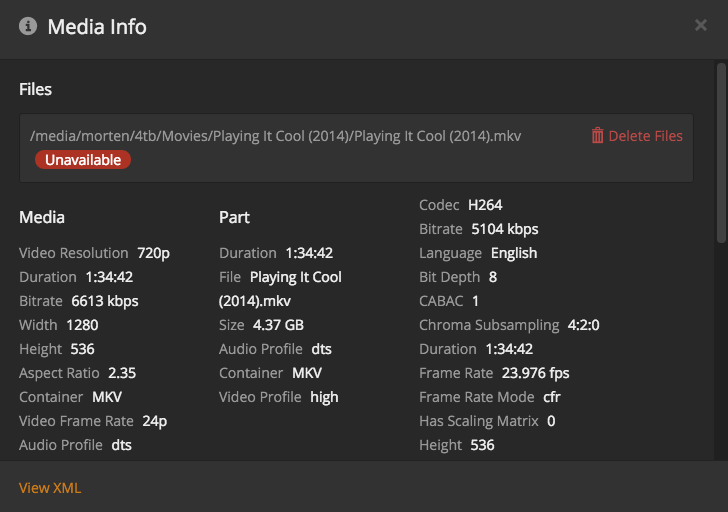

Plex can't find files after update to unraid 6.1.9...
I can see all files fine via MC, and mount names are the same - but plex says files are Unavailable...

What are your volume paths (host and container)?
just in case youre having trouble logging in. plex has been down for a few hours now
FYI if you are having problems with Plex Channels like Comedy Central claiming files don't exist, its a problem with latest version. Fall back to Advanced View | Environmental Variables| and set it to:
VERSION | 0.9.15.5.1712-ba5070a
Check spelling. Remember things are case sensitive.
Spelling is fine I double checked.
To be a bit more verbose, the actual path for my movies and TV shows is all under mnt/user/Media/ and I have folders within Media that are Movies and TV Shows that I point Plex to. I have no problem watching TV shows, but Movies don't even load and I'm stumped.
Are you transcoding to RAM?
Yes I am, however even playback on devices that don't need transcoding doesn't work.
Make it transcode to the cache drive and try again.
Sure enough that did it. Is making it transcode to RAM no longer supported?
Completely missed that, thank you guys very much!
