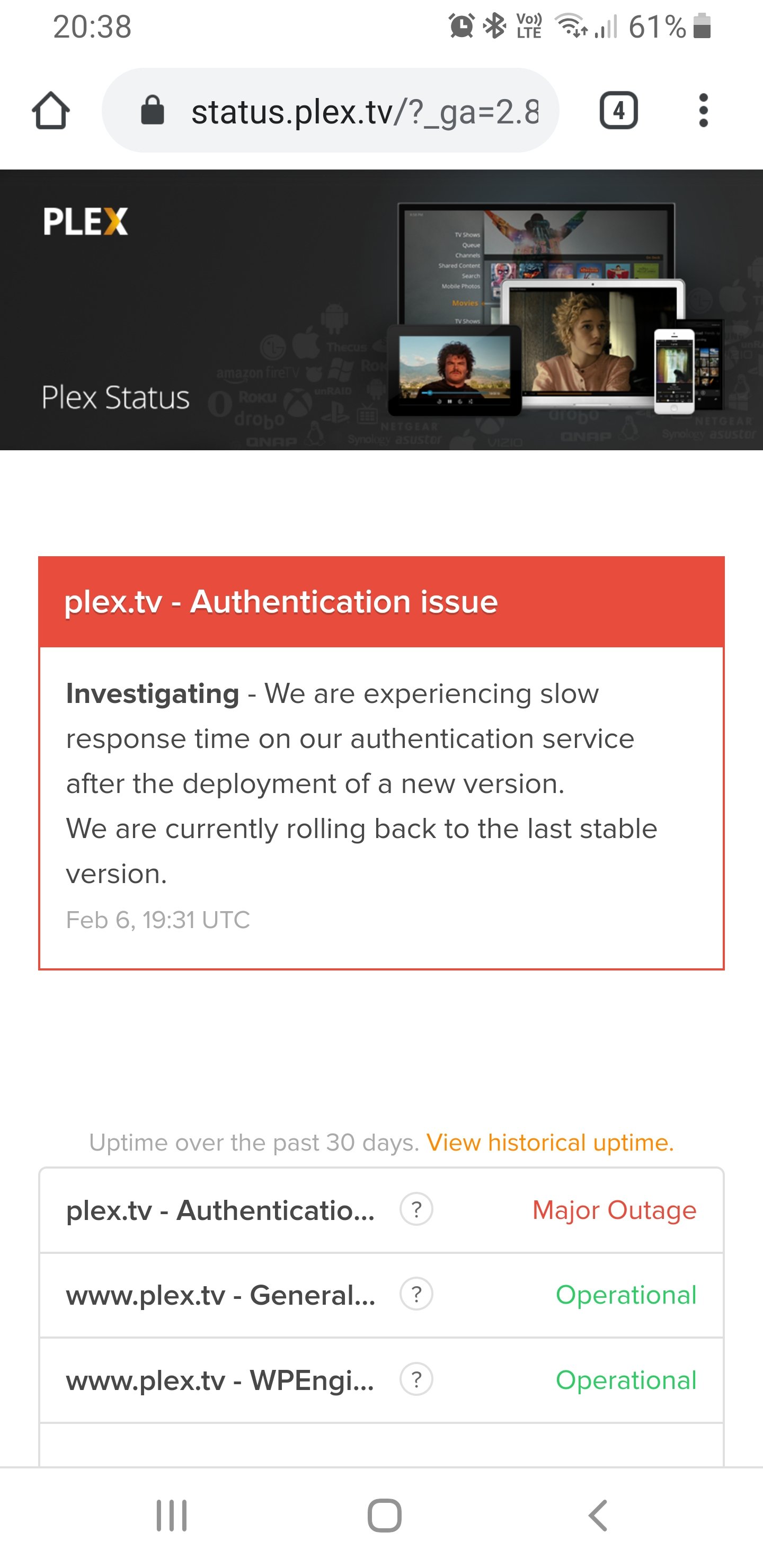

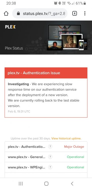

February 6, 20206 yr Not saying its your problem but can't login just now with mine lost remote access as well
February 6, 20206 yr 1 minute ago, coblck said: Not saying its your problem but can't login just now with mine lost remote access as well https://status.plex.tv Plex authentication is down.
February 6, 20206 yr Same here. Getting texts from family "hey your netflix is down" 😂. Hope it's resolved soon.
