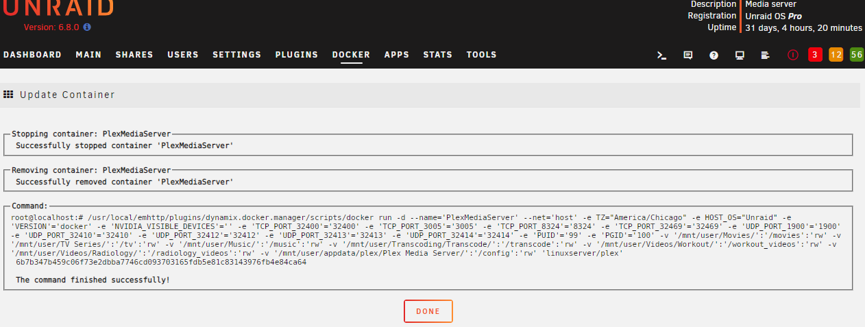

Could you post the docker run command for the Plex container?
I thought I had asked for it before, but am mistaken. I don't see anything suggesting "why" plex is using so much ram yet. It also looks like the plex docker log is not included in this diagnostics zip, unfortunately.
Edited by Xaero
DOH! Was there some specific way I was supposed to get the diagnostics to make sure it was included?
Any tips on getting rid of the bad docker mount?
Here's the screenshot of the run command for plex

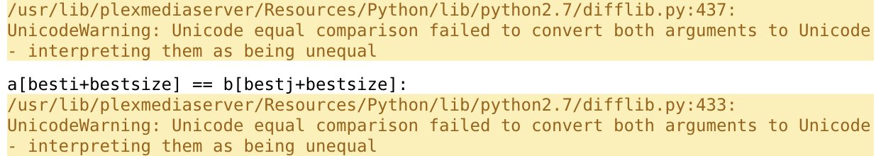

Hello all,
I have been getting the following error when I run metadata match on my movies:
/usr/lib/plexmediaserver/Resources/Python/lib/python2.7/difflib.py:416: UnicodeWarning: Unicode equal comparison failed to convert both arguments to Unicode - interpreting them as being unequal
for j in b2j.get(a, nothing):
/usr/lib/plexmediaserver/Resources/Python/lib/python2.7/difflib.py:437: UnicodeWarning: Unicode equal comparison failed to convert both arguments to Unicode - interpreting them as being unequal
a[besti+bestsize] == b[bestj+bestsize]:
/usr/lib/plexmediaserver/Resources/Python/lib/python2.7/difflib.py:433: UnicodeWarning: Unicode equal comparison failed to convert both arguments to Unicode - interpreting them as being unequal
a[besti-1] == b[bestj-1]:
It seems that refreshing the metadata of my movie collection stops midways. Plex works but the movies themselves seem not to refresh data such as if they have been already played. I have never had that issue before, so I checked my Plex logs and this is the issue that keeps coming up every time I run it. I have to restart Plex docker and my movie library goes back to normal.
I’ve searched for answers but nothing has helped me figured out this issue. Thanks!
2 hours ago, luigi408 said:
Hello all,
That sounds like a plex issue. You should ask them on their forums
Thanks. I have posted it there too.

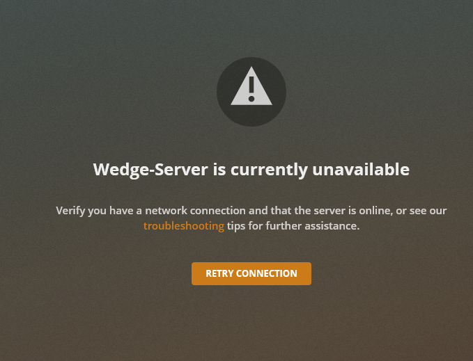

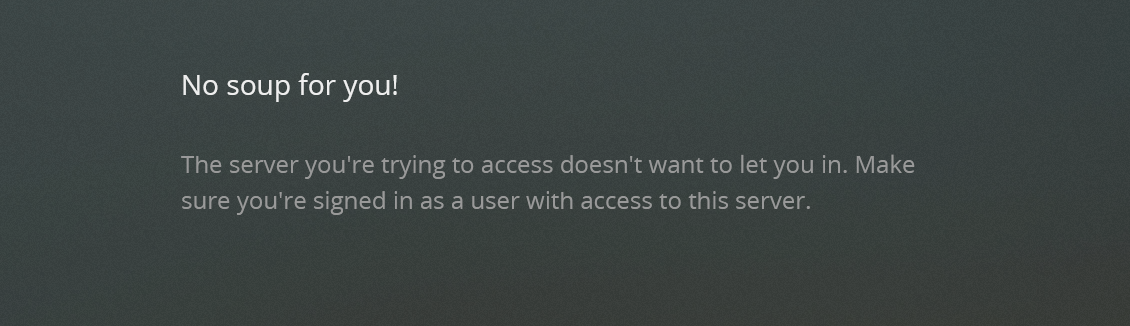

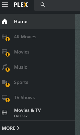

I upgraded to 6.8.2 yesterday and then Plex stopped working, I noticed I had the old depreceated version so I decided to follow the video by Spaceinvaderone and migrate to a newer supported Plex docker from Linuxserver team. I am still having the same issues with the new docker as the old one. I can login to Plex via the webgui, page loads erros for all my folders and shows cannot connect to server. I also tried another new installation without referencing any of the old Docker appdata and I get the "No soup for you error after webgui login".
I am getting EAE errors on my console. No idea what is going on and a lot of folks who had this issue had it in 2017 from some other sort of issue. Running the current versions of everything (6.8.2 Nvidia; current docker; etc.)
Deleted the codecs folder and it started working.

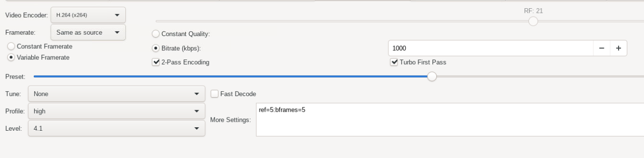

I'm having trouble syncing content to my device for offline use. I tried Xiaomi Mi 8 and Samsung S10+, Both phones can direct play any file i have on the server, but when i try to sync for offline use in ORIGINAL quaility, it keeps converting it.
I tried doing this https://mostlyirrelevant.info/force-plex-to-download-sync-videos-without-transcoding/
But keeps transcoding.
All my files are converted with handbrake with this profile Capture.thumb.PNG.db53d93529d957bb3af2d37440779edd.PNG
I would accept to transcode audio, but not video. It takes a lot of time and cpu power.
i got the exact same problem. Plex will run as it should for like 10min after a full reboot of my unraid server. After the 10min then its dies again.
Anyone there got a fix to this problem?

https://forums.plex.tv/t/unicodewarning-errors-while-updating-library-metadata/545011/8
I asked about this error in the Plex since I’m not the only one having it. No help yet. They don’t see the error in my Plex logs.
Seems like its just you and me at the minute chief. Been at it for 3 days trying to sort it but to no avail. Ive moved to Emby for now. Not as "clean" but at least it works.
