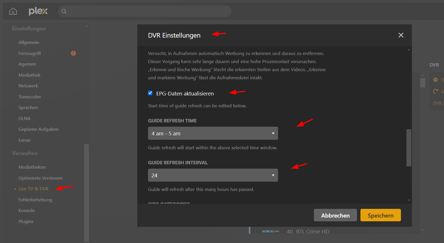

Chester Posted August 22 Share Posted August 22 New Plex user here - with a guide update problem. My setup: HDhomerun - with antenna Apple TV with Plex App Problem: Channels are mapped correctly. However, my channel guide goes blank (no programs shown) and does not update. (Channels can still be tuned) The only way to recover it to manually update the channel guide in the Plex webpage, and force restart the Apple TV plex app. Is there a way to make this automatic, without the manual update? (I'm looking at the DVR subscription, but if the guide requires a manual update, I'll look at Channels DVR.) Am I missing something simple? Thanks! Quote Link to comment
alturismo Posted August 23 Share Posted August 23 4 hours ago, Chester said: Am I missing something simple? Thanks! depending how much guide data is provided ... may increase the DVR refreshes ... but this is rather a plex related question, so may consult the plex forums instead Quote Link to comment
Chester Posted August 26 Share Posted August 26 Thanks so much for responding - my options are slightly different, since I'm not signed up for DVR. I also posted on a Plex forum but didn't get a response. I may just sign up for the paid service for a month or so and see if the guide data is more consistent. Quote Link to comment

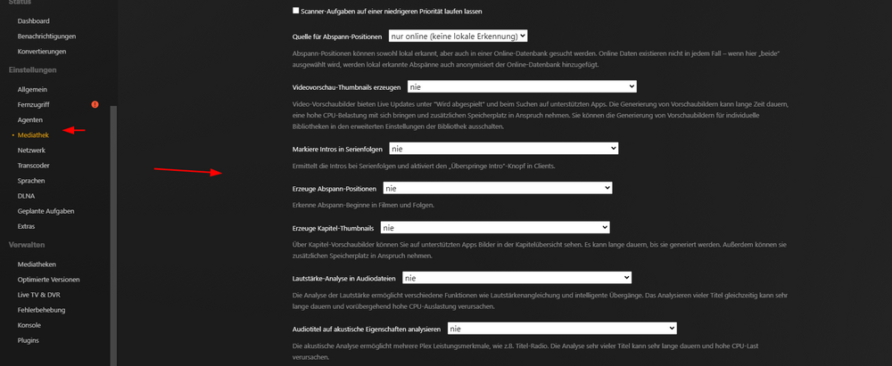

alturismo Posted September 3 Share Posted September 3 23 minutes ago, snowboardjoe said: Starting around late July usage started increasing and slowly starving my cache over time. It seems it's the `/mnt/cache/appdata/plex/Library/Application Support/Plex Media Server/Media` directory that's consuming the space. It's always been large but has remained static or very slow growth over the years. It's now up to 130GB for that one Plex introduced Thumbnails, Chapters, Intro / outtro ... etc ... which is stored there ... and consuming alot of activity always ... may take a look at these settings and decide ... Quote Link to comment

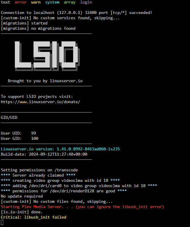

Muff Posted yesterday at 05:34 PM Share Posted yesterday at 05:34 PM Hi, I have this is my Plex docker log: Starting Plex Media Server. . . (you can ignore the libusb_init error) Starting Plex Media Server. . . (you can ignore the libusb_init error) Starting Plex Media Server. . . (you can ignore the libusb_init error) Starting Plex Media Server. . . (you can ignore the libusb_init error) Starting Plex Media Server. . . (you can ignore the libusb_init error) Starting Plex Media Server. . . (you can ignore the libusb_init error) [migrations] started [migrations] no migrations found usermod: no changes ─────────────────────────────────────── ██╗ ███████╗██╗ ██████╗ ██║ ██╔════╝██║██╔═══██╗ ██║ ███████╗██║██║ ██║ ██║ ╚════██║██║██║ ██║ ███████╗███████║██║╚██████╔╝ ╚══════╝╚══════╝╚═╝ ╚═════╝ Brought to you by linuxserver.io ─────────────────────────────────────── To support LSIO projects visit: https://www.linuxserver.io/donate/ ─────────────────────────────────────── GID/UID ─────────────────────────────────────── User UID: 99 User GID: 100 ─────────────────────────────────────── Linuxserver.io version: 1.41.0.8992-8463ad060-ls235 Build-date: 2024-09-12T11:27:40+00:00 ─────────────────────────────────────── **** Server already claimed **** Docker is used for versioning skip update check [custom-init] No custom files found, skipping... Starting Plex Media Server. . . (you can ignore the libusb_init error) [ls.io-init] done. Critical: libusb_init failed And now I can't access my media. Plex says: XXXX is currently unavailable I've restarted the container but it didn't help. Quote Link to comment

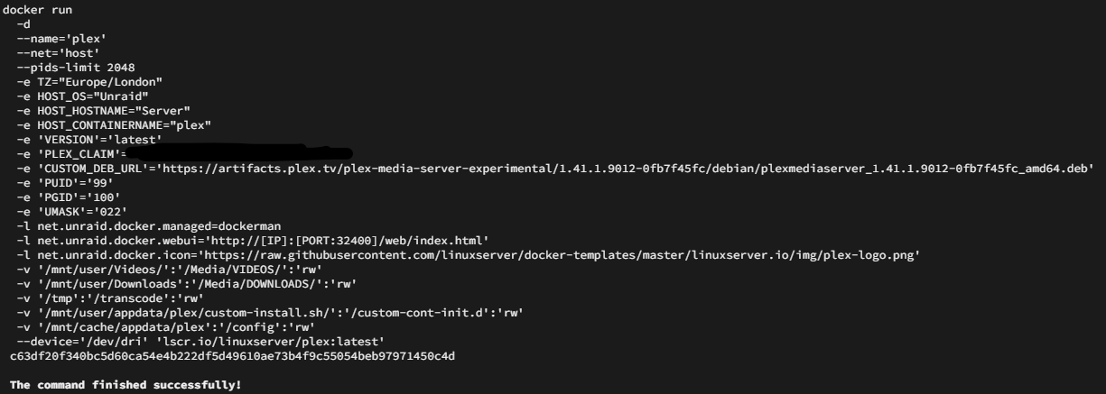

chandz05 Posted yesterday at 06:40 PM Share Posted yesterday at 06:40 PM Hi everyone! I've tried searching the forums but I couldn't find anything that matches my problem. It seems like my LSIO Plex docker container may have a memory leak or something. Whenever I am HW transcoding, the overlay filesystem fills up really fast. I have mapped the transcode directory to a 5GB ramdisk in the /tmp directory, which is working as expecting. I have also limited the Plex container itself to 4GB, but it never goes over 3GB of use anyway. Using the command watch df -h I can see the expected behavior on the transcode ramdisk, which cleans itself up when it hits 50% usage. Monitoring processes via Glances, I don't see anything that's using RAM except the Plex container, which again never goes over 3GB. Despite all of this, only while Plex is HW transcoding, the /lib and /usr directories start filling up and never stop. What could be causing this behavior? See below for df -h output: Every 2.0s: df -h Tower: Fri Sep 13 14:27:58 2024 Filesystem Size Used Avail Use% Mounted on rootfs 16G 16G 0 100% / tmpfs 128M 9.8M 119M 8% /run /dev/sda1 60G 1.1G 59G 2% /boot overlay 16G 16G 0 100% /lib overlay 16G 16G 0 100% /usr devtmpfs 8.0M 0 8.0M 0% /dev tmpfs 16G 0 16G 0% /dev/shm tmpfs 128M 600K 128M 1% /var/log tmpfs 5.0G 2.6G 2.5G 52% /tmp/plex-ramdisk /dev/md1p1 3.7T 3.0T 689G 82% /mnt/disk1 /dev/md2p1 3.7T 3.0T 693G 82% /mnt/disk2 /dev/nvme0n1p1 466G 355G 108G 77% /mnt/cache shfs 7.3T 6.0T 1.4T 82% /mnt/user0 shfs 7.3T 6.0T 1.4T 82% /mnt/user zurg: 1.0P 0 1.0P 0% /mnt/user/Media/debrid /dev/loop2 60G 31G 28G 53% /var/lib/docker /dev/loop3 1.0G 4.7M 904M 1% /etc/libvirt tmpfs 3.2G 0 3.2G 0% /run/user/0 Quote Link to comment
