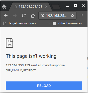

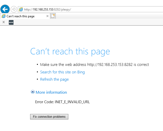

My computer, Chrome incognito mode, gets "ERR_INVALID_REDIRECT"
Another computer, which I rarely use, from a IE, which I almost never use, gets "INET_E_INVALID_URL"
The above is the result of the reply to the wednesday 3:38 post.

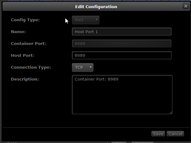

Is there something wrong with the tautilli container template? It seems like its missing the container port?
3 minutes ago, Dimtar said:
Thanks Sparky, normally I don't update through the container but a broken container wouldn't worry me in this case.
not that i'm aware of i don't use plex let alone tautulli but just going through the motions of adding it i can change the host port
you don't want to ever change the container port as a rule anyways
For comparison this is the Sonnar container:
I obviously don't know anything about these things but my guess is the template isn't aware the Tautulli container needs a port?
@CHBMB ^^

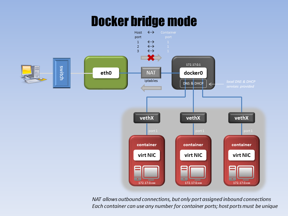

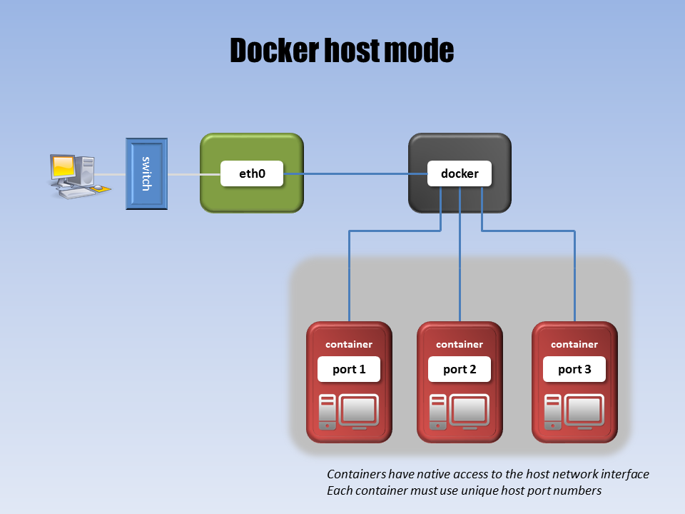

It has nothing to do with the template, but all with the type of network.
A host + container combination is only relevant when the network type is bridge, because here port translation takes place between outer (host) and inner (container) ports.
Any other network type only works with host ports, because host and container port refer to the same thing here.
