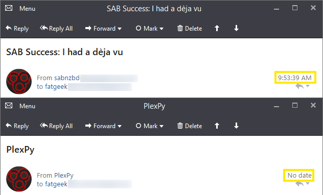

I'm having a weird issue with PlexPy and email notifications. For some reason, my PlexPy email notifications do not have a date and time in them. I have 6 other Dockers that do email notification running on the same server, and none of them have this problem. In the attached image, you can see two test notifications, one from PlexPy and the other from SABnzbd. The SAB one has a correct time stamp and the PlexPy one does not. I don't think this is a mail server or mail client error, since I see it on multiple clients and servers (I've tested with two different mail providers). Any help would be appreciated.

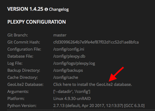

I was wanting to install the Geolite DB into this docker. Is there any special folder magic i need to do, e.g. download DB, put into correct config folder location, restart plexpy docker.
Or is it as simple as hitting the internal download button.
59e4afda42167_ScreenShot2017-10-16at21_09_25.png.0c65c1694d1aef1d2584624cbee6dee7.png
Never mind. I hit the internal download button and it stored the database in my config folder. So far all working.
