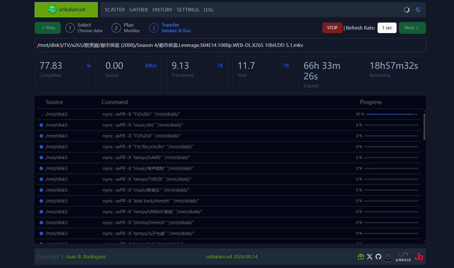

[email protected] Posted August 30 Share Posted August 30 The initial speed was about 120M, but now the speed is almost non-existent. It seems that the previous version did not have this problem. Please forgive my English Quote Link to comment
MAM59 Posted August 30 Share Posted August 30 2 minutes ago, [email protected] said: but now the speed is almost non-existent. Make sure the "to be moved" files are not in use by any other process (known evildoes are "Plex" or something for instance), else rsync will stop and wait for the file to become free again. This wait can last forever... Quote Link to comment
[email protected] Posted August 30 Share Posted August 30 33 minutes ago, MAM59 said: 确保“要移动”的文件没有被任何其他进程使用(例如已知的恶意进程“Plex”或类似进程),否则 rsync 将停止并等待文件再次变为空闲。 这种等待可能会持续永远…… Got it, I'm observing it. Thank you!!!!! Quote Link to comment

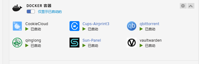

MAM59 Posted August 30 Share Posted August 30 your dockers look still be running? stop them and stop the docker service (and the same for VMs) Speed will not "jump" upward, it may take several minutes to see improvements Quote Link to comment
[email protected] Posted August 30 Share Posted August 30 All have been closed, Quote Link to comment

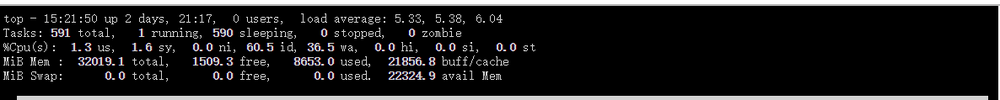

[email protected] Posted August 30 Share Posted August 30 (edited) 我认为这是 WA 太高的问题 Edited August 30 by [email protected] Quote Link to comment

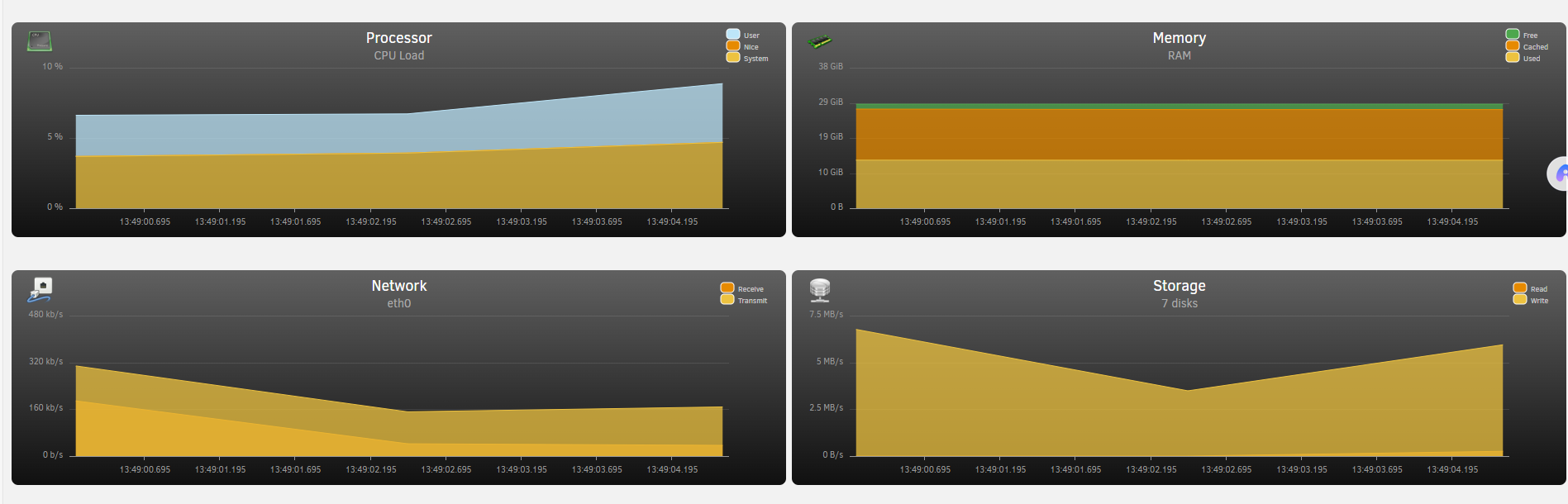

MAM59 Posted August 30 Share Posted August 30 if you run a copy job, its normal, that WA will raise and raise. First the (RAM) Buffers get filled, then Data is written directly to the drives. And because writing will be slow, WA (wait) cycles need to be added more and more. You can pause unbalanced and wait a period. WA should drop to 0 again then. Unpausing will copy fast again first (buffers!) then slow down again more and more. The slower your drives, the faster (and longer) it will happen. Quote Link to comment
[email protected] Posted August 30 Share Posted August 30 The problem is that the issue has not been resolved yet, and it is still slow. The files are being copied, but the time speed is only about 10M. The speed is not good now and it will take a long time Quote Link to comment
jbrodriguez Posted August 30 Author Share Posted August 30 it also depends on your source disks, if they have some hardware issue, copying will also be slow but mostly what mam59 mentioned, if you have other services reading from the source and/or writing to the source/target disks, it will result in a slower operation and unpredictable results, if writing to the same disks involved in the operation Quote Link to comment
