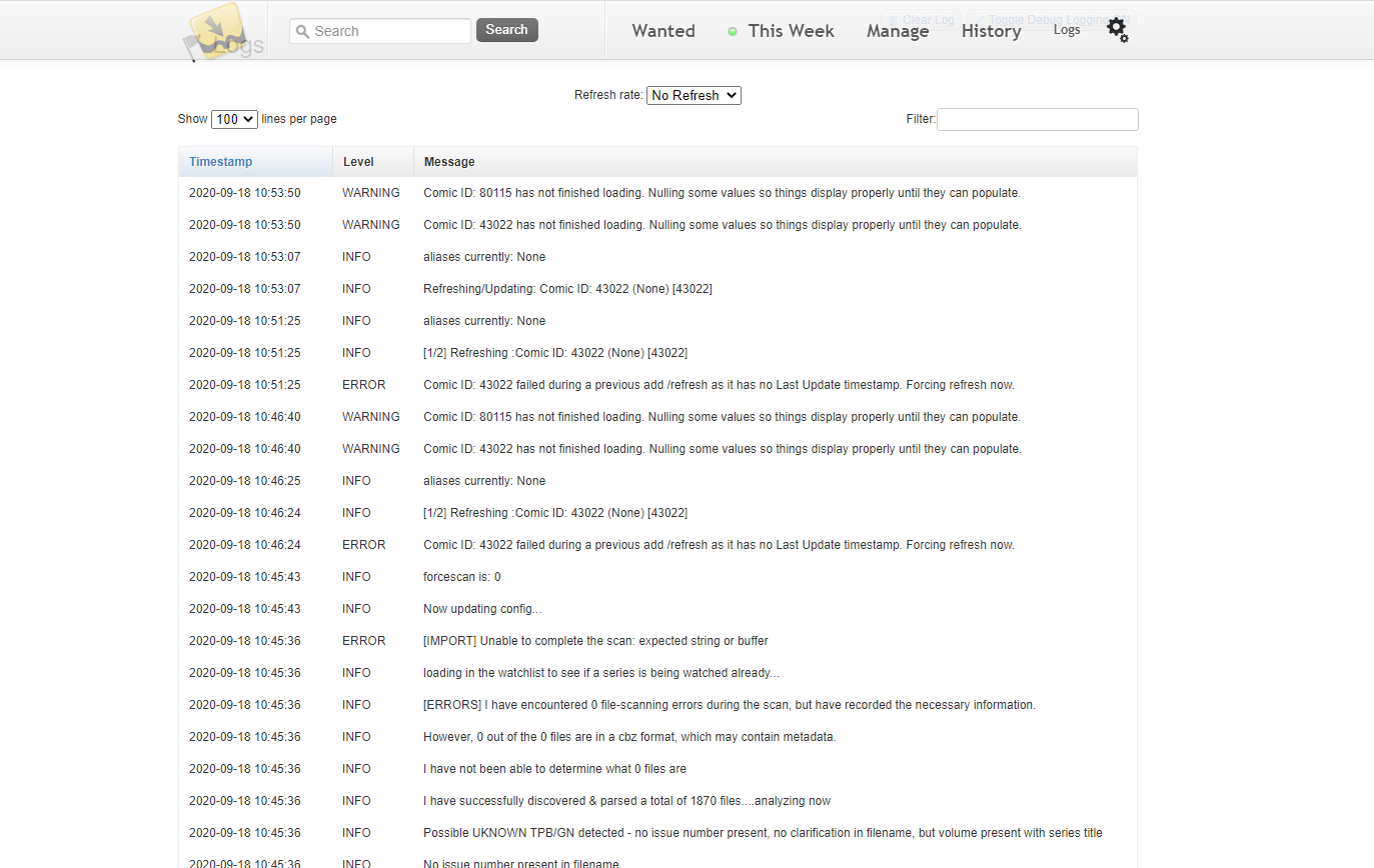

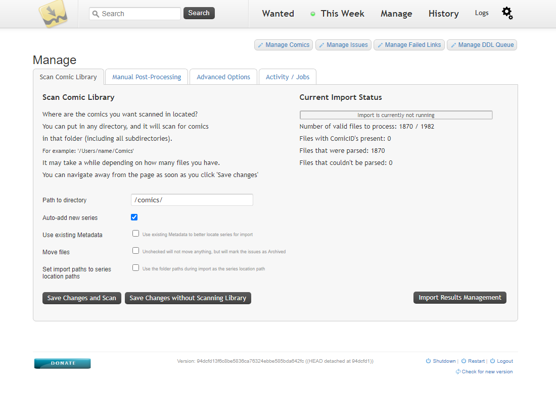

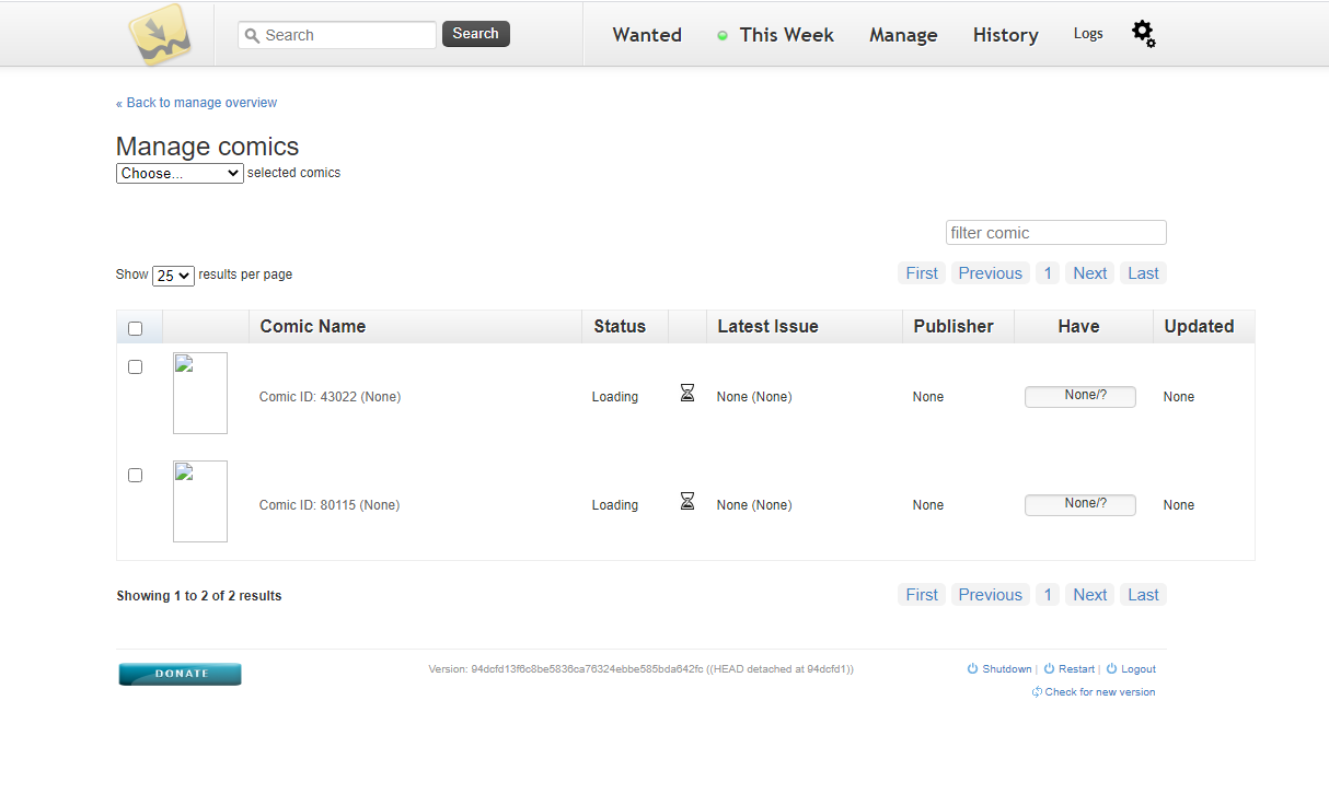

Hello everyone, I am not new to Mylar but new to using it in unraid. I have not touched mylar in years and recently stood up Ubooquity so naturally I needed to get Mylar back up and running, in unraid of course.... LOL. Any help or suggestions would be greatly appreciated.
Mylar is not pulling in my comics. I do not know if its how the file structure is or something wrong I am doing in mylar.
Physically they are stored in folder with in UNRAID, then attached to the container as the host path of /comics
The location where I have my comics is set up like the following attached to the mylar container.
/comics
When I console into mylar I see /comics and it sees all the comics attached.
My files structure is
/comics/publisher/series/
example continued
/comics/DC Comics
/comics/Marvel
/comics/Dark Horse Comics
/comics/IDW Publishing
/comics/Vertigo
/comics/Zenescope Entertainment
Farther down in a screen shot is the structured continued.
After some more exploring, the container for Mylar3 can not reach the internet. This is why its not working
ylar.locg.58 : ThreadPoolExecutor-0_0 : HTTPSConnectionPool(host='walksoftly.itsaninja.party', port=443): Max retries exceeded with url: /newcomics.php?week=39&year=2020 (Caused by NewConnectionError('<urllib3.connection.HTTPSConnection object at 0x1481dab4bdc0>: Failed to establish a new connection: [Errno 110] Operation timed out'))
it is my only container that can not reach the net. Not sure why
