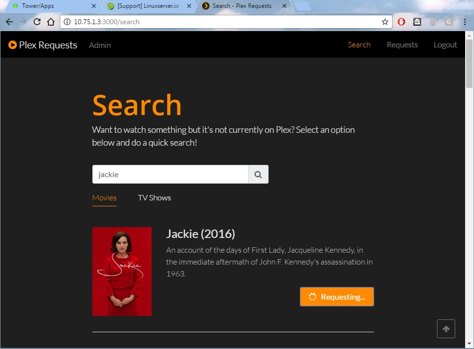

I have everything working but when the request button is clicked, it just says "Requesting" forever and the request is never processed. Any ideas on what I may be doing wrong?
